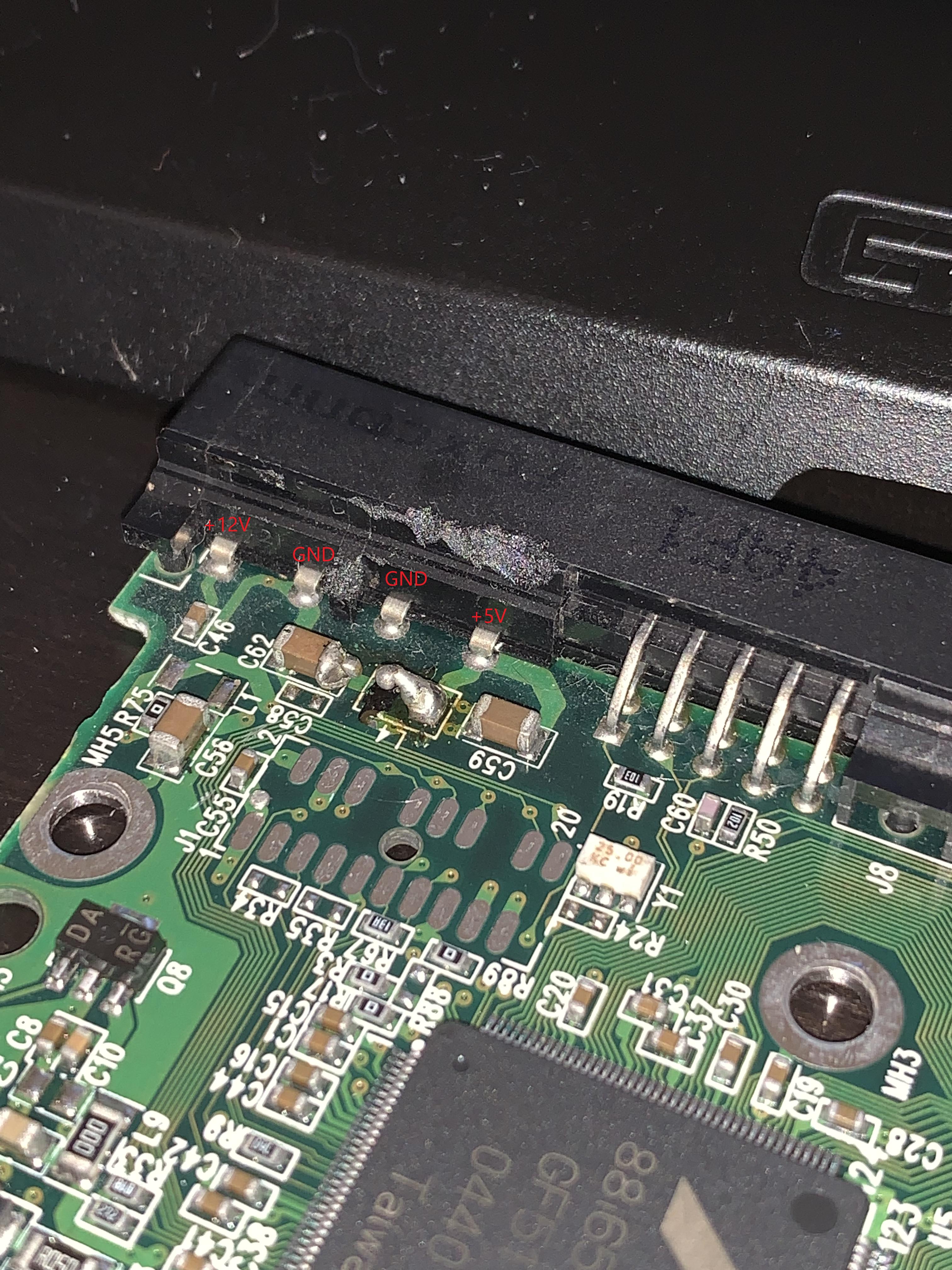

I have a WD800JB-00JJA0. I hooked it up to a faulty external drive enclosure and burnt up something on the PCB. It looks like it’s “L4”. It looks melted. Possibly C62, too. Any idea how I could fix this? Or at least temporarily use it to get the data off?

Sorry, I made the post then kept getting an SQL Error when trying to upload a picture. Here is a picture.

It appears that the failed inductor (L4) is in series with the +5V supply. Therefore I expect there is further damage, possibly to the preamp. :-(
Would this mean I would need to replace the board? Or is the entire drive likely dead?

If the preamp is damaged, you will need to replace the head stack assembly. If it's just the PCB, a PCB swap (and ROM swap) will do the trick.

Thank you. I will try a new PCB with a transferred ROM chip. Do you think it's safe to plug my device in now to a proper connection and see if it spins up or does anything?

I ended up trying to plug it in again. Nothing happened at all. No noise or anything. I'm going to get a replacement board to see if that fixes it.
