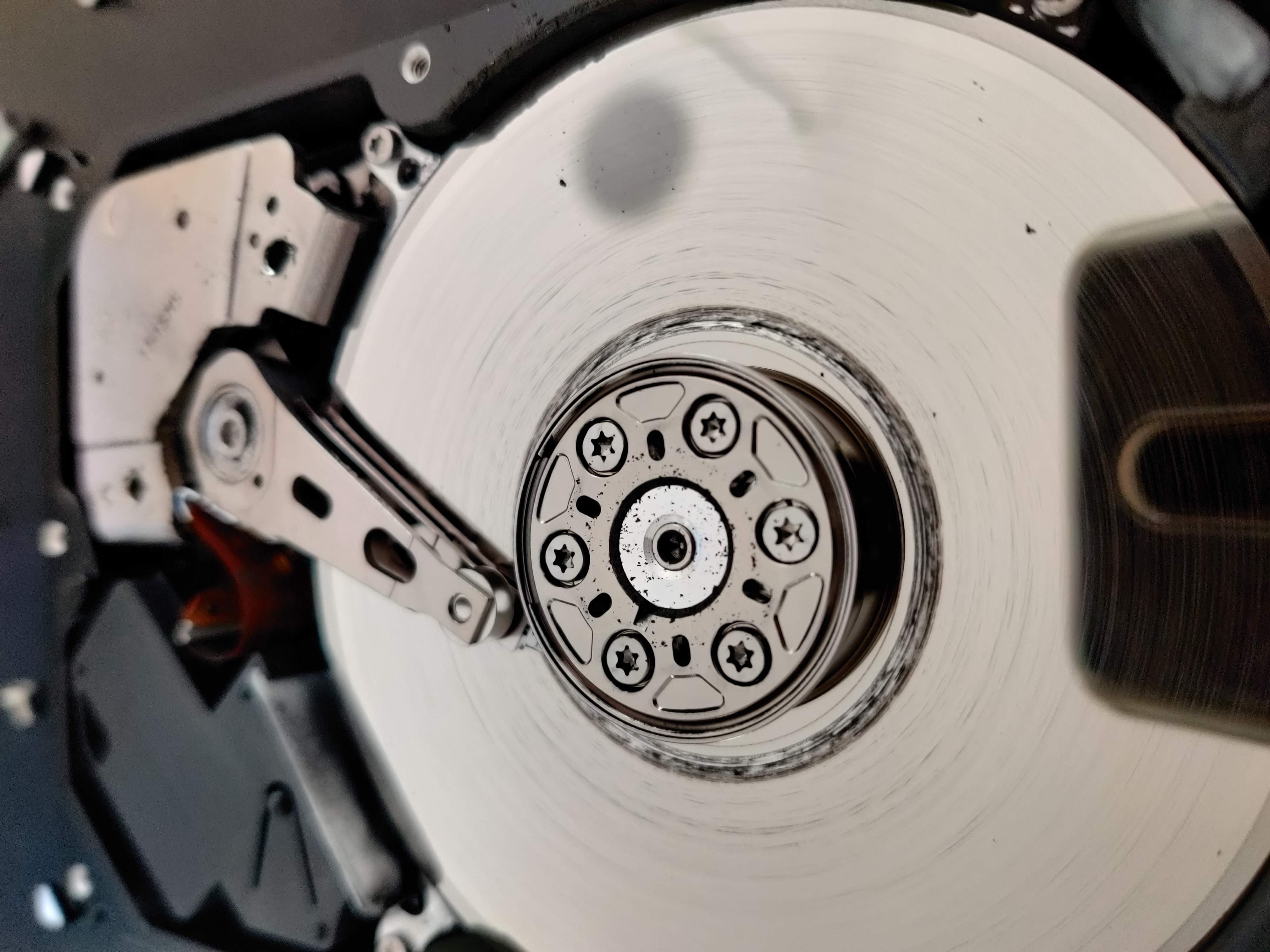

Hi guys, quick update about my disks:
- The good one has been cloned with HDD Raw Copy. I opened the cloned disk with UFS Explorer and have been able to recover some files.
Looks like UFS can only recover the files it sees. Now I'm trying to recover with "Remo recover" but It's taking ages.
- The bad one... I've watched multiple video on how to open it safely...and I did It.
I think It's pretty dead :cry:

i wasn't expecting a clean surface but i had cases where the disk sounded similarly and i got pretty good results after cleaning...
This one is apparently not that type. However, i would be interested how that platter looks like after cleaning it a bit. It is hard to tell by the pic.

It was difficult to move the head out of the scratch. It's pretty deep.
When I stopped the disk, It was running and doing a bad sound.
I finaly had a look at the recovered files (from Remo recover). Most of the files are corrupted.
Is there a "easy" process to remove corrupted files?
For exemple, I have a lot of pictures, the thumbnail seems ok but when you open It, you only get the first 5% of the image.
