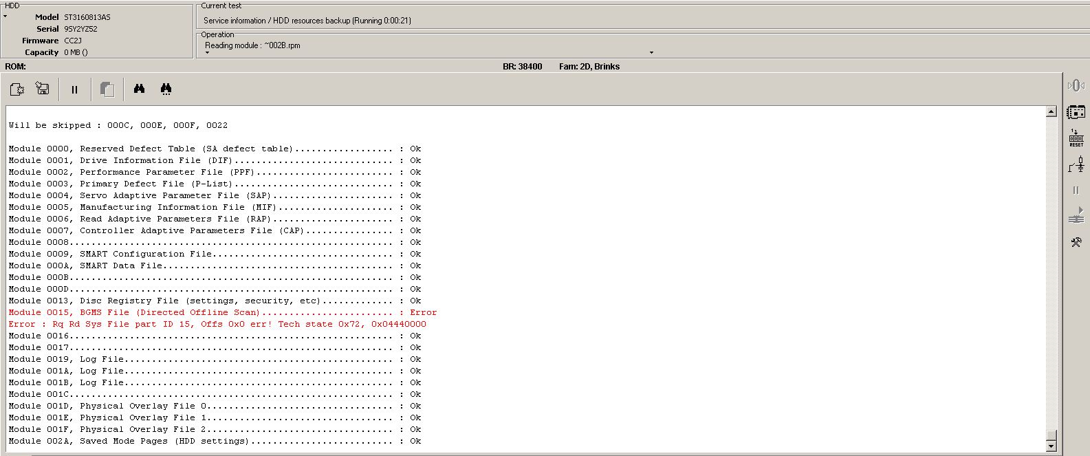

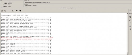

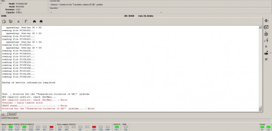

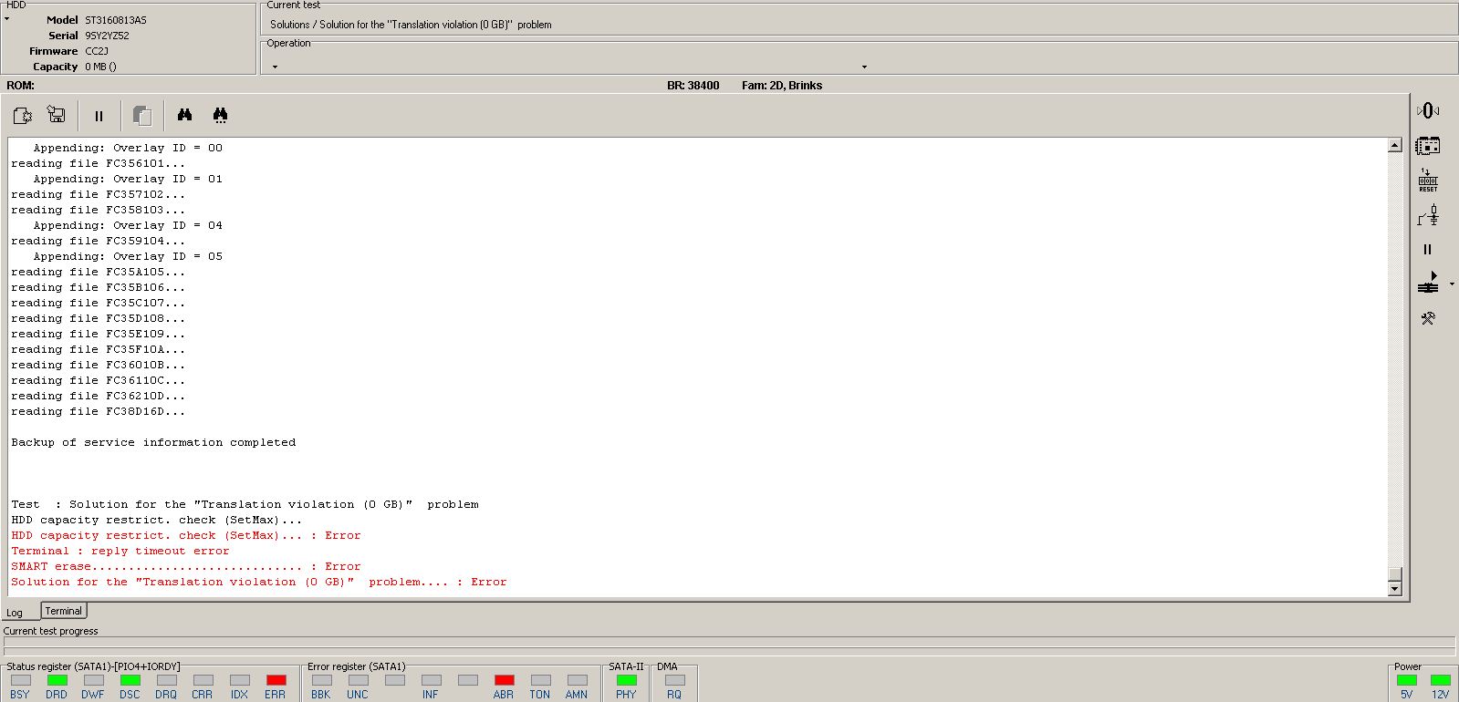

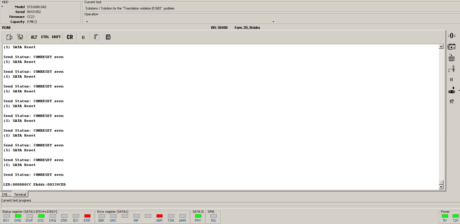

I am working on a old seagate ST3160813AS /CC2J hard disk.
It gets detected in UDMA-E shows correct model /serial /FW but size is 0mb.
I have applied 0mb Translation violation solution but is not working.
How to go ahead now any suggestions pls.

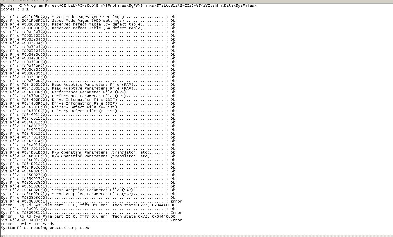

it seems SA has problem, what about sysfile 28 ? can you read it without errors ?
Data Recovery Pakistan

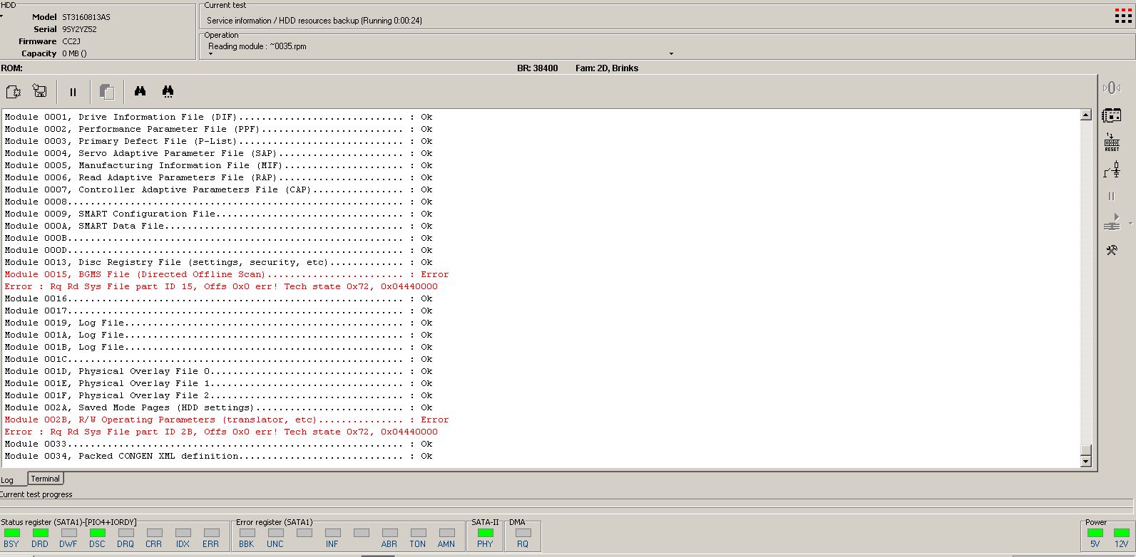

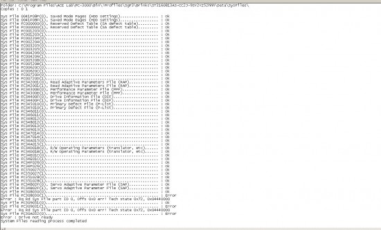

Hi MindMergepk
Yes I could read this file with both Heads ,however I am getting errors while reading files 30 ,31 ,32 onwards

Location: Russia

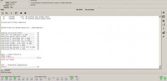

Judging by the screenshots, you regen the translator. Power off/on. Size shows? Smart cleaned?
 Post subject: Re: Seagate 0MB Translator violation solution not working
PostPosted: August 30th, 2019, 11:40
Posts: 196

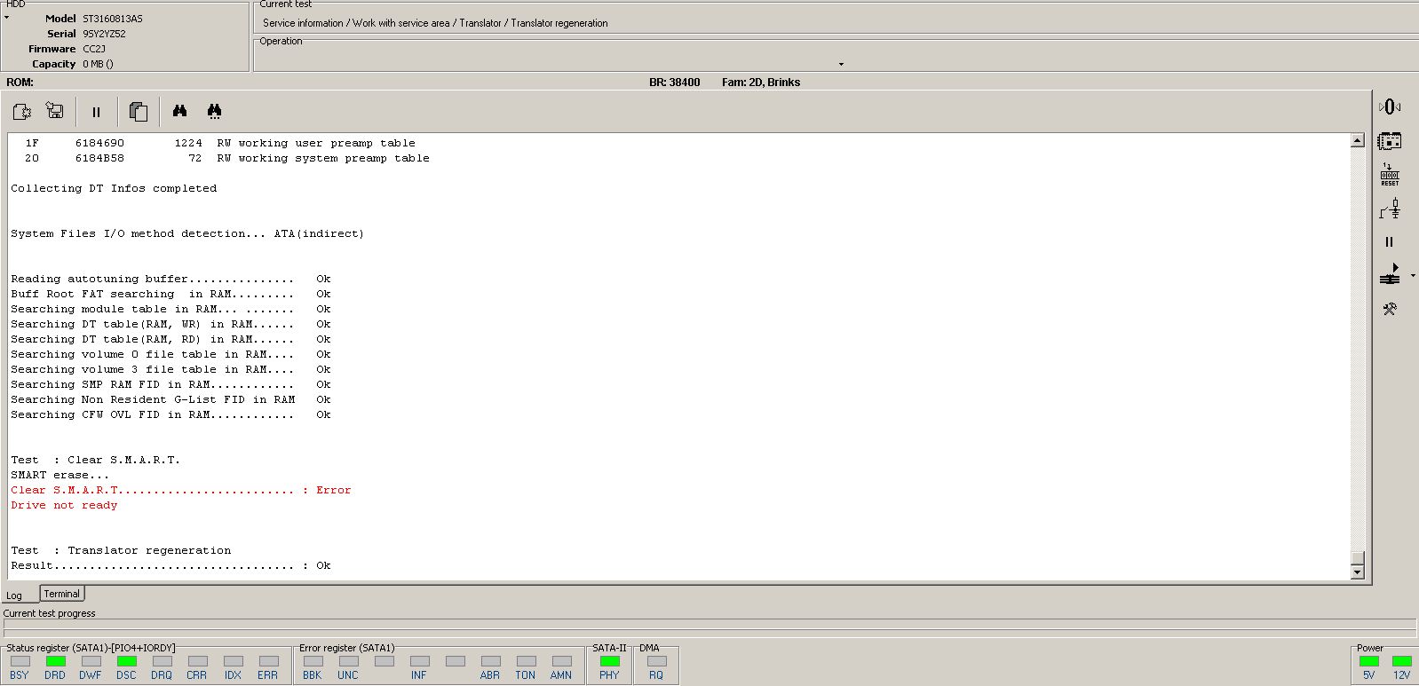

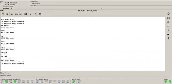

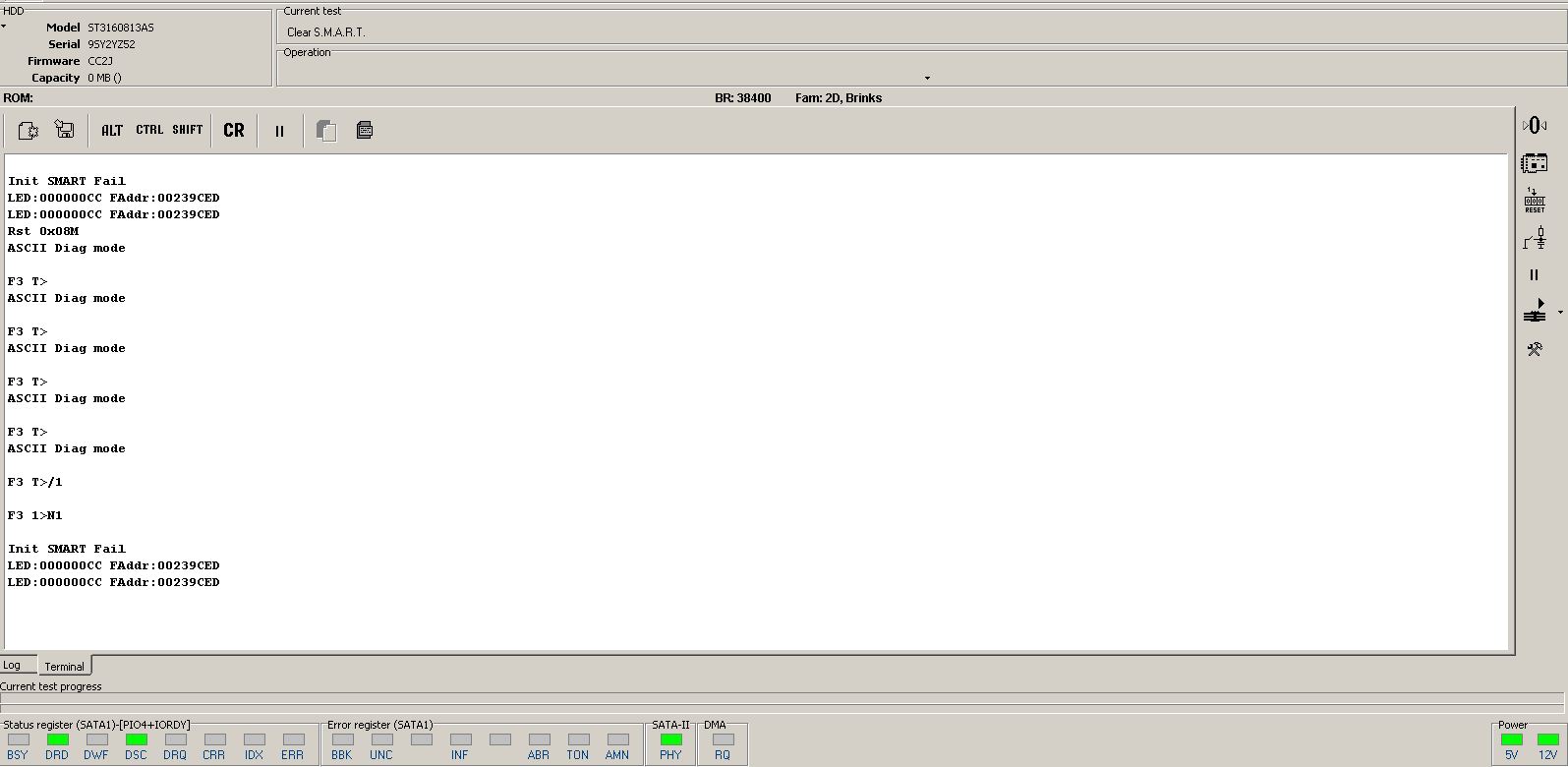

Hi E123,
Yes I tried to clear smart but its not working , disk gives LED error. Also tried to regen translator , process gets completed but after power on/ off capacity is still not regained.
PostPosted: August 30th, 2019, 12:09
Joined: September 26th, 2016, 4:26
Posts: 127
Location: Russia
I have CC2J. In the place where you have an error there is a transition "to nowhere." Perhaps a bug. Although I do not exclude that I disassembled something incorrectly. In any case, I can advise changing the firmware to some not so rare one.
RAM:00239CE0 CMP R1, #2
RAM:00239CE2 BNE loc_239CEE
RAM:00239CE4 MOVS R3, R5
RAM:00239CE6 MOVS R2, #0x10
RAM:00239CE8 MOVS R1, #0x51
RAM:00239CEA BL 0x4C889C <----- here
RAM:00239CEE
RAM:00239CEE loc_239CEE ; CODE XREF: RAM:00239CBC↑j
RAM:00239CEE ; RAM:00239CC2↑j ...
RAM:00239CEE MOVS R0, #0
RAM:00239CF0 POP {R3-R7,PC}
