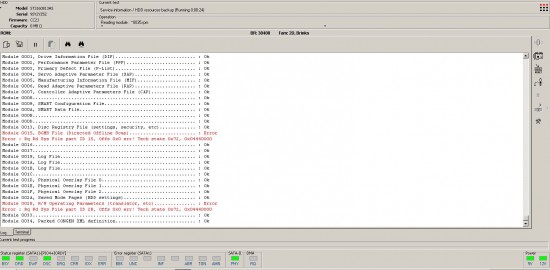

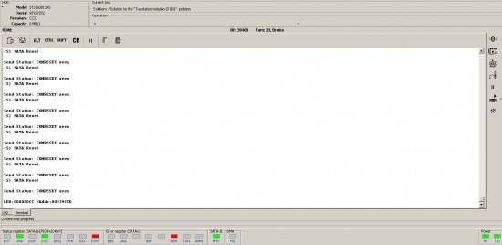

 Post subject: Seagate 0MB Translator violation solution not working
PostPosted: August 30th, 2019, 4:31
Posts: 196
I am working on a old seagate ST3160813AS /CC2J hard disk.
It gets detected in UDMA-E shows correct model /serial /FW but size is 0mb.
I have applied 0mb Translation violation solution but is not working.
How to go ahead now any suggestions pls.
160gbtrans.JPG [ 200.02 KiB | Viewed 6668 times ]
tr.JPG [ 112.02 KiB | Viewed 6669 times ]
trans.JPG [ 134.61 KiB | Viewed 6669 times ]
160gb.JPG [ 166.75 KiB | Viewed 6669 times ]
 Post subject: Re: Seagate 0MB Translator violation solution not working
PostPosted: August 30th, 2019, 4:40
Posts: 849
Location: Pakistan
it seems SA has problem, what about sysfile 28 ? can you read it without errors ?
Data Recovery Pakistan
 Post subject: Re: Seagate 0MB Translator violation solution not working
PostPosted: August 30th, 2019, 4:49
Posts: 196
MindMergepk wrote:
it seems SA has problem, what about sysfile 28 ? can you read it without errors ?
Hi MindMergepk
Yes I could read this file with both Heads ,however I am getting errors while reading files 30 ,31 ,32 onwards
28.JPG [ 244.56 KiB | Viewed 6658 times ]
 Post subject: Re: Seagate 0MB Translator violation solution not working
PostPosted: August 30th, 2019, 6:26
Joined: September 26th, 2016, 4:26
Posts: 127
Location: Russia
Judging by the screenshots, you regen the translator. Power off/on. Size shows? Smart cleaned?
 Post subject: Re: Seagate 0MB Translator violation solution not working
PostPosted: August 30th, 2019, 11:40
Posts: 196
E123 wrote:
Judging by the screenshots, you regen the translator. Power off/on. Size shows? Smart cleaned?
Hi E123,
Yes I tried to clear smart but its not working , disk gives LED error. Also tried to regen translator , process gets completed but after power on/ off capacity is still not regained.
transl.JPG [ 133.99 KiB | Viewed 6586 times ]
smart fail.JPG
smart fail.JPG [ 103.93 KiB | Viewed 6586 times ]
 Post subject: Re: Seagate 0MB Translator violation solution not working
PostPosted: August 30th, 2019, 12:09
Joined: September 26th, 2016, 4:26
Posts: 127
Location: Russia
I have CC2J. In the place where you have an error there is a transition "to nowhere." Perhaps a bug. Although I do not exclude that I disassembled something incorrectly. In any case, I can advise changing the firmware to some not so rare one.
RAM:00239CE0 CMP R1, #2
RAM:00239CE2 BNE loc_239CEE
RAM:00239CE4 MOVS R3, R5
RAM:00239CE6 MOVS R2, #0x10
RAM:00239CE8 MOVS R1, #0x51
RAM:00239CEA BL 0x4C889C <----- here
RAM:00239CEE
RAM:00239CEE loc_239CEE ; CODE XREF: RAM:00239CBC↑j
RAM:00239CEE ; RAM:00239CC2↑j ...
RAM:00239CEE MOVS R0, #0
RAM:00239CF0 POP {R3-R7,PC}
 Post subject: Re: Seagate 0MB Translator violation solution not working
PostPosted: August 31st, 2019, 7:27
Posts: 196
Wo great E123 ,Thank You so much,
I will give it a try but I am doubtfull whether I will be able yo do it.
Users browsing this forum: No registered users and 46 guests
cron
