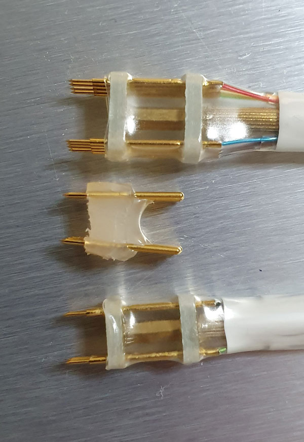

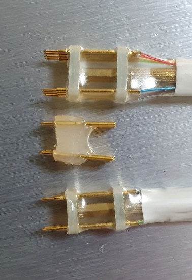

einstein9 wrote:
digisupport wrote:
I prefer external programmer to read and write ROM without removing from the PCB.
REVELPROG-IS and the right clips has done a perfect job the last couple of years
have a look here, https://drive.google.com/file/d/14QM1eQ ... sp=sharing
the upgrade ver. of the clip
Tip: use Adjustable Stand :wink:
+1 what i use, some premade and homebrew for WSON :)

 Post subject: Re: spyglass Rom writing on Unlock pcb ?!!
PostPosted: October 21st, 2019, 10:09
Posts: 2854
digisupport wrote:
einstein9 wrote:
Humm, looks good but i think the ready one looks more practical than yours,,, replay the video and see how much it resists the pressure ,,, very strong
I like the DIY ver. to test but prefer the good quality for daily usage.
