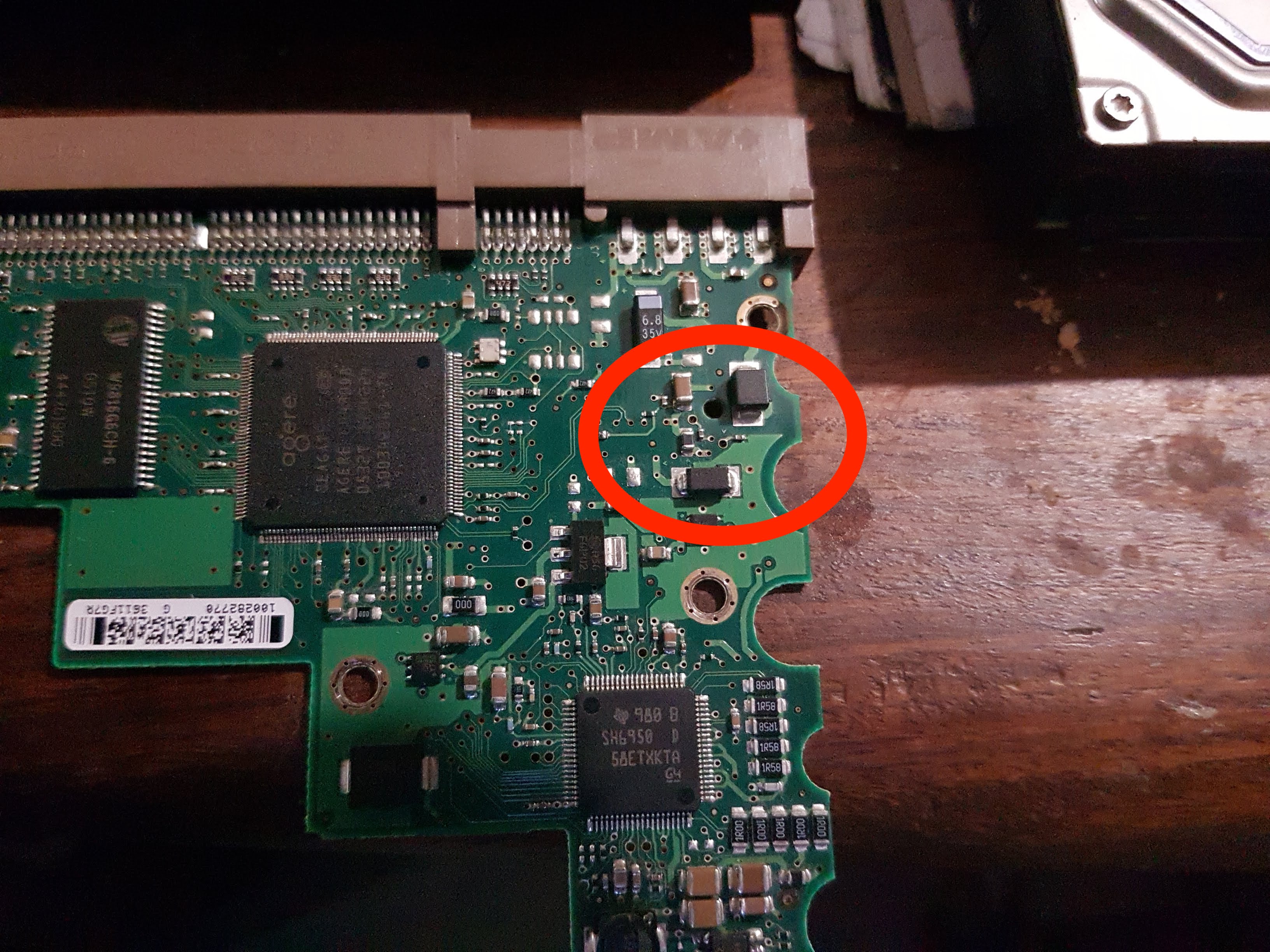

I've got an old (2005) IDE Barracuda 7200.7 160gb. Model ST3160021A. No sign of life at all. It has no value but I just want to practice on it to see if I can get it back to life.
Is there a tvs diode, I can remove to see if that's the problem?
I've attached a picture of the board but can't tell where the diode is. There is no obvious burnt area or any other sign of damage.

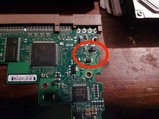

Check those two with a multimeter.

Not sure which is positive or negative on the diodes. Results are...
negative probe on top end of larger diode gives a reading of around .645
Opposite gives 1.99
negative probe on left of smaller diode gives 1.42
opposite gives .556
Either way they seem ok don't they?

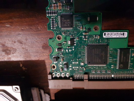

The connection points to the drive on the underside of the board are a bit discoloured. Is it worth cleaning them gently with an eraser?

Easy way to check TVS diodes is to use a MM with a “beeping” continuity mode.
If the MM beeps then the TVS is bad.

Checked the one above as well...6.8 35v?

No beep in continuity mode. Similar readings to large diode near it..
That is a 6.8uF 35V capacitor.

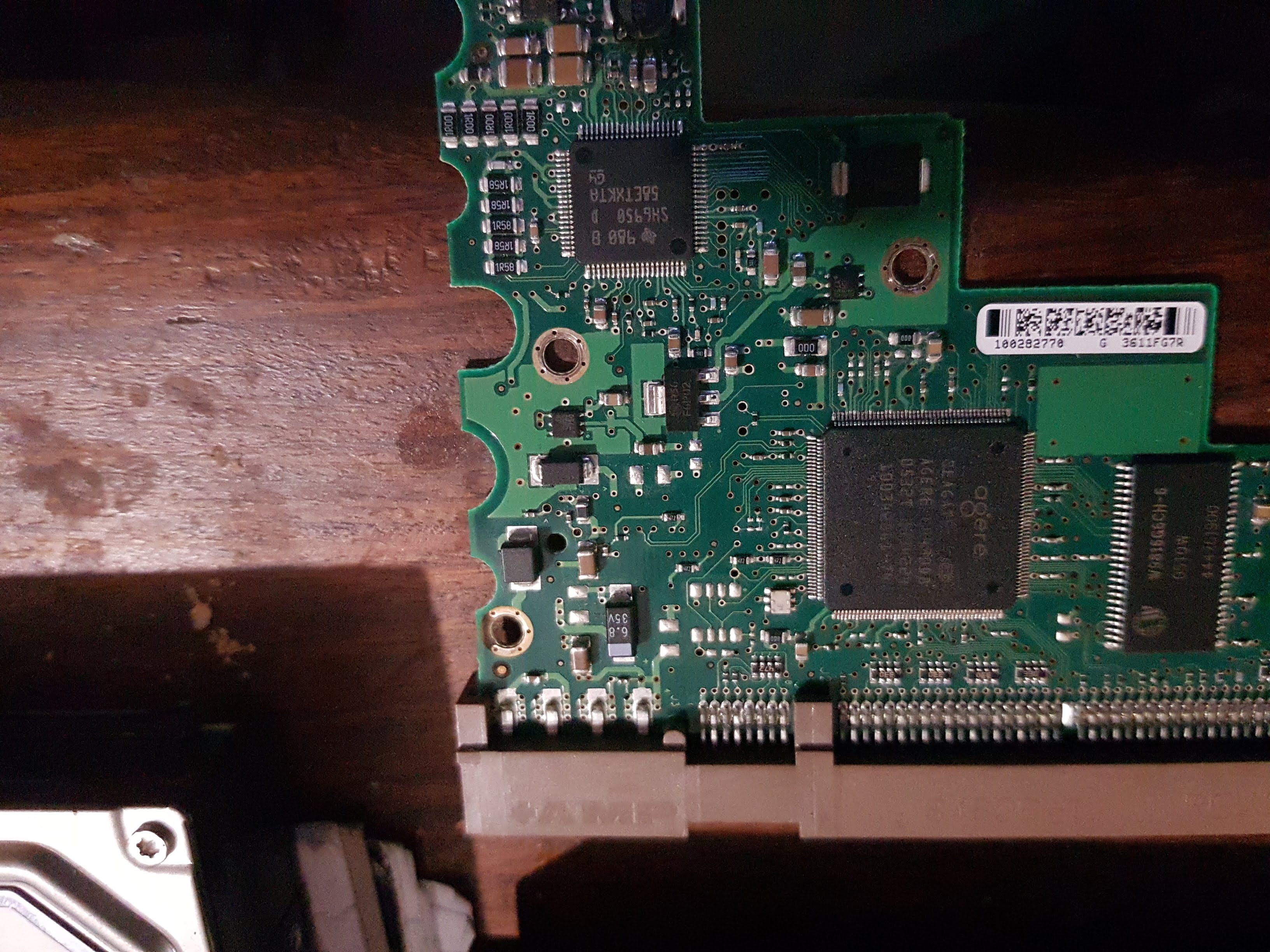

Measure the voltages at the two 6-pin ICs (what are their markings?) and the F6P02 MOSFET.
The negative supply for the preamp appears to be at the rear of the PCB. Measure the voltages on the adjacent capacitors. (What are the markings on the IC?)

Result... Cleaning the connection points on the pcb seems to have fixed the problem. The disk now boots up and I can access the data on it...

I assume you mean the HDA pads. What happens if you isolate the HDA with a business card?
