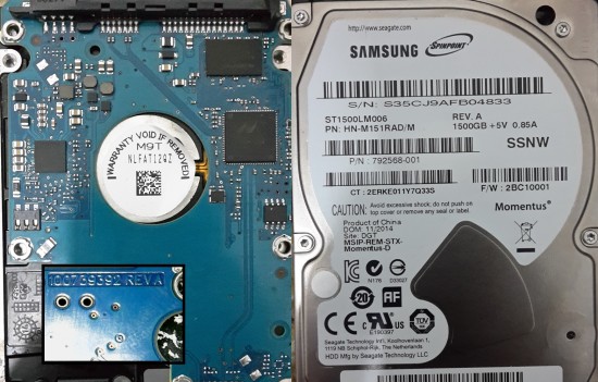

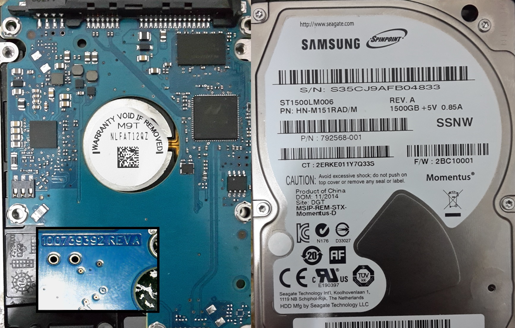

 Post subject: ST1500LM006 Liquit Damage, Motor not spin
PostPosted: December 1st, 2019, 18:03
Posts: 489
Location: Usa

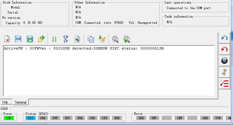

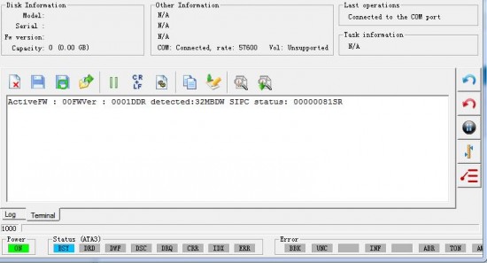

Terminal log
ActiveFW : 00FWVer : 0001DDR detected:32MBDW SIPC status: 00000081SR
and bussy.
Cannot get ROM.
I dont have donor PCB. Couldnt find it in my country .
I need help for repair PCB

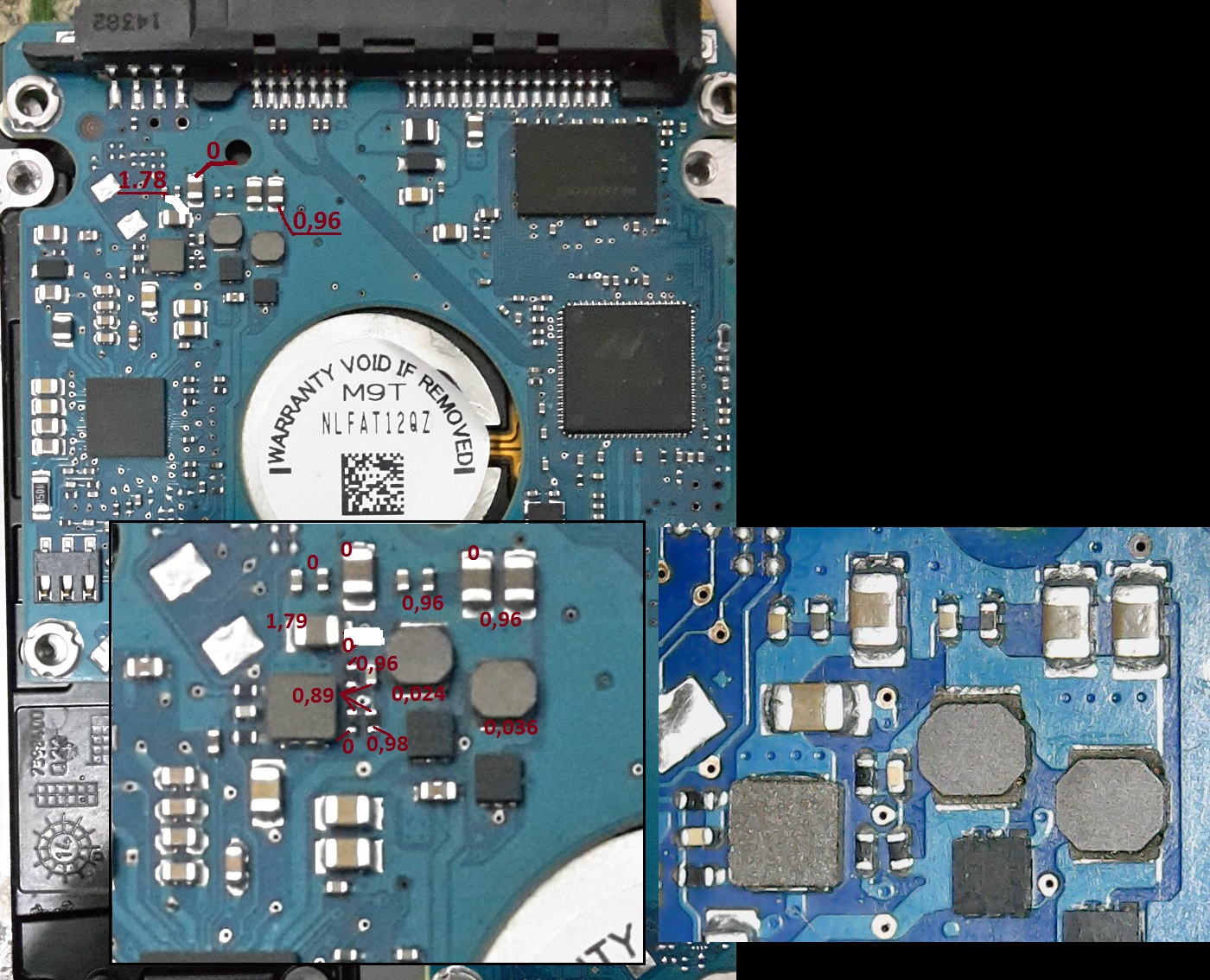

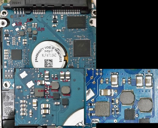

ISTM that, if you are getting output from the terminal, then there can't be much wrong with the PCB, if anything.
Normally you should see the preamp ID in your terminal output. Could it be that the preamp has been damaged?
What voltages do you measure at each of the 3 coils and the diode at the top left corner?
Do you get a different terminal output when the PCB is off the drive?

Same terminal log if power on just pcb. I have posted above that log.
Could you please mark which point voltages would I measure.
Is it possible to check preamp with measure from connection points?

As already stated, those voltages look good.
    Vio = 1.78V
    Vcore = 0.96V
