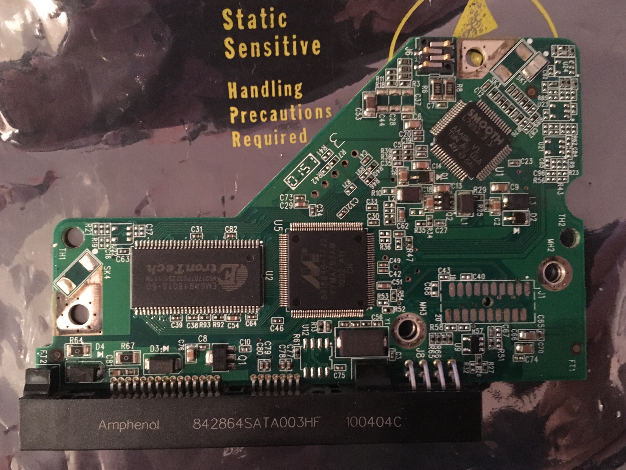

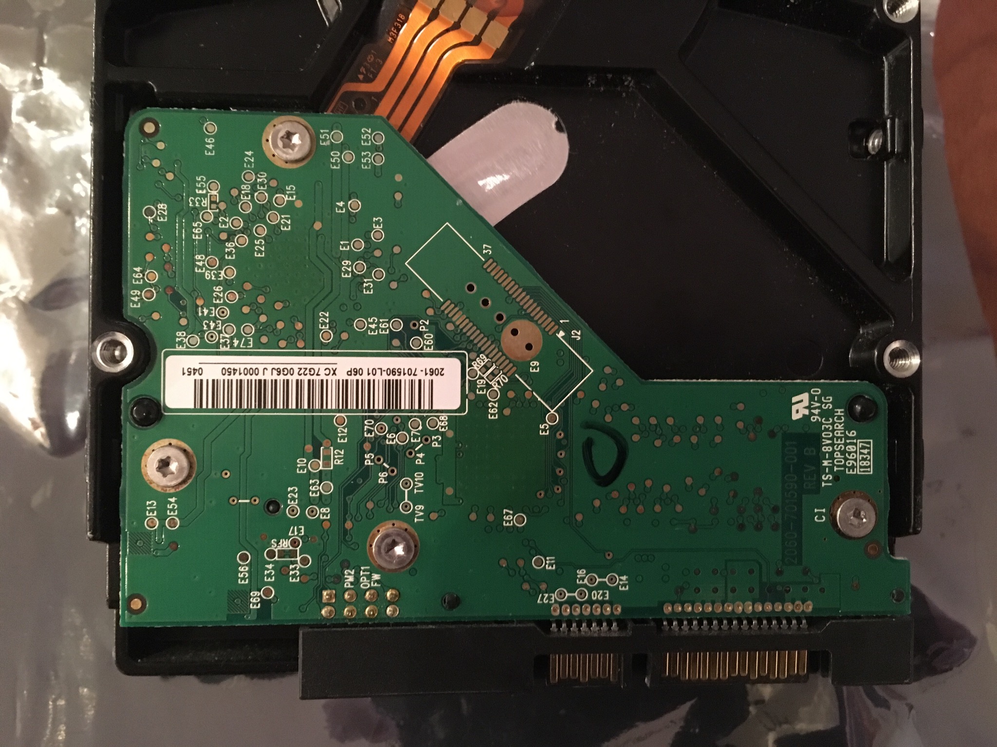

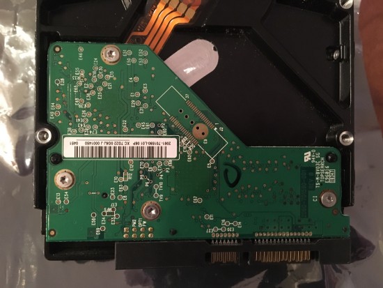

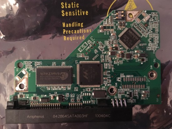

Here are the pics
 Post subject: Re: WD6400AAKS not spinning up!
PostPosted: February 8th, 2020, 4:04
Posts: 17091
Measure the voltages at Q1 (near the "ROM") and L1 and L2 (inductors near SMOOTH chip). Q1 is the +3.3V supply, while I expect that L1 and L2 would be +1.2V (Vcore) and +2.5V (Vio).
If any voltage is missing, measure the resistance between it and ground. You can use the working PCB for comparison.

Q1 voltages p1-3: 3.95, 5, 3.28
L1 voltages: 1.178, 1.188
L2 voltages: 2.569, 2.577
(Screw hole as ground)
PostPosted: February 8th, 2020, 15:34
Posts: 17091
It looks like the SMOOTH chip is generating the proper supply voltages.
Did the drive come from a desktop PC? Is there any possibility that PUIS is enabled (Power Up In Standby)? PUIS is commonly enabled in DVRs.
I don't know if the demo version of WDMarvel is able to read the "ROM" code from you board. If not, then there may be another way, but it would require a lot of mucking about with TTL adapters and shorting points on the PCB.
Still, one would think that hdd-parts should be able to read the ROM in this state, if they have the DR tools, and if the MCU and its oscillator are working.
