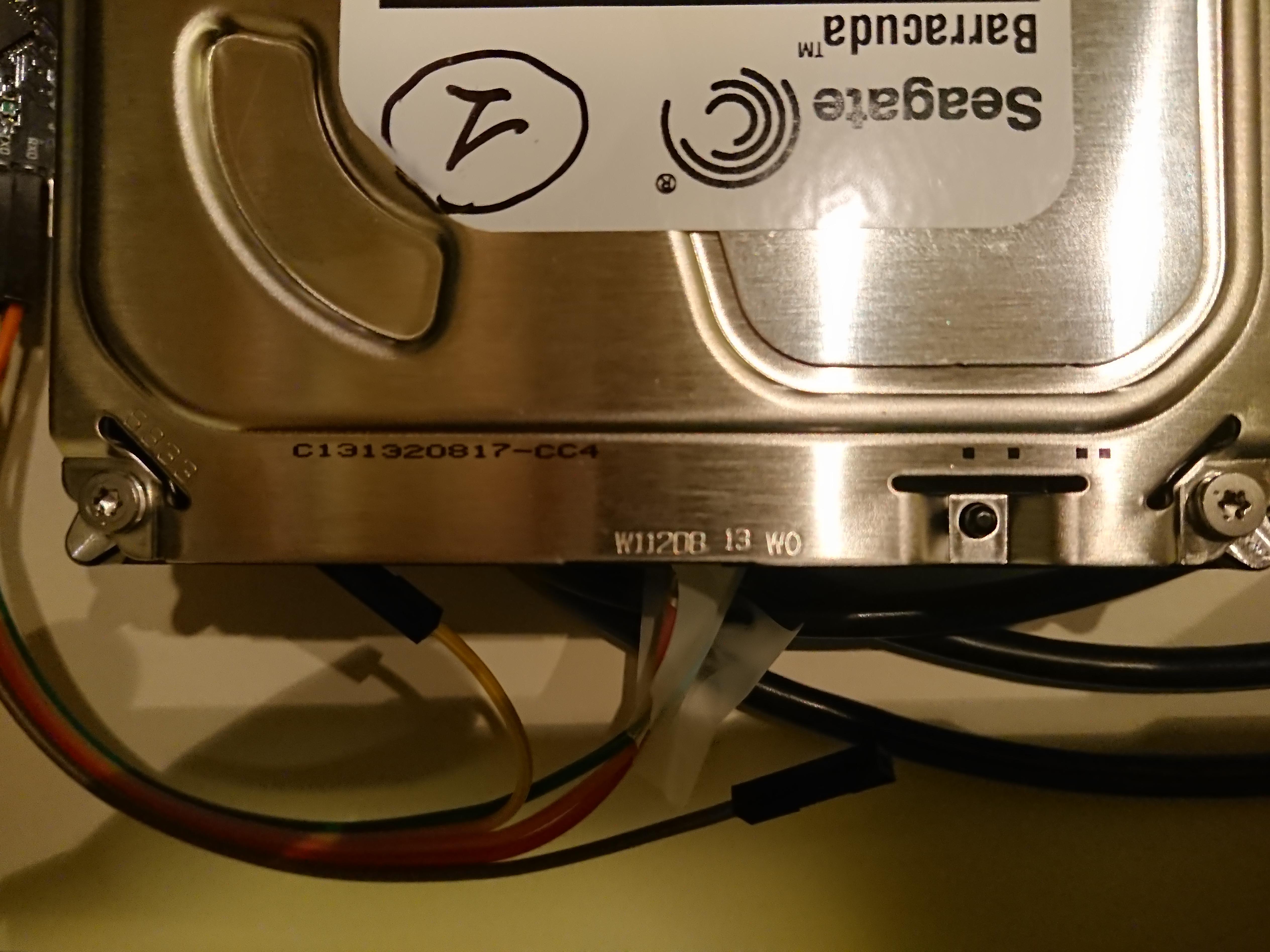

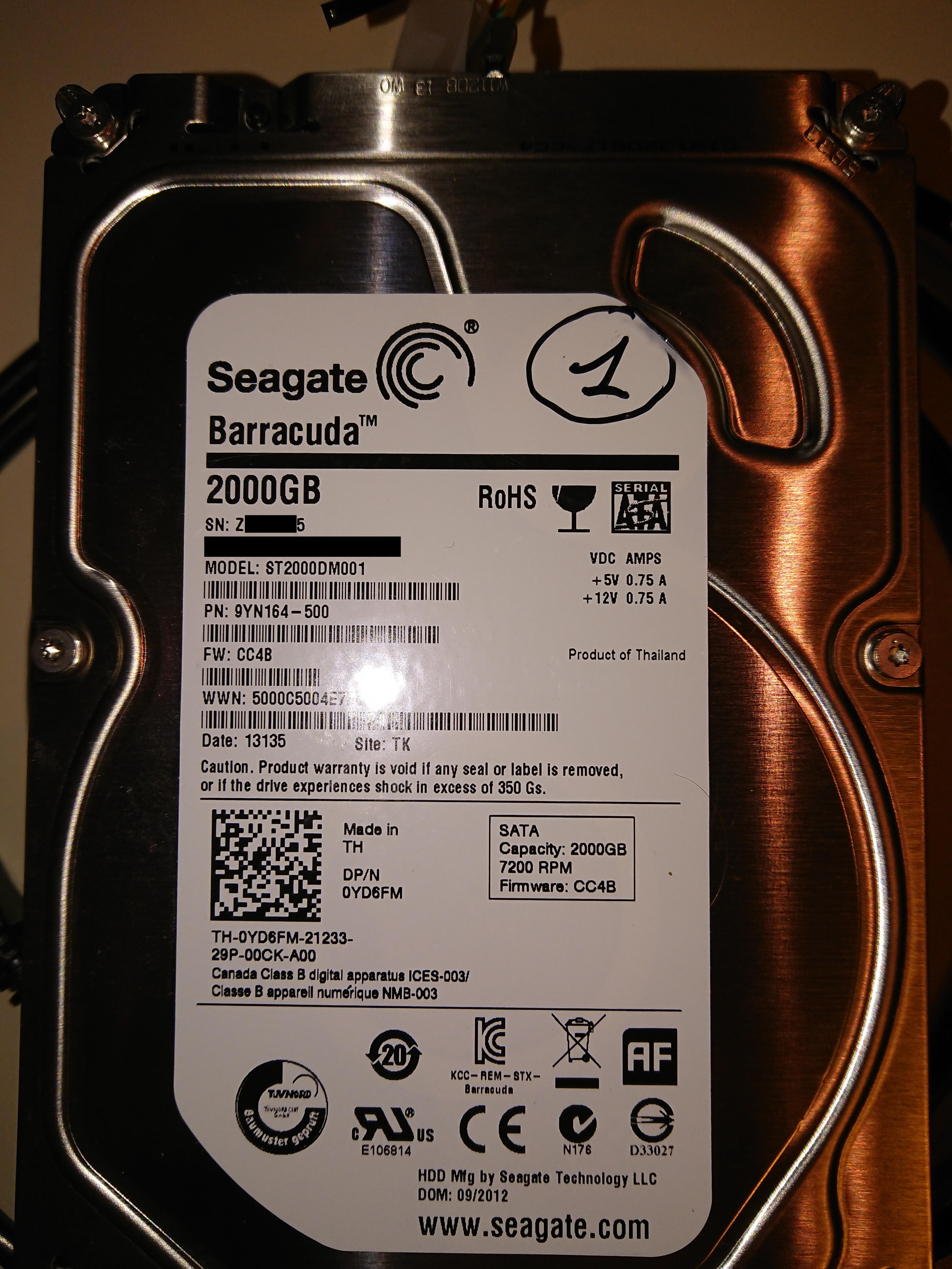

Here's photos:
File comment: st2000dm001_9yn164 (label)
File comment: st2000dm001_9yn164 (other part number)

These drives are prone to develop surface and head damages just by themselves. If you already had issues with it before you forced that fw update, i think this is the case.
I doubt that any fw version for the same family would cause such log.
Servo !supported preamp ID 0000
this one is odd as well, coz surface and head problems do not cause such log i think. Unless you have bad contact between PCB and HDA in addition.

yeah, no point in repairing it after you opened the HDA.
The story is somewhat odd to me and i would be really interested wether that fw update could have killed the preamp, which i doubt... do you get that !supported preamp ID 0000 msg without isolating the preamp?
It is a bit confusing me, i am not even sure you put the paper between motor contacts or preamp contacts...
I also met a fw update flaw on 7200.4 drives. The client updated several drives at their company and one of them failed at some point, leaving the backed up adaptive files in the folder the update was run from. When they tried to update the next disk, the update process was unable to save the current adaptives because the files already existed, but it did not fail with an error, it continued to the update and uploaded the prev. disk's adaptives to the current one, effectively killing it for good. But even in that case the drive was OK mechanically and electrically as well, 'only' the adaptives were swapped.
Anyway, your drive is not repairable, if you had data on it it would be probably recoverable, but since you don't, there's no point trying anything.

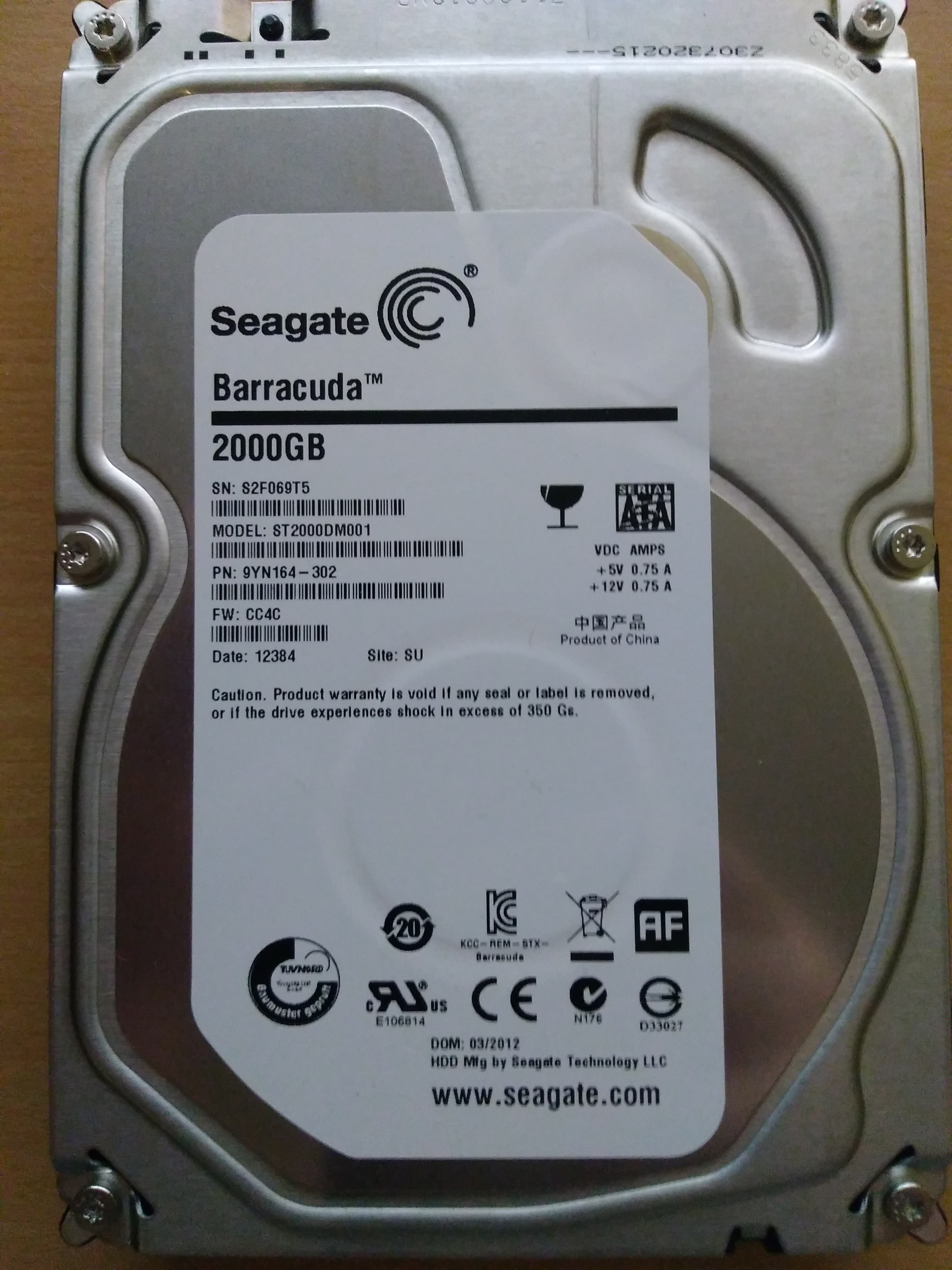

I followed the exact same procedure to update my ST2000DM001s firmware.
According to Seagates Download Finder (https://apps1.seagate.com/downloads/request.html) an update was recommended, but the provided program wouldn't flash it.
As the drive was supposed to be a 4 head model, I used the closed source SeaChest to apply the firmware file GRCC4H4H.LOD and guess what!
The drive stopped working and started spitting out errors on the serial interface:

So it seems to me, that there is indeed an issue with a wrong firmware, even though Seagate recommends an update.
Fortunately, I do not need to recover any data from the drive, but I am curious, if the drive can be restored.
As aboveunder described, I am not able to enter the serial terminal. The error message doesn't even change, if the pcb is disconnected from the drive.
Does anybody have an idea how the terminal could be entered anyhow?
