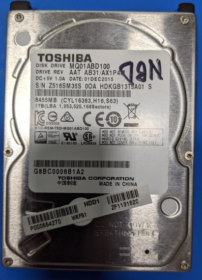

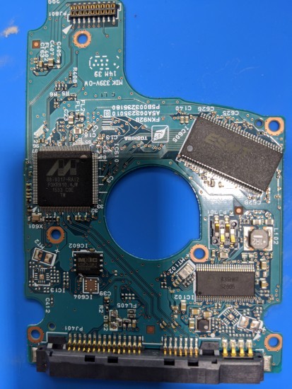

Hi all,
New to learning data recovery and soaking up as much information as I can. I have a Toshiba 2.5 drive that has a dead pcb. Drive and pcb details pictured below.
This is a drive for learning purposes and has absolutely no important data on it.
Plug drive in and it doesn't make a sound, doesn't vibrate, spin nothing.
Took off pcb and plugged pcb in to probe with multimeter. It appears that where the diode would be has 5v. The input of the fuse does too. Output of fuse has nothing. So fuse is blown. I measured for short from input of fuse to ground and it looks good. Measured output to ground and looks like there is a short. I applied voltage to the output of the fuse to see if I could tell what component failed and it looks like IC102 gets really hot. Which is a TLS2605 and I believe that is the motor control?
I have a new pcb coming and I believe ic602 is the one that needs to be swapped to new board. Is that correct?
What would I measure to see if the preamp was fried? Also, are there any other troubleshooting steps that should be done or things I should have done instead of what I did?
Thanks for your time!
 Post subject: Re: Toshiba PCB swap learning
PostPosted: July 5th, 2020, 9:17
Yes, IC602 is the chip that needs to be transferred
PostPosted: July 6th, 2020, 17:52
Posts: 4808
you can surely find the supply lines for the preamp, + and -, check those on the preamp connector (HDA side of course) against short to gnd to rule out a preamp damage.
Another way is to compare measured values to a known good drive on all preamp terminals and if you experience significant difference, consider the preamp as toast.
PostPosted: July 13th, 2020, 17:32
Posts: 17215
It's hard to tell where the PJ801 pins go, but if you want to try to map them out, let me know and I'll try to help you. If we can identify the preamp power supply pins, then we can at least verify whether the preamp is shorted.
More complete photos ...
