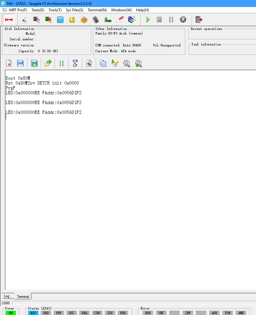

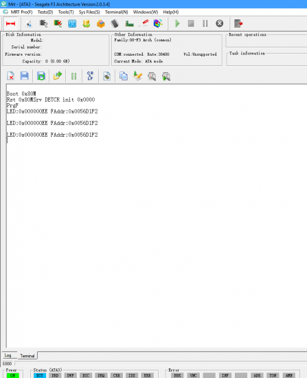

Hi guys, Im still have this drive with no success.
Boot 0x80M
Rst 0x80MSrv DETCR init 0x0000
PrgF
LED:0x000000EE FAddr:0x0056D1F2
This is Terminal
Any further Help is appreciated.
and if you need any more info just tell me.

please send a screenshot of mrt , I need to see wath recognize mrt.

This is what you want ?

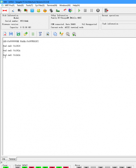

hi friend, identify your product with boot code in fist panel after identification power off and on and go in normal mode. After this stop task and go in terminal, check if you have acces t leve and post screenshot please

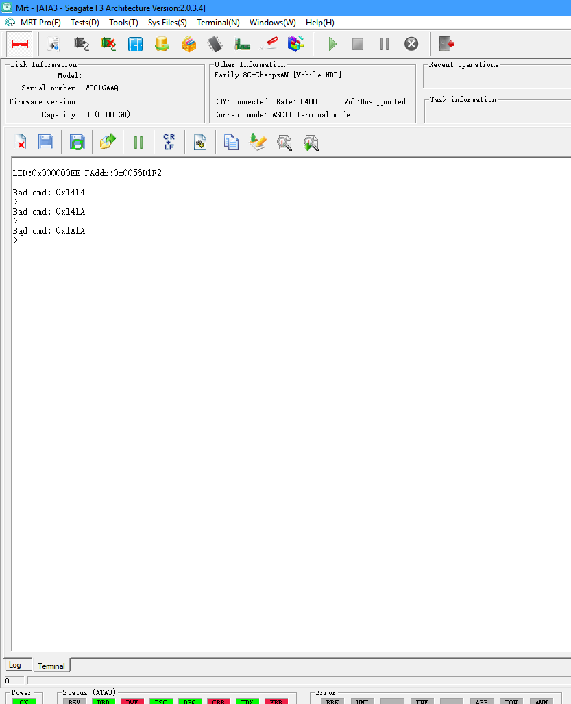

okay I have this
what is next?
 Post subject: Re: Seagate ST2000LM007 Problem
PostPosted: October 20th, 2020, 19:57
Posts: 4808
probably 1d2
