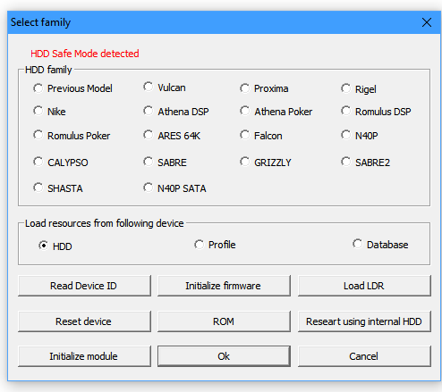

Hi there is this drive with no Detect at all, and I have no experience in Pata drives, any tip to get Detect ?
I have MRT Ultra.

Yes jut not detect , so what option to use in PC3K, maybe I can use that in MRT,
and we have this options in MRT

MRT can detect the drive if is ok, but if you need to upload a LDR then it will not work.

Thanks guys, The problem is way easier than I think, a guy in data-medics.com/forum/ Suggest to put jumper on drive and Insert in Master, and it detect easily.

I thought you knew that's why I didn't tell you before, since you wanted to upload ldr. To do this you need to put the disk in safe mode and then you can load ldr
