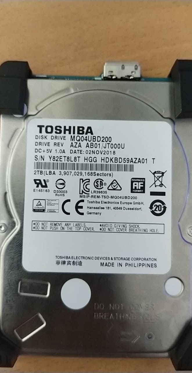

Hello there,
I'm looking for a PCB USB or sata (compatible) for this HDD in the attached picture.
Model: MQ04UBD200
Rev: AZA AB01/JT000U
Date: 02NOV2018
Serial: Y82ET8L8T HGG HDKBD59AZA01 T
Country: Philippines
Please PM me if you have a SATA PCB that is compatible or the same PCB for this drive.
or just leave a post with suggestions or links related.
Thank you for your help.

Is the pcb G0034A ? Aliexpress or a G4311A should do.
 Post subject: Re: looking for USB 2,5" toshiba drive compatible PCB
PostPosted: June 9th, 2021, 2:15
Posts: 17330
MQ04ABD200 should be the equivalent SATA model.
PostPosted: June 9th, 2021, 18:02
Posts: 489
Location: Usa
ACE Forum says G4330A USB>>> G4311A sata

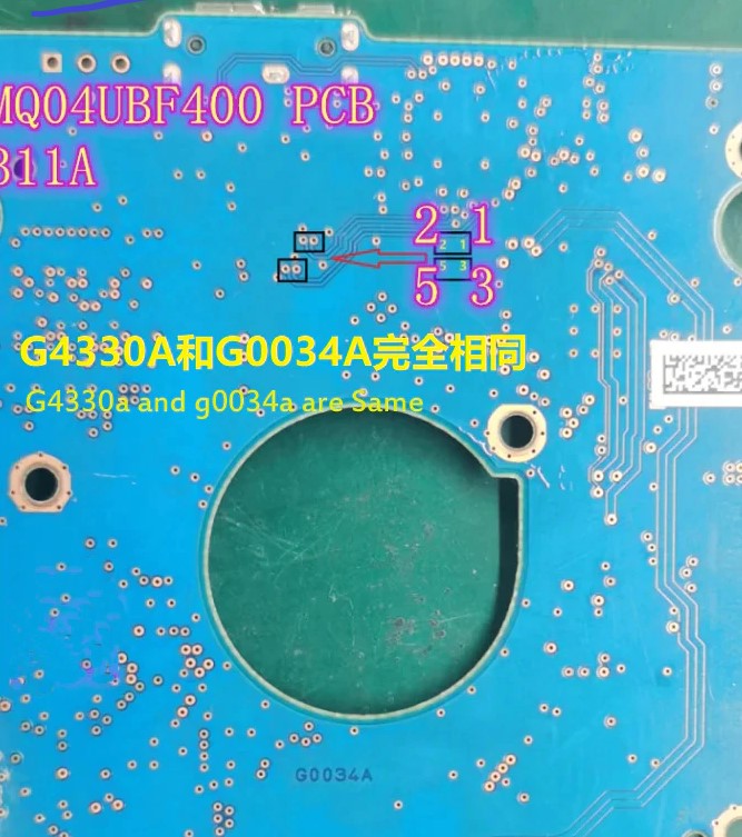

the reference on the PCB is G0034A. Would this G4311A sata be compatible with my client's version?
Easy to convert to SATA. Substitute 1,2,3,5 with 2,3,5,6 on 7 pin SATA connector.
the Client's PCB is not fully functional, at least the drive spin but nothing more. I've figured that exchanging the PCB would be easier with a Bios transfer than desoldering. Myself i've no experience in electronics, so i'm taking the safest route with my actual skills and knowledge. But thank you for contributing to my issue with your insight.
