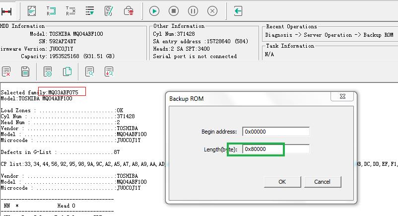

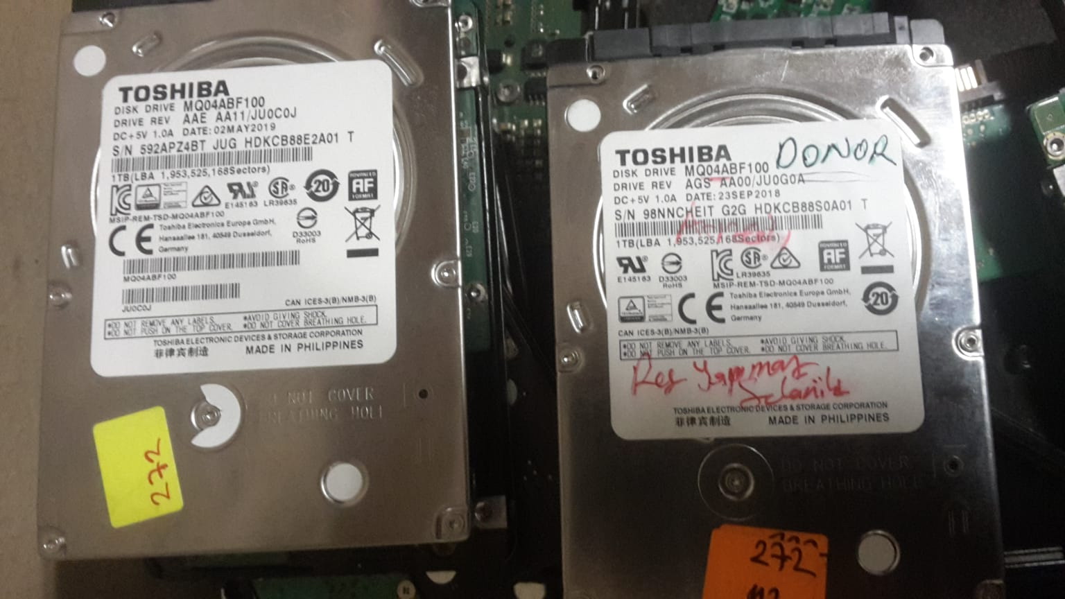

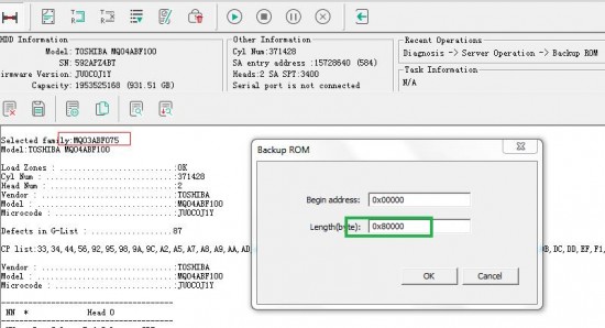

Hi.
I have a MQ04ABF100 drive. Swapped head. I can read all modules. But cannot access to UA.
I have MRT
Selected family:MQ04ABF100
Model:TOSHIBA MQ04ABF100
Load Zones : .........................:OK
Cyl Num : ............................:371428
Head Num : ...........................:2
Vendor : .............................:TOSHIBA
Model : ..............................:MQ04ABF100
Microcode : ..........................:JU0C0J1Y
Defects in G-List : ..................87

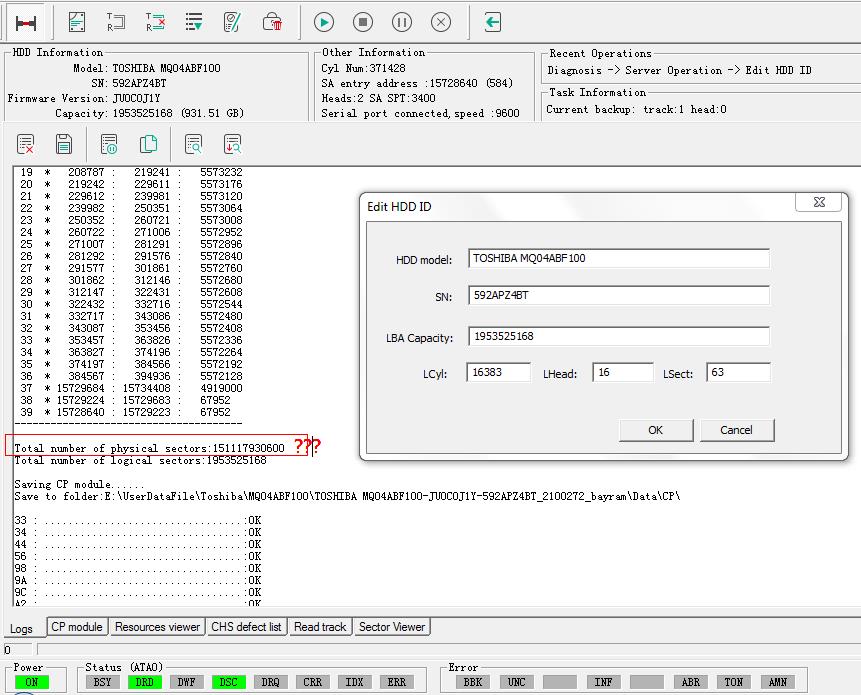

[b]Total number of physical sectors:151117930600
Total number of logical sectors:1953525168[/b]
I faced the same problem before MQ01ABF050 models. Are those models still undiscovered for DR also MRT ?
By the way, I'm not sure if my donor is compatible.

MRT's SPT numbers in the zone table (?) are nonsensical. I suspect that MRT does not understand how to parse the relevant module. The numbers only seem to make sense if you convert them to hex and use the lower two bytes.
I suppose the lack of UA access is not just a simple case of password protection?
Probably, he simply forgot to run TechnoOFF. Under TechOn, drive is not going to give user area access due of 2nd translator. This is SMR drive.

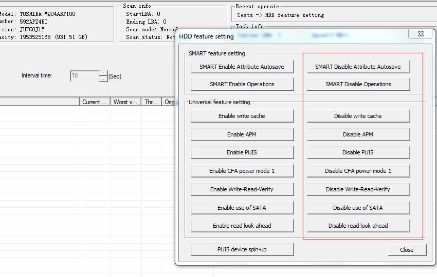

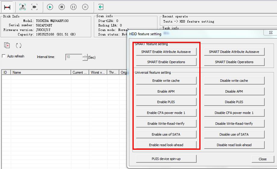

At beggining sory my poor English. I would try to explain my problem.
Strange drive behaviour.
Today I had remote support by MRT tecnician.
This drive not geting ID directly. It have busy state. But I have force to connect Toshiba section whatever get error. After first attempt then I get full acces to drive SA. And then tecno off ,but still no access UA.
Tecnician opened common utility ( its in logic test section . like as in pic attached)
Than changed some of thems one by one.
I have recognised, data transfer led turned off (I mean that led on hardware. MRT Card). Checked drive . Spined off also.
Restarted drive. Not access SA, tried same method. But now 0 capacity. also not access to SA. Till read CP 33. When read CP 33 spindle getting on , turning and reading this module. I have checked DD (Plist) not look as original. different
I have decided to get image disk . Woha. I have imaged 30% of disk. But data shifted. ( not according to P list)
Tried Raw data recovery. That ok. so much small file are ok. But there is no good folder structure. and big files not oppening As expected .
Also tested sector 0 to 15. Not common things in it.
I am adding that also
I have tried change that smart adjustments again, some time I could see DD as original. But in that condition, I cannot read any user data.
By the way. Checked again with another good MQ04ABF100 drive. MRT not showing PList ,also G list. And as I added upper message zone list is not true. I know them so never touched this drives any CP .
I have original CP and ROM. But afraid to try write them . I have bad experiences with toshiba oldest models. Some drives turning DRIVE UNDER COSNTUTION after try to write all CPs .

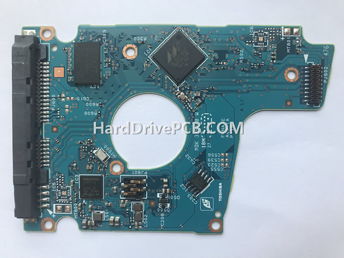

Drives beginning problem is PCB also stucked head on platter.
Changed PCB (G411A), and swapped head.
I have another drive MQ04ABF0100. (G4311A ) Not checked if compatible yet
So need advices. Thanks.

I've get a risk.
I have turned drive to initial state again
pressed all of them in red
Checked P list module DD same as before MRT now. But not getting P list as a list
APM:Advanced power management
PUIS:Power-Up In Standby
So drive spinning with power on now.
Atteched last condition CPs.

I'm wondering whether the earlier differences in the CPs were due to user "error". I have noticed that PC3000 has a bug whereby it applies incorrect sizes when reading Toshiba CPs. Maybe MRT has a similar bug, in which case different sizes may be the result of selecting different families.
As far as I can tell, the "HDD feature settings" are written to CP 0xD0. These settings would not have affected your overall resource dump.
I don't know the function of CP 0xFE.
In short, I doubt that the MRT tech did any damage. The CP differences appear to be the result of selecting different families for each run.
    Selected family:MQ04ABF100 <- before MRT
    Selected family:MQ03ABF075 <- after MRT
    Selected family:MQ04ABF100 <- OK again

Its true. was sellected MQ03 for a try. and my dump was at MQ03.
don't see the G-list in any of your dumps.
I never interested it before.
If you can give me a full ROM dump
I have get ROM according to MRT's ROM reading settings . It was default size. Never played with that size before when getting ROM copy. Changed size to 0x1700 now.And trying to read all ROM if possible. But it takes long time.
If would't get Full Rom I would read it with external reader. Tomorrow I would attach ROM and G list for last situation. don't have thats dumps for other situations. (Learned this model has 1 Mb Rom). Tanks for all infos
Mostly I had trouble with MQ01ABF models also before. So I was actually very careful . Guessed he knows what he doing.
