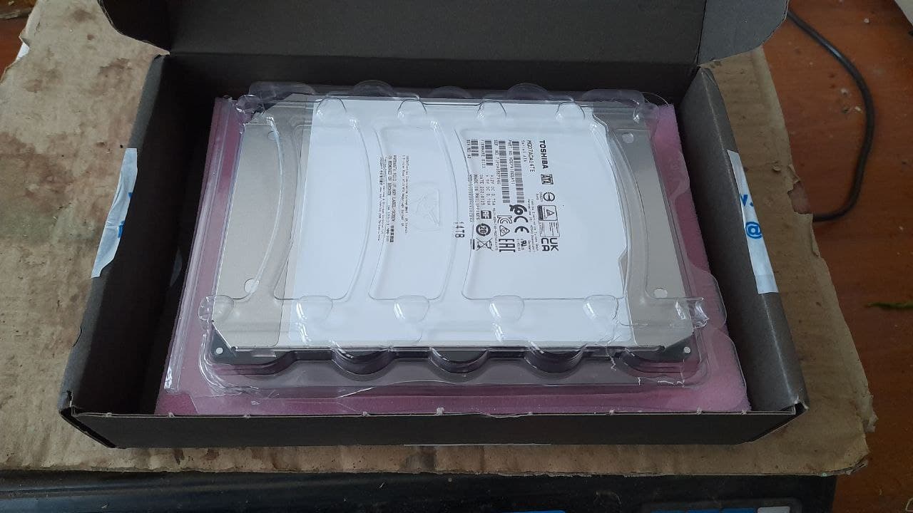

I was wondering if there is any good software I can use to run some basic test on the drive?
From the outside it seems to be perfect but the popular site I bought it from has this customary habit to send stuff inside used or recycled boxes.
Plus it has been thrown by the courier on my alleyway from the other side of the gate, part of the plastic envelop (see photo below) was damaged I assume due to transport and it didn't come inside the anti-static bag. Should I worry a bit?

 Post subject: Re: Choice and advice
PostPosted: February 11th, 2022, 4:06
Posts: 4848
It will probably go brick at the first powerup if it got damaged. So i recommend testing it for 1-2 days, if it fails you can get it replaced, if not, then it's not worse than anything else.
BUT! Hopefully you will have a backup after the story above :)
PostPosted: February 11th, 2022, 15:46
Joined: May 15th, 2019, 13:14
Posts: 70
Location: Italy
More or less my strategy. I just loaded it with 1 TB of unimportant data and left it connected along with the other drives. So far I haven't detected anything unusual.
Thanks for your reassurance pepe
