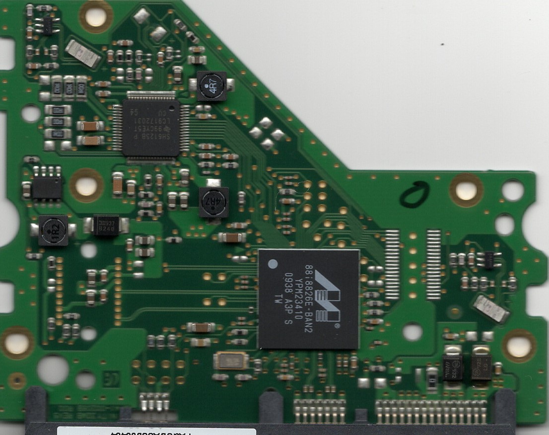

Hello HDDGurus,
i did a stupid mistake by plugging in a 24V Psu into the 3.5" USB adapter of my HDD. With the correct PSU I'm not getting any rotation, vibration or sound..
I can't see anything bad on the PCB. I found this thread: https://forum.hddguru.com/viewtopic.php?t=31944
What would you do?
Buy a used HE103UJ to replace the PCB? Or is there something similar possible like in the linked WD thread?
BR and thanks in advance!
francis
File comment: pcb (sorry for the bad focus of the scanner)
 Post subject: Re: 24V in Samsung HE103UJ SpinPoint F1
PostPosted: February 6th, 2022, 19:37
Posts: 1323

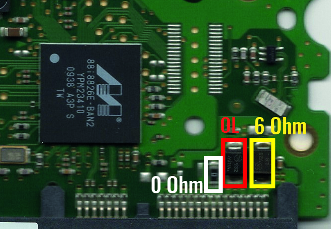

Get a multimeter and check the TVS diodes and the 0 ohm resistor bottom right next to the SATA power connector. You can't just buy a board and do straight swap you'd have to move the rom.

Hey, thank you very much for the quick response.
I just checked the components. The 0 Ohm resisotor seems to be fine with 0 Ohm.
The left TVS is above 200 Ohms (OL), Diode Test isn't beeping in both directions. In on direction the multimeter is showing 950 Ohm and in the other 550 Ohm
The right TVS has about 6-8 Ohm. Diode Test is beeping in both directions
If I understood it correctly, they should "have a low resistance in the forward direction, and a high resistance in the reverse direction."
So both TVS are not working properly?
That's effectively a wire. Assuming there's no other damage it should be safe to remove it.

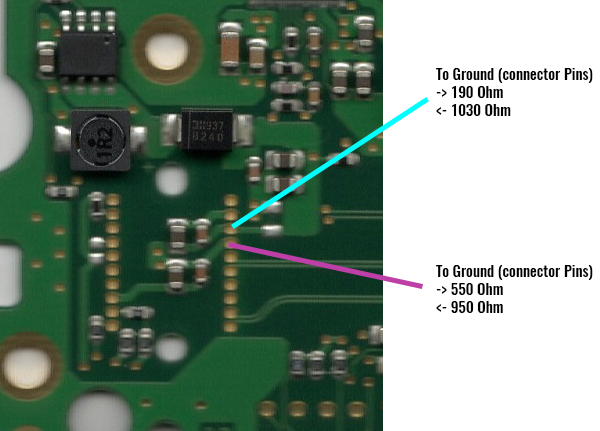

Tomset wrote:
In the beginning, call here:
Hey Tomset, I checked both against multiple ground pins of the Sata Power connector., see Picture A
Lardman wrote:

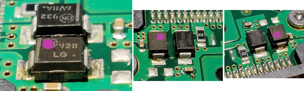

thanks for the feedback. I will remove the diode and see if it worked. On a closer look I notice that the solder joints on this TVS are browner than the joints of the left TVS. Refer to Picture B.

I just removed the Diode and everything is working great!
Thank you very much Lardman and Tomset!
