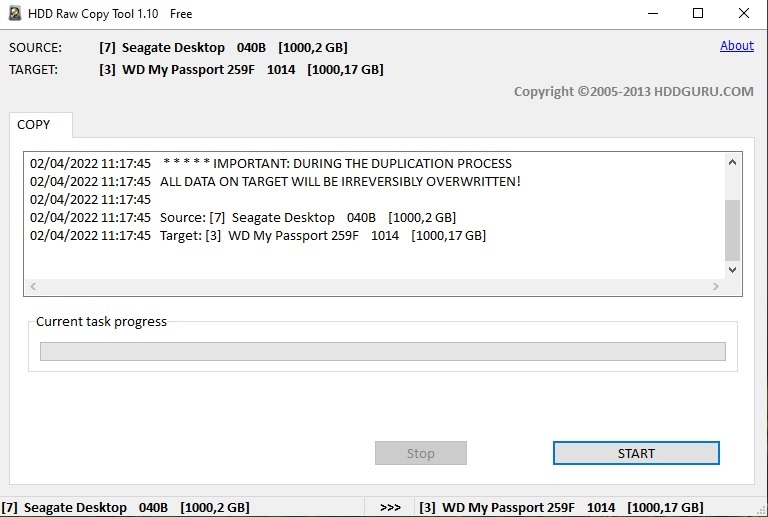

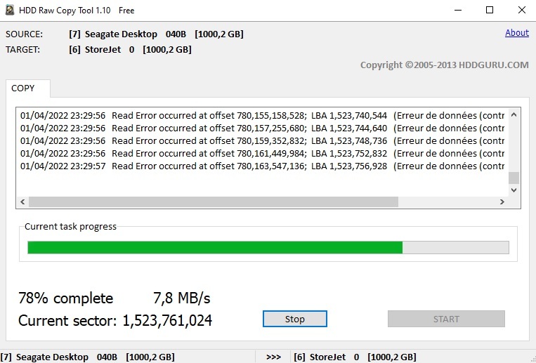

pepe wrote:
I don't see why would HddRawCopy tool lock the drive. What are the symptoms? does it report ID (seen by bios or windows correctly)?
I saw several such drives overwriting their own SA with user data due to a firmware bug, so is there a chance yours is struck by this problem too?
Perhaps ! Actually, I use HDDRawCopy to clone my XBox hard drives. I've done it several times without any problem, with different hard drives.
Now this source disk cannot be formatted and there are CRC errors when I use HDDRawCopy with it. (ATA Security is: ENABLED, PW Level HIGH, **LOCKED** [SEC4]) :
I just checked the destination disk and noticed that the total size is not the same with it being 1TB disk each. The source hard drive is 1000.2 GB while the destination hard drive is 1000.17 GB :
I think that the problem was there but how to repair the original disk please?
