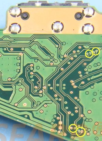

Anyone know the two points of read channel (TV9&TV10) for (2060-810035) ?

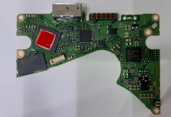

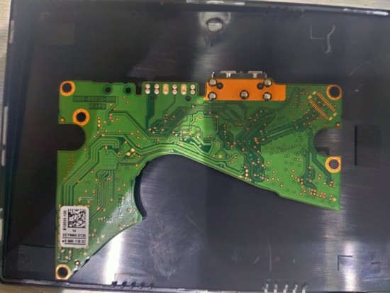

Sorry for the bad quality of the photos :

Drive model : WD50NDZW-11BCSS1
Tried different loaders without luck. (reset power and not accepted loader)
The drive is always busy, tried loader with and without SA access in ROM but no luck.

With the PCB removed from the HDA, measure the voltages at the indicated read/write channel test points (with respect to ground).
I expect that the read channel will measure 0V.

Thanks a lot Mr. Franc for your efforts. Much appreciated.
Case closed.
