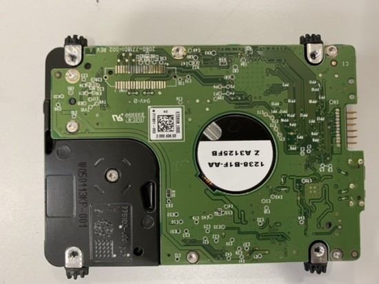

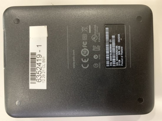

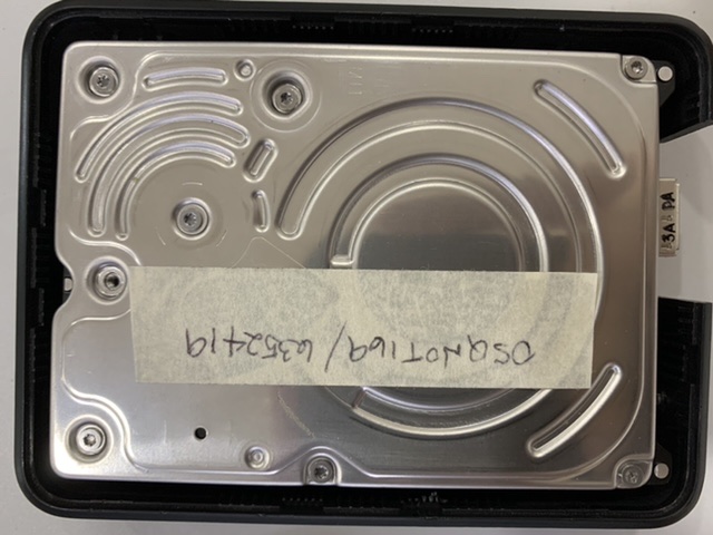

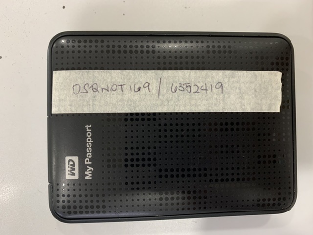

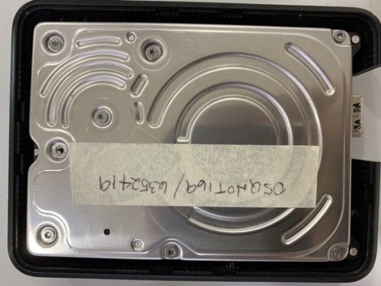

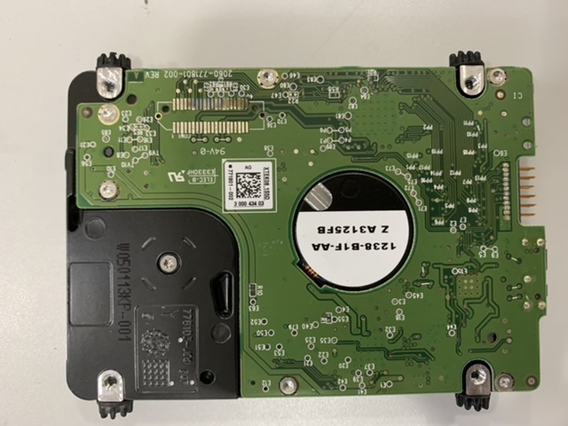

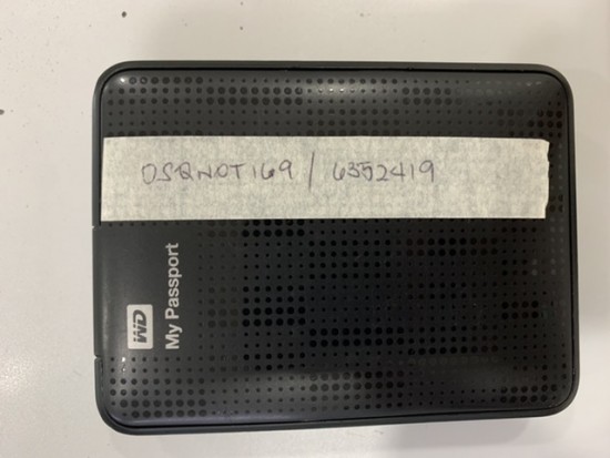

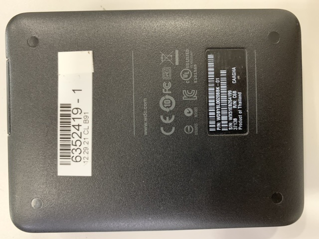

Hi Everyone,
Attaching Photos of PCB and external HDD
Sorry for the delay.

 Post subject: Re: Need Advice on Failed Recovery by Ontrack
PostPosted: June 29th, 2022, 17:04
Looks like a Firebird family, which could be a pain to get it working.
Donors have gotten difficult to find.
+1 pcimage (plus they have a donor stock of drives)
+ pepe
Either are great.
PostPosted: June 29th, 2022, 18:13
Posts: 4854
i have loads of these plus can recover rom if needed, plus can use any type of heads...
However, i do not like that naked cover, it actually sucks. Do you still have the label with you?
PostPosted: July 1st, 2022, 21:20
If that is the correct plastic shell, that model is usually a ShrekLT model WD20NMVW-11AV3S0 inside. At least that's what I've always documented finding in there on past cases I've handled. Much easier to find a donor for that than it is for a Firebird.
Recovery should still be possible unless there is severe platter damage. But, it's impossible to really know based on a report written by an Ontrack sales guy. It could very easily be just a case of someone being too lazy to investigate what the drive is given the missing label.
Get a second opinion from a reputable lab on here.
PostPosted: July 1st, 2022, 23:23
Posts: 1748
It's definitely a Shrek (4 platters / 8 heads)
I have received two cases (both are Shrek) which Ontrack claimed they're unrecoverable.
One has a ring on the upper side.
Both successfully recovered 65% and 95% respectively.
They always refuse such cases for unknown reasons.
