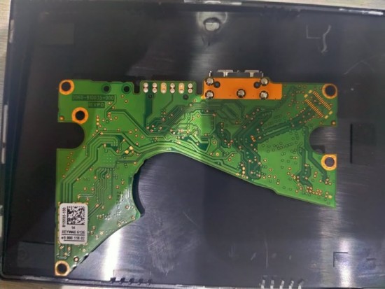

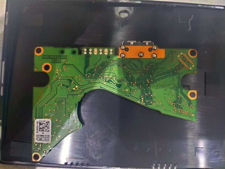

Sorry for the bad quality of the photos :

The photos are too small. Sorry.

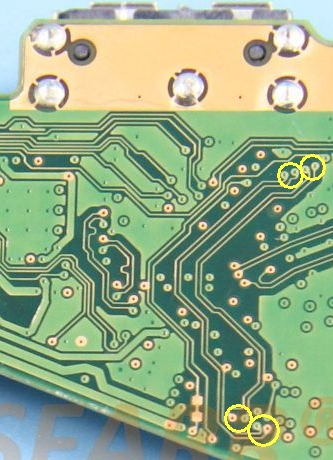

With the PCB removed from the HDA, measure the voltages at the indicated read/write channel test points (with respect to ground).
I expect that the read channel will measure 0V.

Thanks a lot Mr. Franc for your efforts. Much appreciated.
Case closed.
