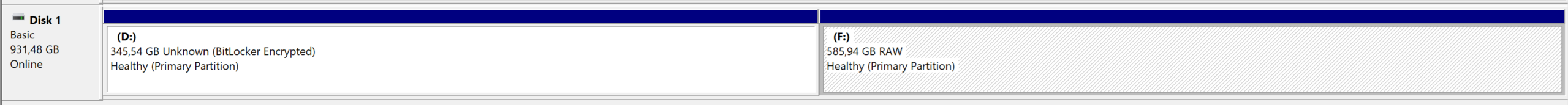

I can't even access Drive F because it has turned into a RAW drive. How can I solve this?. thanks

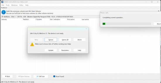

Show us a SMART report:
https://ww.reddit.com/r/datarecoverysoftware/wiki/index/smart/

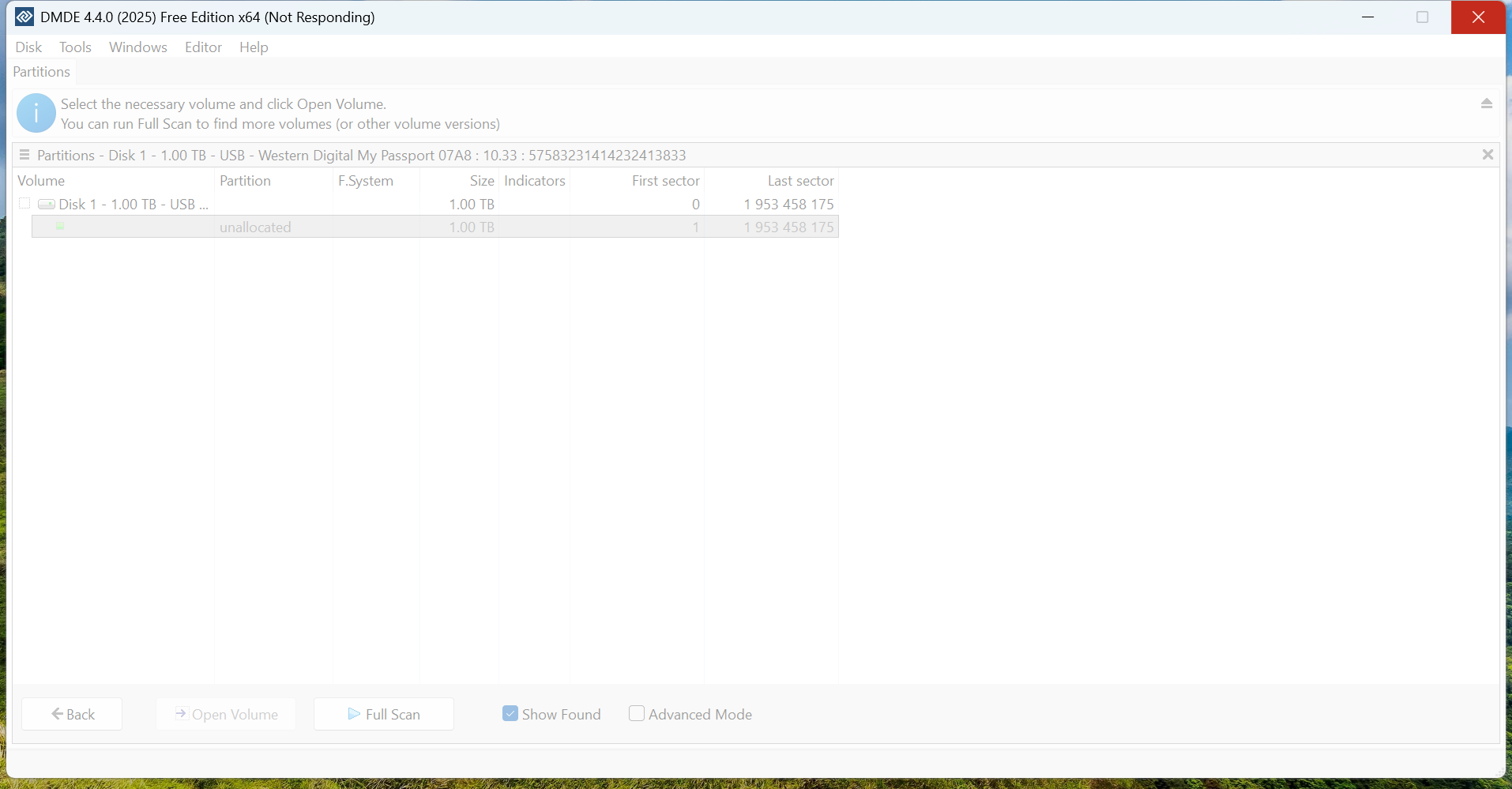

Show us the Partitions tab in DMDE:
https://dmde.com/

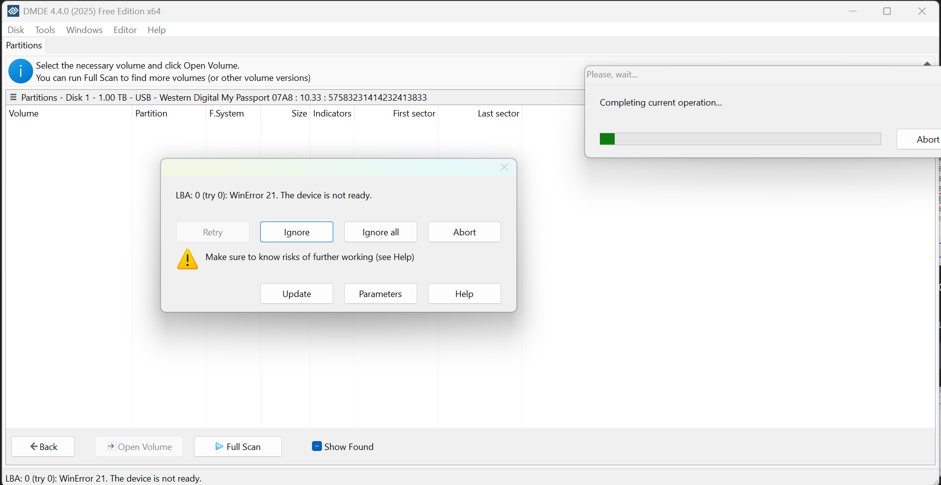

i cant complete the scan in DMDE. :cry:

in Disk Management It looks like this.

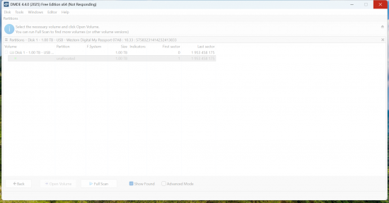

This is the DMDE partition and my computer is getting slower if i plug the HDD eksternal

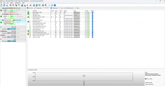

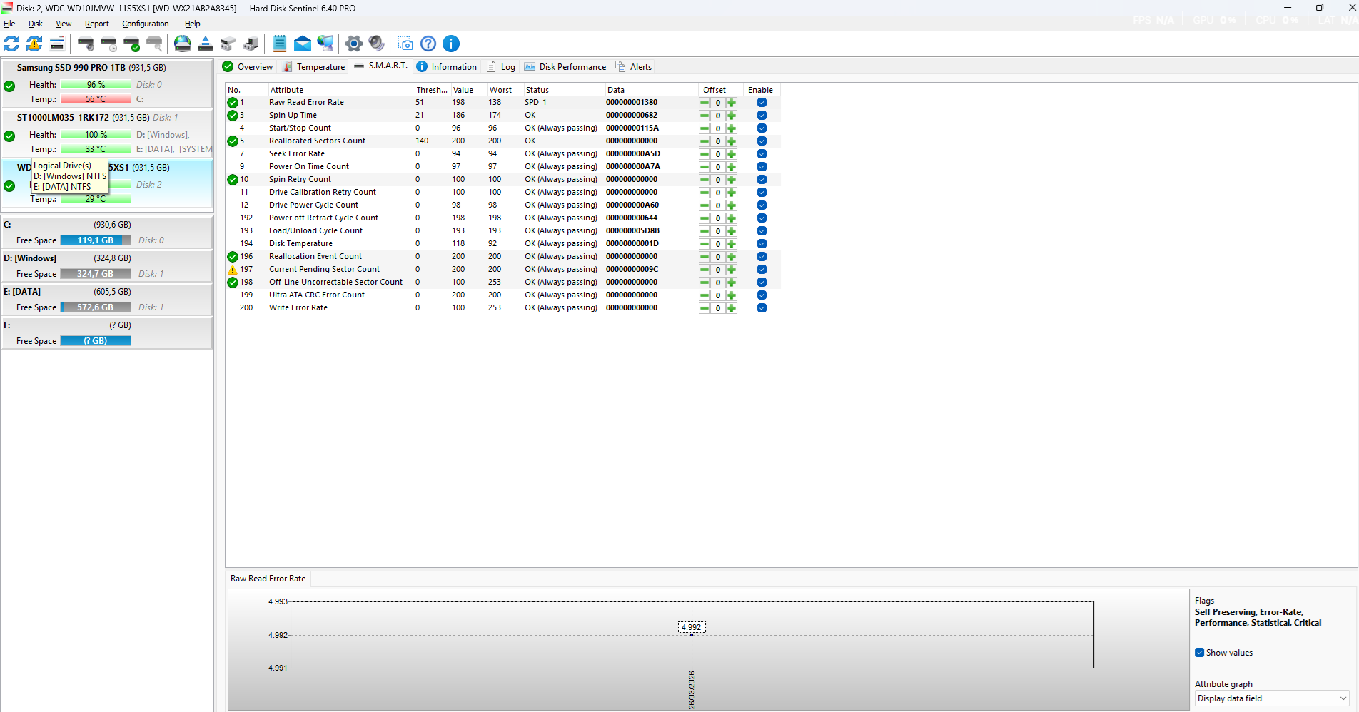

This is the SMART Report. thanks
File comment: This is the SMART Report
 Post subject: Re: Help HDD not showing storage size in Windows
PostPosted: March 26th, 2026, 15:21
Posts: 17314
Your drive is degraded. It is reporting read errors, seek errors, and pending sectors. Your best DIY approach would be to clone it and then work on the clone.
https://www.reddit.com/r/datarecoverysoftware/wiki/hddsuperclone_guide/

That old disk is pretty much at the end of the road, so find a new disk and copy what you can
