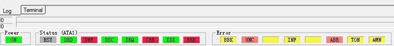

HDD: WD10SPZX-24Z10T0 F/W: 0012000T
I don't have unlocked PCB 800066 (Palmer)
used MRT 2.1.7.1(First) to unlock rom then wrote the unlocked ROM in PCB which had already Patched ROM (0005008J), but no spinup (locked ROM Spin)
Then i asked one friend who have PC3K to Patch the ROM, That also gives the same result.
Attached Original + Patched ROMs( MRT and PC3K)
WD10SPZX-24Z10T0.rar [1.75 MiB]
Downloaded 334 times
Then Tried with https://firmware.hddsurgery.com/dl.php? ... 7NKHF4.zip
It also gives the same result. Both Original ROMs SPIN , Both Patched ROM - Error with No SPIN
is anything wrong with Patched ROM
Unlocking Process works with 0005008J but not work with 0012000T

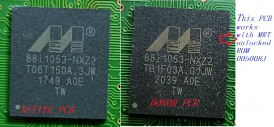

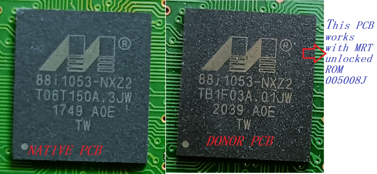

I have two PCBS both image
 Post subject: Re: WD10SPZX-24Z10T0 F/W: 0012000T Can't Unlock
PostPosted: August 16th, 2022, 12:45
Posts: 17335
There is a 3 year difference in the manufacture dates, but the "custom code or die revision" is A0 for both.

Started PCB only with One unlocked ROM 0050008J
Then wrote original Locked ROM (Write ROM) and saved ROM modules
Edited Head map to 01 only
on Power Reset get the same err as shown First Post image.
Any change in the ROM gives err
