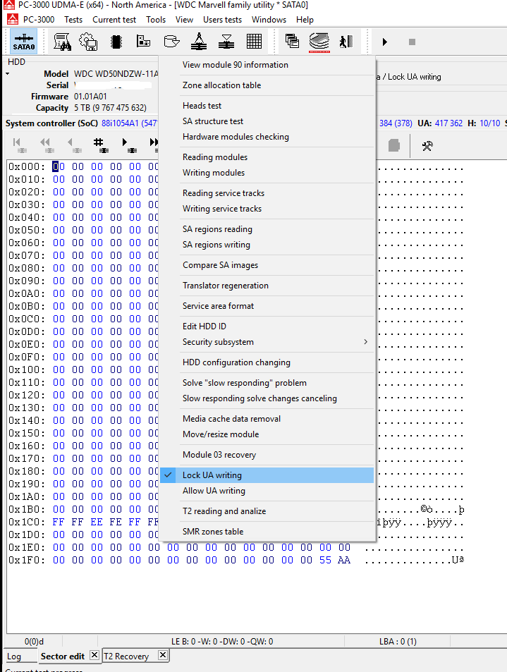

Slow Responding fix in RAM does occasionally work on SMR drives.

The problem on smr hdd is that 2nd level translator get changed (written) while we clone UA, this makes the drive slow... and could break 2nd translator.
The solution from AceLab is to lock writings on UA (at SA level), this will prevent changes on 2nd level translator, faster reading and keep alive weak heads.

That would be great if it worked. I have had 3 cases over the last few months where UA is locked and the secondary translator still gets corrupt.

I found where is located the lock UA option
is in the 190 module editing, that's the 2nd level translator module.

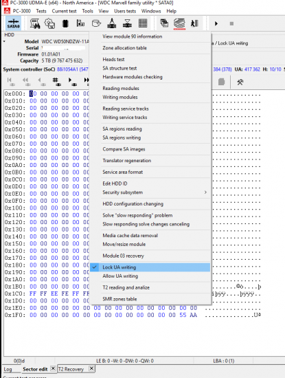

Quickest way to lock UA is via the SA menu.
