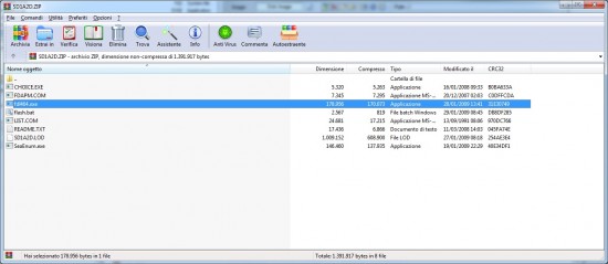

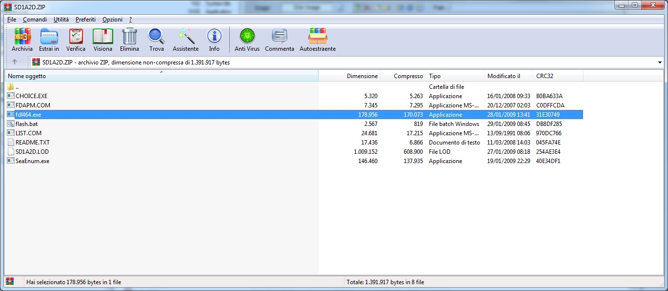

I'm looking for SD15 firmware for 2 platter Moose. I found only for 3 a and 4 platters. I need the version flashable with fdl464 (988 KB?)

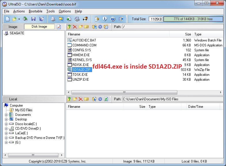

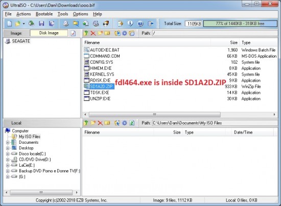

Use UltraISO to extract the boot file from the ISO (is simple, just open the the iso file in UltraISO and click on "Save Boot File" menĂ¹)
https://www.ultraiso.com/
Output file will be in BIF format (1,4 MB)
Now open it in UltraISO and extract the content into a folder inside the bootable key (folder name must be less than 8 characters, call it SD1A)
