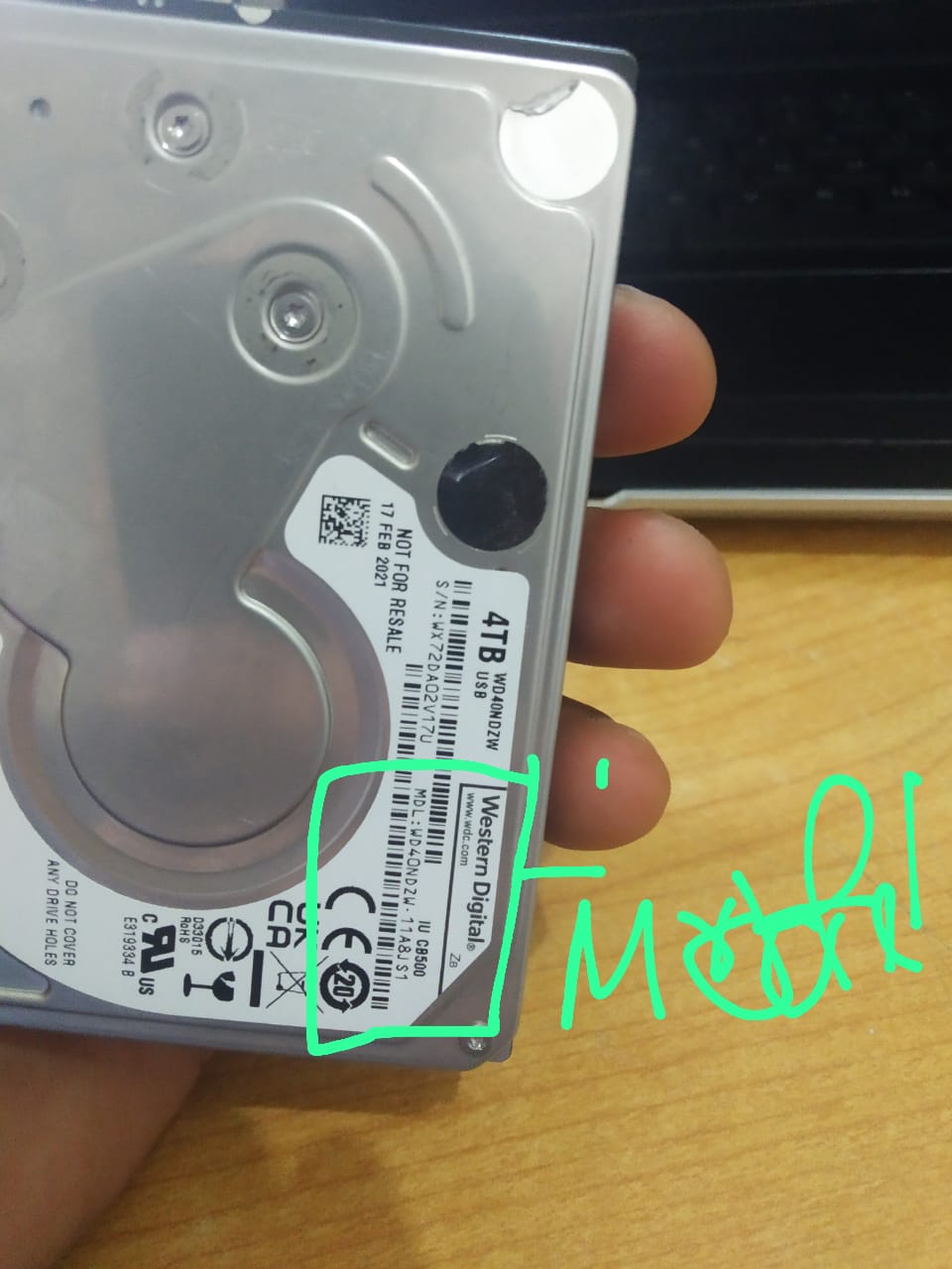

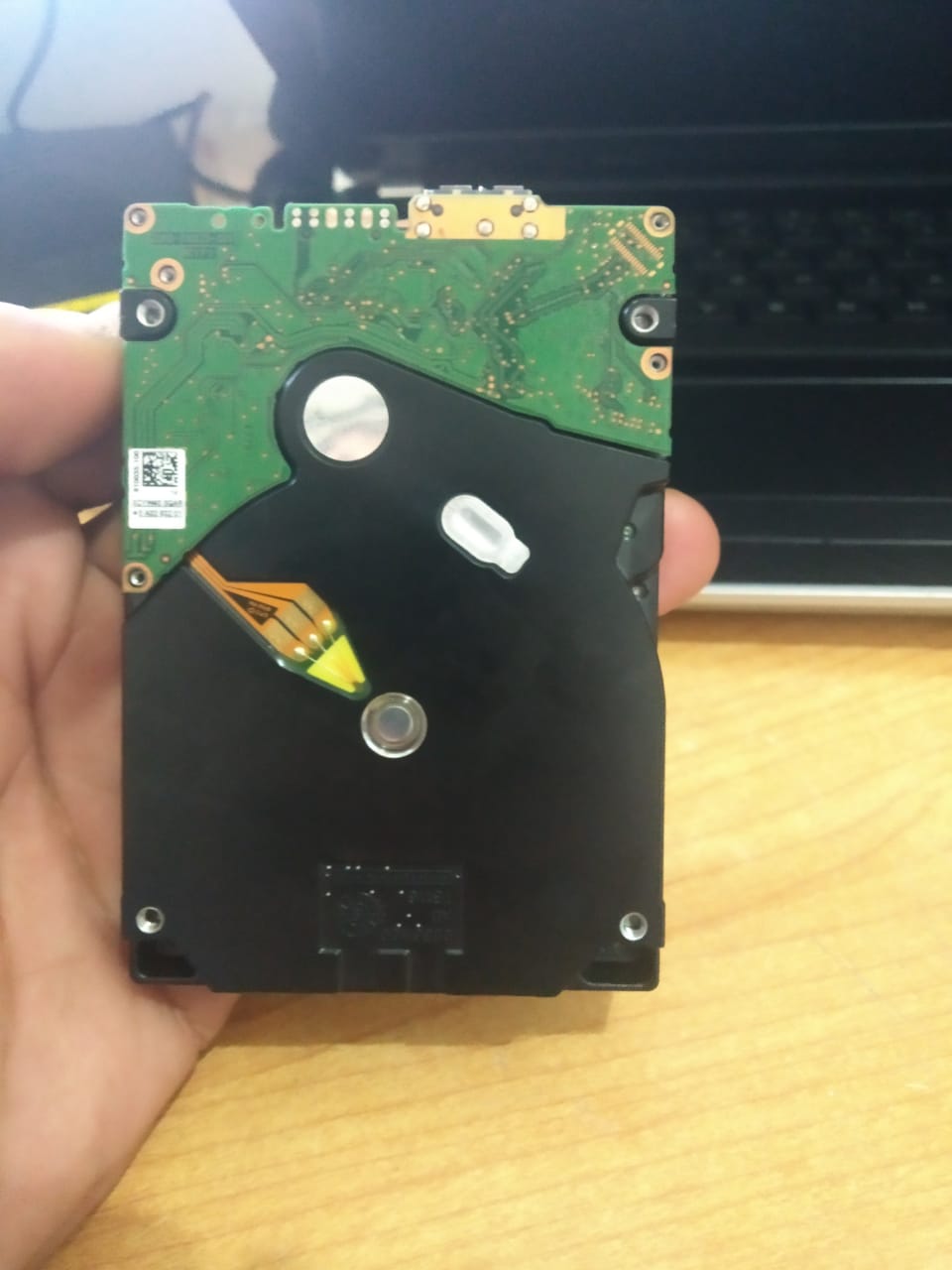

hello, im newbie in this forum. i wanna ask about replacing PCB from my WD My Passport.
does WD My Passport has the same PCB board ?
mine 4TB, wd40ndzw-11a8js1 (i opened the cover and saw the model)
im afraid if i bought the new one, hardrive inside the cover not the same type even tho its WD My Passport from the outside.
lets say if i got the same model but lower capacity ex. 1 TB. will it work ?
my hardrive error was USB Mulfunction and cannot be detected from bios, so im assuming that dying usb port on pcb causing it.

is this the donor or the patient? looks already opened....

Sorry, your drive is Spyglass2UL -- they're attached with the MCU of your PCB, you can't change the board. Well, you can, but you'll get encrypted data.
You can try and repair the board if that's possible, or you can convert USB to SATA if the problem is with the USB bridge.
HOWEVER
The biggest question is :
who opened the drive, how and why.

noticed that too, but he did not say anything about data, looks like he wants the drive back... which would be OK even if encrypted

If there is no power, check and reflow the solder at the zero-ohm resistor near the USB connector.
