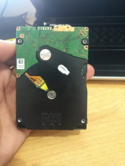

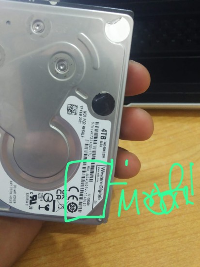

 Post subject: Replacing Died PCB from WD My Passport
PostPosted: January 30th, 2023, 0:13
Joined: January 29th, 2023, 23:59
Location: Indonesia
hello, im newbie in this forum. i wanna ask about replacing PCB from my WD My Passport.
does WD My Passport has the same PCB board ?
mine 4TB, wd40ndzw-11a8js1 (i opened the cover and saw the model)
im afraid if i bought the new one, hardrive inside the cover not the same type even tho its WD My Passport from the outside.
lets say if i got the same model but lower capacity ex. 1 TB. will it work ?
my hardrive error was USB Mulfunction and cannot be detected from bios, so im assuming that dying usb port on pcb causing it.
WhatsApp Image 2023-01-30 at 13.10.31.jpeg
WhatsApp Image 2023-01-30 at 13.10.31.jpeg [ 69.81 KiB | Viewed 8512 times ]
WhatsApp Image 2023-01-30 at 13.11.10.jpeg
WhatsApp Image 2023-01-30 at 13.11.10.jpeg [ 93.27 KiB | Viewed 8512 times ]
 Post subject: Re: Replacing Died PCB from WD My Passport
PostPosted: January 31st, 2023, 6:51
Posts: 4848
is this the donor or the patient? looks already opened....
 Post subject: Re: Replacing Died PCB from WD My Passport
PostPosted: January 31st, 2023, 7:03
Posts: 3551
Sorry, your drive is Spyglass2UL -- they're attached with the MCU of your PCB, you can't change the board. Well, you can, but you'll get encrypted data.
You can try and repair the board if that's possible, or you can convert USB to SATA if the problem is with the USB bridge.
HOWEVER
The biggest question is :
who opened the drive, how and why.
 Post subject: Re: Replacing Died PCB from WD My Passport
PostPosted: January 31st, 2023, 7:07
Posts: 4848
noticed that too, but he did not say anything about data, looks like he wants the drive back... which would be OK even if encrypted
 Post subject: Re: Replacing Died PCB from WD My Passport
PostPosted: January 31st, 2023, 13:00
Posts: 17323
my hardrive error was USB Mulfunction and cannot be detected from bios
If there is no power, check and reflow the solder at the zero-ohm resistor near the USB connector.
Users browsing this forum: Google [Bot] and 70 guests
