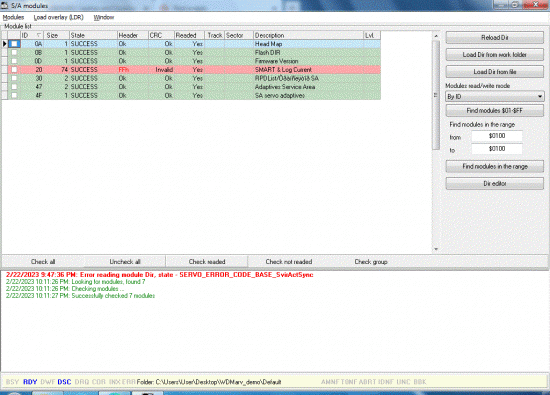

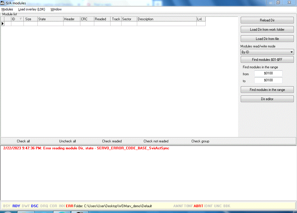

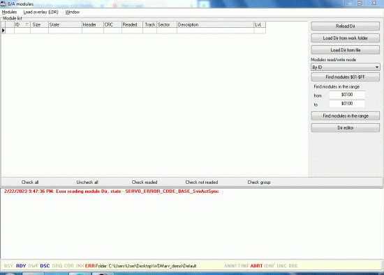

Thanks, was able to launch the tool in command prompt and read the built-in guide.
While using WDMarvel Demo to obtain the SA modules, despite already swapping out HDD heads, I still get this error message upon opening the S/A modules window:
File comment: Received SERVO_ERROR_CODE_BASE_SvirActSync despite swapping heads.

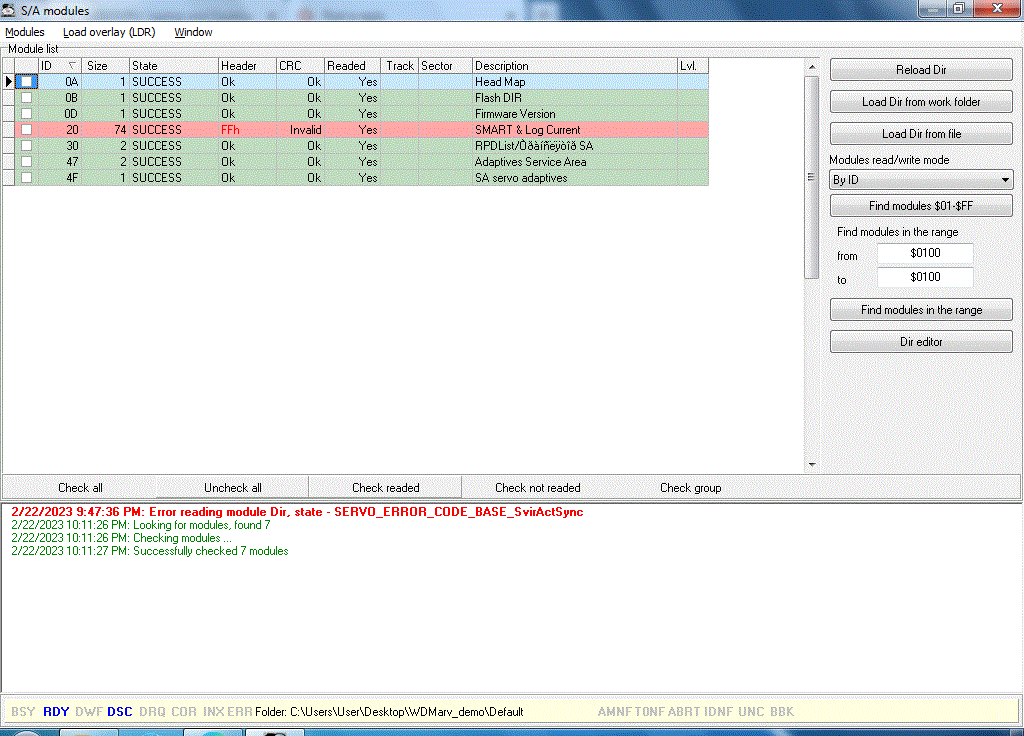

After running Modules > Check all modules, this is what I see:
File comment: All modules scanned successfully with module 20 indicating problems despite successful scan.
Would there be problems after dumping the SA modules including module 20 when I use the tool? Is it necessary for module 20 be "Ok"?

 Post subject: Re: Alternative ways to reflash ROM with SA-generated module
PostPosted: February 24th, 2023, 11:01
Posts: 4854
it is most probably head related. The modules marked green in the above screenshot come from the flash, 20 is on disk, as another 2-300 modules not even listed in your tool.
PostPosted: February 24th, 2023, 13:35
Posts: 17335
@transitNFCtech, you need to recover SA modules in the range from $0102 to $0109, from either head 0 or head 1. However, who knows what new problems have been introduced by your head swap.
