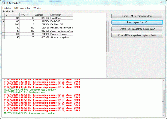

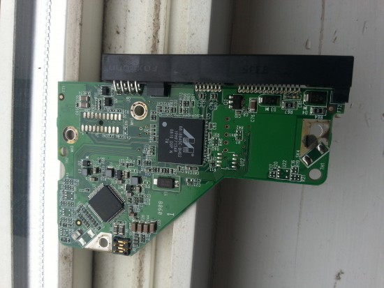

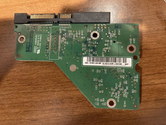

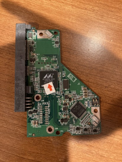

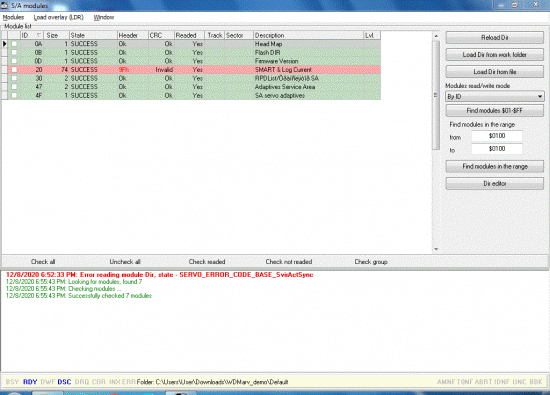

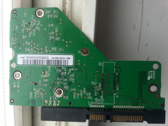

 Post subject: Cannot create ROM modules from SA modules
PostPosted: December 9th, 2020, 1:58
Joined: December 8th, 2020, 22:38
Posts: 30
Location: Canada
I'm currently having issues trying to rebuild my problem HDD's ROM after installing a new PCB to finish HDD repair. I'm currently using WDMarvel Demo so I'll know that reading SA modules for rebuilding ROM modules won't be an issue. However, this is what I see:
File comment: Result of reading copies from SA.
WDMarvel Demo - Issues with reading ROM modules from SA - 2nd attempt.GIF
WDMarvel Demo - Issues with reading ROM modules from SA - 2nd attempt.GIF [ 65.82 KiB | Viewed 10591 times ]
When I opened "Modules operations" under "S/A operations" and performed "Check all modules", this is what it found:
File comment: Modules found on SA
WDMarvel Demo - SA Modules found.GIF
WDMarvel Demo - SA Modules found.GIF [ 98.92 KiB | Viewed 10591 times ]
Now, how do I create ROM modules from SA modules at this point? Or should I rebuild the SA modules instead and if so, how? Or what should I do instead? Aside from the HDD, I only have an eSATA-SATA cable, an eSATA ExpressCard/34 adapter, and a laptop with an ExpressCard/54 slot.
Problem HDD Model: WD10EAVS-00D7B0 - HDD obtained from a WD My Book World Edition I (Blue Rings)
Laptop: HP Compaq nc6320
Laptop OS: Windows 7 Ultimate x64
eSATA adapter: GXT 2 Port Express Card SATA-II Adapter -
File comment: eSATA adapter manual
Manual.pdf [350.55 KiB]
Downloaded 531 times
 Post subject: Re: Cannot create ROM modules from SA modules
PostPosted: December 10th, 2020, 3:49
Posts: 849
Your HDD has bad heads so you can't do anything (exept ruine the drive).
 Post subject: Re: Cannot create ROM modules from SA modules
PostPosted: December 10th, 2020, 5:40
Joined: December 8th, 2020, 22:38
Posts: 30
Location: Canada
BGman wrote:
Your HDD has bad heads so you can't do anything (exept ruine the drive).
I should also mention this. Prior to frying the old PCB, the drive worked fine. There were no bad heads. Even after the new board is installed, I don’t hear any scraping sounds.
 Post subject: Re: Cannot create ROM modules from SA modules
PostPosted: December 10th, 2020, 15:11
Posts: 17335
When you "fried" the PCB, did it look like this?
Catastrophic failures in Western Digital PCBs:
http://www.hddoracle.com/viewtopic.php?f=59&t=1119
If so, then you may have damaged the preamp.
 Post subject: Re: Cannot create ROM modules from SA modules
PostPosted: December 10th, 2020, 15:19
Joined: December 8th, 2020, 22:38
Posts: 30
Location: Canada
When you "fried" the PCB, did it look like this?
Catastrophic failures in Western Digital PCBs:
http://www.hddoracle.com/viewtopic.php?f=59&t=1119
If so, then you may have damaged the preamp.
No, it doesn’t. MCU remained unharmed.
 Post subject: Re: Cannot create ROM modules from SA modules
PostPosted: December 13th, 2020, 15:15
Posts: 17335
Can you show us a photo of your PCBs (HDD and USB-SATA bridge)?
 Post subject: Re: Cannot create ROM modules from SA modules
PostPosted: December 13th, 2020, 18:01
Joined: December 8th, 2020, 22:38
Posts: 30
Location: Canada
Can you show us a photo of your PCBs (HDD and USB-SATA bridge)?
Sure!
Here's what the old PCB looks like:
File comment: Old PCB - Front
20200428_151755.jpg [ 2.26 MiB | Viewed 10175 times ]
File comment: Old PCB - Rear
20200428_151822.jpg [ 2.29 MiB | Viewed 10175 times ]
Here's what the new PCB looks like:
File comment: New PCB - Rear
IMG_0268.JPEG [ 1.04 MiB | Viewed 10175 times ]
File comment: New PCB - Front
IMG_0269.JPEG [ 1.21 MiB | Viewed 10175 times ]
