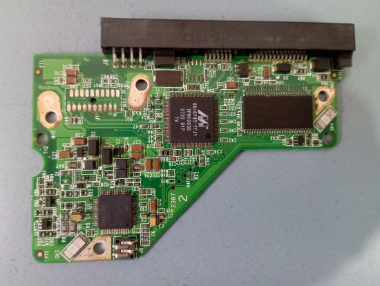

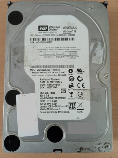

 Post subject: WD Donor PCB query
PostPosted: April 26th, 2023, 5:21
Posts: 548
Location: brisbane
I have got a WD 500AAJS (WD Caviar SE) hard disk. In PC3K it shows pcb short symptoms (all registers lit)
It is not spinning obviosuly pcb could be the issue. It has no physical rom present. I have more than 100 donor disks but none of them have similar pcb
(patient - 2060 -701477-002 Rev A) , all I have are 2060 -771640- XXXX) , will they compatible . Is there any way to repair PCB
IMG_20230426_143507.jpg [ 2.43 MiB | Viewed 5190 times ]
IMG_20230426_143528.jpg [ 3.3 MiB | Viewed 5191 times ]
 Post subject: Re: WD Donor PCB query
PostPosted: April 26th, 2023, 5:33
Posts: 1323
Couple of those caps don't look too healthy (76/37). Have you done the usual checks on the fuses & diodes and checked the voltages at the inductors.
 Post subject: Re: WD Donor PCB query
PostPosted: April 26th, 2023, 7:10
Joined: May 30th, 2005, 17:07
Posts: 550
Instead of 701477 you can only use 701444
Mikippp
 Post subject: Re: WD Donor PCB query
PostPosted: April 26th, 2023, 10:18
Posts: 548
Location: brisbane
Lardman wrote:
Couple of those caps don't look too healthy (76/37). Have you done the usual checks on the fuses & diodes and checked the voltages at the inductors.
Thanks Lardman :good: :-D
Yes fuses and diodes are ok but I have missed capacitors. I will check.
Last edited by terminator2 on April 26th, 2023, 10:24, edited 1 time in total.
 Post subject: Re: WD Donor PCB query
PostPosted: April 26th, 2023, 10:20
Posts: 548
Location: brisbane
Mikippp wrote:
Instead of 701477 you can only use 701444
Mikippp
Thanks Mikippp :good: :-D
I think I might be having at least one 701444 but how can I copy rom from patient to donor ?
 Post subject: Re: WD Donor PCB query
PostPosted: April 26th, 2023, 12:35
Joined: May 30th, 2005, 17:07
Posts: 550
Try reading the ROM with BootCode.
If it fails, upload to the donor PCB ROM from the Tornado disk and rebuild the ROM based on SA modules.
Mikippp
 Post subject: Re: WD Donor PCB query
PostPosted: April 27th, 2023, 1:11
Posts: 548
Location: brisbane
Mikippp wrote:
Try reading the ROM with BootCode.
If it fails, upload to the donor PCB ROM from the Tornado disk and rebuild the ROM based on SA modules.
Mikippp
Thanks Mikippp
 Post subject: Re: WD Donor PCB query
PostPosted: April 27th, 2023, 1:14
Joined: March 9th, 2017, 6:16
Posts: 127
Location: trinidad
Mikippp wrote:
Try reading the ROM with BootCode.
If it fails, upload to the donor PCB ROM from the Tornado disk and rebuild the ROM based on SA modules.
Mikippp
hi Mikippp
I have similar case pending for exactly same model. Customer has given disk to a pc repair shop and in experimentation they have lost original pcb.
IS it possible to recover data using non native pcb or rom ? or regenerate rom using Tornado donor pcb
Thank you
 Post subject: Re: WD Donor PCB query
PostPosted: April 27th, 2023, 2:25
Posts: 4854
yes, it is possible. With pc3k surely, not sure about the others, but i think it is also possible with a hex editor once you can access the fw and you know what to do with it.
 Post subject: Re: WD Donor PCB query
PostPosted: April 28th, 2023, 1:37
Joined: March 9th, 2017, 6:16
Posts: 127
Location: trinidad
pepe wrote:
yes, it is possible. With pc3k surely, not sure about the others, but i think it is also possible with a hex editor once you can access the fw and you know what to do with it.
Thanks a lot :good: , Your help will be useful for solving a pending case. I have PC3K but do not have 701444 PCB , where can I get model nos of compatible Tornado family disks and PCB nos. Will it be OK if Rev. A B C etc is mismatched
 Post subject: Re: WD Donor PCB query
PostPosted: April 28th, 2023, 1:39
Posts: 17335
I have written a tool to regenerate the ROM from SA modules.
http://users.on.net/~fzabkar/FreeBasic_W32/WD/wdROMreg.bas
http://users.on.net/~fzabkar/FreeBasic_W32/WD/wdROMreg.exe
 Post subject: Re: WD Donor PCB query
PostPosted: April 28th, 2023, 2:03
Joined: March 9th, 2017, 6:16
Posts: 127
Location: trinidad
WO that's Great , using this tool I can extract rom from mere firmware without pc3K ?
Wonderful . Appreciate your skillsets fzabkar :good: :good: :good: :-D
 Post subject: Re: WD Donor PCB query
PostPosted: April 28th, 2023, 3:15
Joined: May 30th, 2005, 17:07
Posts: 550
WD5000AAKS-00TMA0 2060-701477-001 REV A
WD5000AAKS-00YGA0 2060-701477-001 REV A
WD5000AAJS-00TKA0 2060-701477-001 REV A
WD5000AAJS-00YFA0 2060-701477-002 REV A
WD1600AAJS-00PSA0 2060-701444-002 REV A
Mikippp
 Post subject: Re: WD Donor PCB query
PostPosted: April 29th, 2023, 2:41
Joined: March 9th, 2017, 6:16
Posts: 127
Location: trinidad
Mikippp wrote:
WD5000AAKS-00TMA0 2060-701477-001 REV A
WD5000AAKS-00YGA0 2060-701477-001 REV A
WD5000AAJS-00TKA0 2060-701477-001 REV A
WD5000AAJS-00YFA0 2060-701477-002 REV A
WD1600AAJS-00PSA0 2060-701444-002 REV A
Mikippp
Thank You so much :good: :-D
Users browsing this forum: Majestic-12 [Bot] and 52 guests
