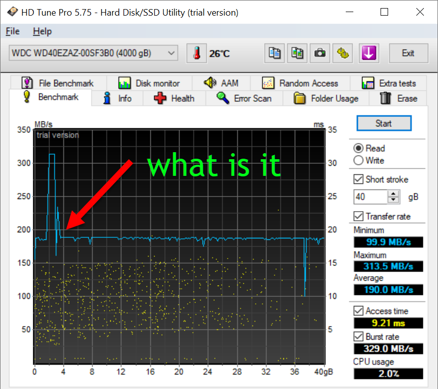

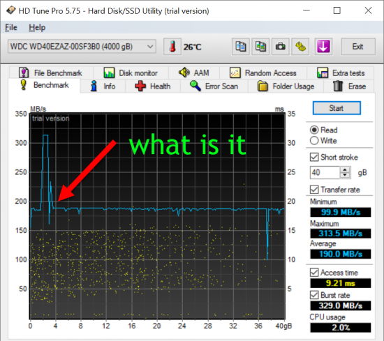

also please take the look at another hdd scan. two of WD Blue 4tb have similar graph
 Post subject: Re: WD Blue 4tb EZAZ ticking noice on start
PostPosted: May 14th, 2023, 5:30
Posts: 4854
You get such spikes where the LBA region is not allocated by T2. Drive does not read from surface there, only sends empty sectors to the host. This is done much faster than it can read from the surface, you see that there.

What I find strange is that there is no sign of serpentine zones, which suggests that all 40GB is being read from a single head, or that all heads are set to the same BPI.
PostPosted: May 15th, 2023, 15:12
Posts: 1768
Location: Verona, Italy
On smr drives head zones are very large.
Head map bulding in DE doesn't work as usual cmr drives, on smr head map is based on module 190.
two question - what is T2, second - are you saying that everything is working as intended?
PostPosted: May 16th, 2023, 8:22
Posts: 1768
T2: Second level translator
SMR drives need this type of dynamic translator which is included in module 190
