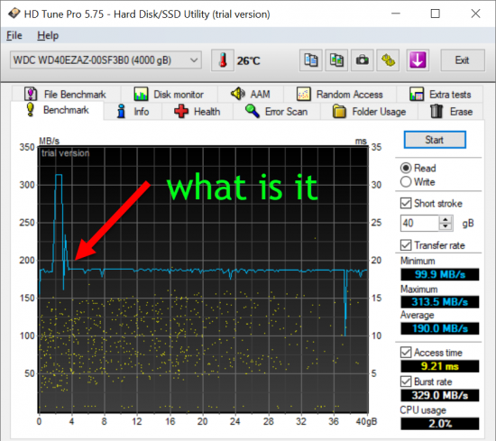

 Post subject: WD Blue 4tb EZAZ ticking noice on start
PostPosted: May 7th, 2023, 4:21
Joined: April 28th, 2023, 5:18
Posts: 27
Location: Russia
Hey there gurus,
Please observe this short video and let me know if this is sound of hopelessness.
https://www.veed.io/view/20cd2360-1dd9-422f-a1ba-c4b8b936d13e
Thanks.
P/S The drive used to work in good conditions exclusively on seldom and light reading operations. One day it started making this noice and has no detected in bios/os.
PP/S In fact i had five drives the same model all of them have failed withing two years, All of them was bought in China.
 Post subject: Re: WD Blue 4tb EZAZ ticking noice on start
PostPosted: May 8th, 2023, 7:19
Joined: August 24th, 2012, 8:15
Posts: 139
Location: Dominican Republic
Link didn't work HDD making sounds is never good, so power off and send pic of the LABEL to see the model and brand if 5 are dead those are bad HDD, maybe Seagate. :shock:
Data Recovery in the Dominican Republic
https://www.recuperamidata.com/
 Post subject: Re: WD Blue 4tb EZAZ ticking noice on start
PostPosted: May 8th, 2023, 7:40
Joined: April 28th, 2023, 5:18
Posts: 27
Location: Russia
Here is reposted one
https://www.veed.io/view/db597fcd-2531-4018-8c50-3aa4bceda7fd
what do you mean Seagate if they are WD? here is one WX32DC01K32A
 Post subject: Re: WD Blue 4tb EZAZ ticking noice on start
PostPosted: May 14th, 2023, 1:06
Joined: April 28th, 2023, 5:18
Posts: 27
Location: Russia
also please take the look at another hdd scan. two of WD Blue 4tb have similar graph
2023-05-14_7-47-12 - wd4ezaz scan.png
2023-05-14_7-47-12 - wd4ezaz scan.png [ 164.99 KiB | Viewed 5704 times ]
 Post subject: Re: WD Blue 4tb EZAZ ticking noice on start
PostPosted: May 14th, 2023, 5:30
Posts: 4854
You get such spikes where the LBA region is not allocated by T2. Drive does not read from surface there, only sends empty sectors to the host. This is done much faster than it can read from the surface, you see that there.
 Post subject: Re: WD Blue 4tb EZAZ ticking noice on start
PostPosted: May 15th, 2023, 15:02
Posts: 17341
What I find strange is that there is no sign of serpentine zones, which suggests that all 40GB is being read from a single head, or that all heads are set to the same BPI.
 Post subject: Re: WD Blue 4tb EZAZ ticking noice on start
PostPosted: May 15th, 2023, 15:12
Posts: 1768
Location: Verona, Italy
On smr drives head zones are very large.
Head map bulding in DE doesn't work as usual cmr drives, on smr head map is based on module 190.
My firmware database:
 Post subject: Re: WD Blue 4tb EZAZ ticking noice on start
PostPosted: May 16th, 2023, 7:39
Joined: April 28th, 2023, 5:18
Posts: 27
Location: Russia
pepe wrote:
You get such spikes where the LBA region is not allocated by T2. Drive does not read from surface there, only sends empty sectors to the host. This is done much faster than it can read from the surface, you see that there.
two question - what is T2, second - are you saying that everything is working as intended?
 Post subject: Re: WD Blue 4tb EZAZ ticking noice on start
PostPosted: May 16th, 2023, 8:22
Posts: 1768
Location: Verona, Italy
T2: Second level translator
SMR drives need this type of dynamic translator which is included in module 190
My firmware database:
 Post subject: Re: WD Blue 4tb EZAZ ticking noice on start
PostPosted: May 18th, 2023, 3:52
Joined: April 28th, 2023, 5:18
Posts: 27
Location: Russia
michael chiklis wrote:
T2: Second level translator
SMR drives need this type of dynamic translator which is included in module 190
could you explain it a bit more? what is T2 exactly, how can i manage it, should i be bothered to manage it, what is module 190?
thanks!
 Post subject: Re: WD Blue 4tb EZAZ ticking noice on start
PostPosted: May 18th, 2023, 4:41
Posts: 488
Location: US
https://www.blizzarddr.com/wd-smr-trans ... ad-blocks/
 Post subject: Re: WD Blue 4tb EZAZ ticking noice on start
PostPosted: May 18th, 2023, 5:42
Joined: April 28th, 2023, 5:18
Posts: 27
Location: Russia
thanks for try but not really helping :roll:
just please tell me if SMR disks are good for data storage in long term? with bearing in mind of extremely seldom write operations.
is there other reason i should get rid of all my SMR drives?
i like they are cold, silent and with low wattage
 Post subject: Re: WD Blue 4tb EZAZ ticking noice on start
PostPosted: May 21st, 2023, 11:49
Joined: April 28th, 2023, 5:18
Posts: 27
Location: Russia
hello? anybody?
