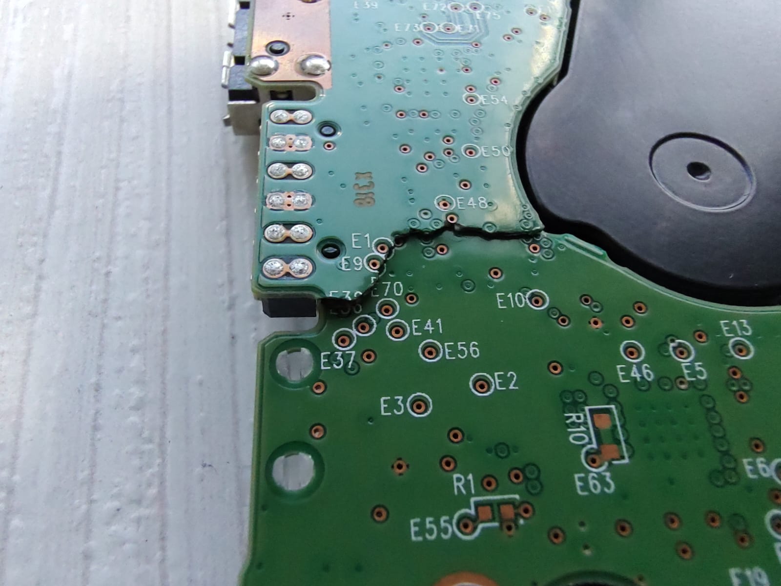

Hello guys, good day. I have here a complex case. Already had lots of Charger successful recovery here, but never got a broken original PCB.
How would you guys deal with a case like this, considering the original PCB encryption on those models?
Thank you for any answer

I would simply glue it with epoxy

pepe, sorry for asking you that, but if hypothetically there was a missing fragment of the PCB, recovery would be impossible for this family?
Thank you so much for all your help.

Not really complex...unless you have heads compromised as well(due to fall?). Take a SATA Equivalent laptop HDD pcb....remove MCU of the patient and solder it on the sata pcb(ofcourse remove donor pcb mcu aswell)
Either do it the stencil way or via manual re-balling https://youtu.be/mpFPxUoHELg
it takes about 1hr 18 mins or so for manual re-balling 240balls if i got the count correct :)
easy pizy :D

He was joking ...

yeah, joking of course. I can't see any other solution than swapping the MCU.

Looks more like technician pry damage to me... just hope it wasn't inhouse.
