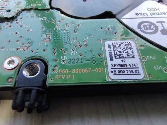

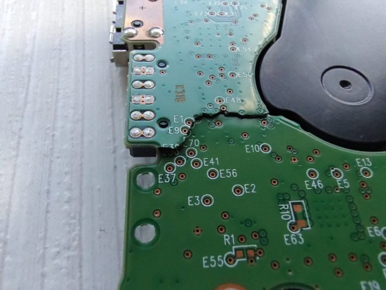

 Post subject: WD Charger - Broken PCB
PostPosted: May 25th, 2023, 10:05
Joined: October 20th, 2017, 9:14
Posts: 124
Location: Brazil
Hello guys, good day. I have here a complex case. Already had lots of Charger successful recovery here, but never got a broken original PCB.
How would you guys deal with a case like this, considering the original PCB encryption on those models?
Thank you for any answer
405a6dbd-0b10-4440-9cbf-d75c18f74f56.jpeg [ 176.36 KiB | Viewed 6423 times ]
WhatsApp Image 2023-05-25 at 11.00.46.jpeg
WhatsApp Image 2023-05-25 at 11.00.46.jpeg [ 147.81 KiB | Viewed 6423 times ]
 Post subject: Re: WD Charger - Broken PCB
PostPosted: May 25th, 2023, 11:40
Posts: 4854
I would simply glue it with epoxy
 Post subject: Re: WD Charger - Broken PCB
PostPosted: May 25th, 2023, 13:26
Joined: October 20th, 2017, 9:14
Posts: 124
Location: Brazil
pepe, Well... that is really an odd solution. Already got it done?
 Post subject: Re: WD Charger - Broken PCB
PostPosted: May 25th, 2023, 14:24
Joined: October 20th, 2017, 9:14
Posts: 124
Location: Brazil
pepe, sorry for asking you that, but if hypothetically there was a missing fragment of the PCB, recovery would be impossible for this family?
Thank you so much for all your help.
 Post subject: Re: WD Charger - Broken PCB
PostPosted: May 25th, 2023, 16:22
Posts: 456
Not really complex...unless you have heads compromised as well(due to fall?). Take a SATA Equivalent laptop HDD pcb....remove MCU of the patient and solder it on the sata pcb(ofcourse remove donor pcb mcu aswell)
Either do it the stencil way or via manual re-balling https://youtu.be/mpFPxUoHELg
it takes about 1hr 18 mins or so for manual re-balling 240balls if i got the count correct :)
easy pizy :D
 Post subject: Re: WD Charger - Broken PCB
PostPosted: May 25th, 2023, 18:13
Posts: 17341
parmindo wrote:
pepe, sorry for asking you that, but if hypothetically there was a missing fragment of the PCB, recovery would be impossible for this family?
Thank you so much for all your help.
He was joking ...
 Post subject: Re: WD Charger - Broken PCB
PostPosted: May 26th, 2023, 1:09
Posts: 4854
yeah, joking of course. I can't see any other solution than swapping the MCU.
 Post subject: Re: WD Charger - Broken PCB
PostPosted: May 26th, 2023, 2:58
Posts: 1323
sin wrote:
Not really complex...unless you have heads compromised as well(due to fall?)
Looks more like technician pry damage to me... just hope it wasn't inhouse.
 Post subject: Re: WD Charger - Broken PCB
PostPosted: May 26th, 2023, 7:47
Posts: 456
Lardman wrote:
sin wrote:
Not really complex...unless you have heads compromised as well(due to fall?)
Looks more like technician pry damage to me... just hope it wasn't inhouse.
I was just giving a benefit of doubt.
It's a mean industry where people try to monopolize over data... "None! if not me" is the concept. Life goes on.
 Post subject: Re: WD Charger - Broken PCB
PostPosted: May 26th, 2023, 8:31
Joined: October 20th, 2017, 9:14
Posts: 124
Location: Brazil
pepe, fzabkar, Sorry guys.. lots going on here and I'm not used to this.
Thank you all so much for all your insertions. I'll be training hard with irrelevant similar drives before offering this to my customers.
Thanks a lot.
 Post subject: Re: WD Charger - Broken PCB
PostPosted: May 26th, 2023, 11:41
Joined: October 20th, 2017, 9:14
Posts: 124
Location: Brazil
Lardman wrote:
Looks more like technician pry damage to me... just hope it wasn't inhouse.
Customer sent me this way, saying that one employee that works for him had a psychotic break and did this damage
 Post subject: Re: WD Charger - Broken PCB
PostPosted: May 26th, 2023, 13:34
Posts: 456
parmindo wrote:
pepe, fzabkar, Sorry guys.. lots going on here and I'm not used to this.
Thank you all so much for all your insertions. I'll be training hard with irrelevant similar drives before offering this to my customers.
Thanks a lot.
yes sir...practice atleast 3 - 4 times....its fun
cheers
 Post subject: Re: WD Charger - Broken PCB
PostPosted: May 29th, 2023, 12:38
sin wrote:
parmindo wrote:
pepe, fzabkar, Sorry guys.. lots going on here and I'm not used to this.
Thank you all so much for all your insertions. I'll be training hard with irrelevant similar drives before offering this to my customers.
Thanks a lot.
yes sir...practice atleast 3 - 4 times....its fun
cheers
Sin ,
Thats Too Many Balls :lol: ,Use a Stencil Buddy
 Post subject: Re: WD Charger - Broken PCB
PostPosted: May 30th, 2023, 10:20
Posts: 456
stencil or no stencil. Be like Rambo :)
