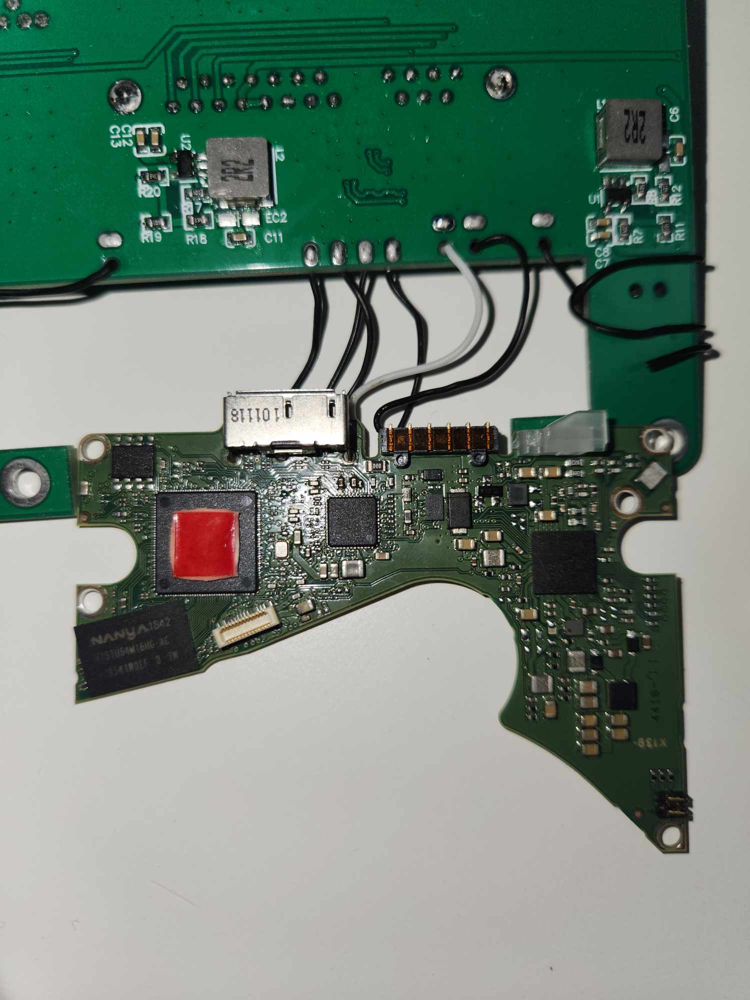

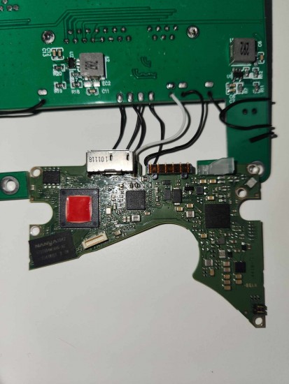

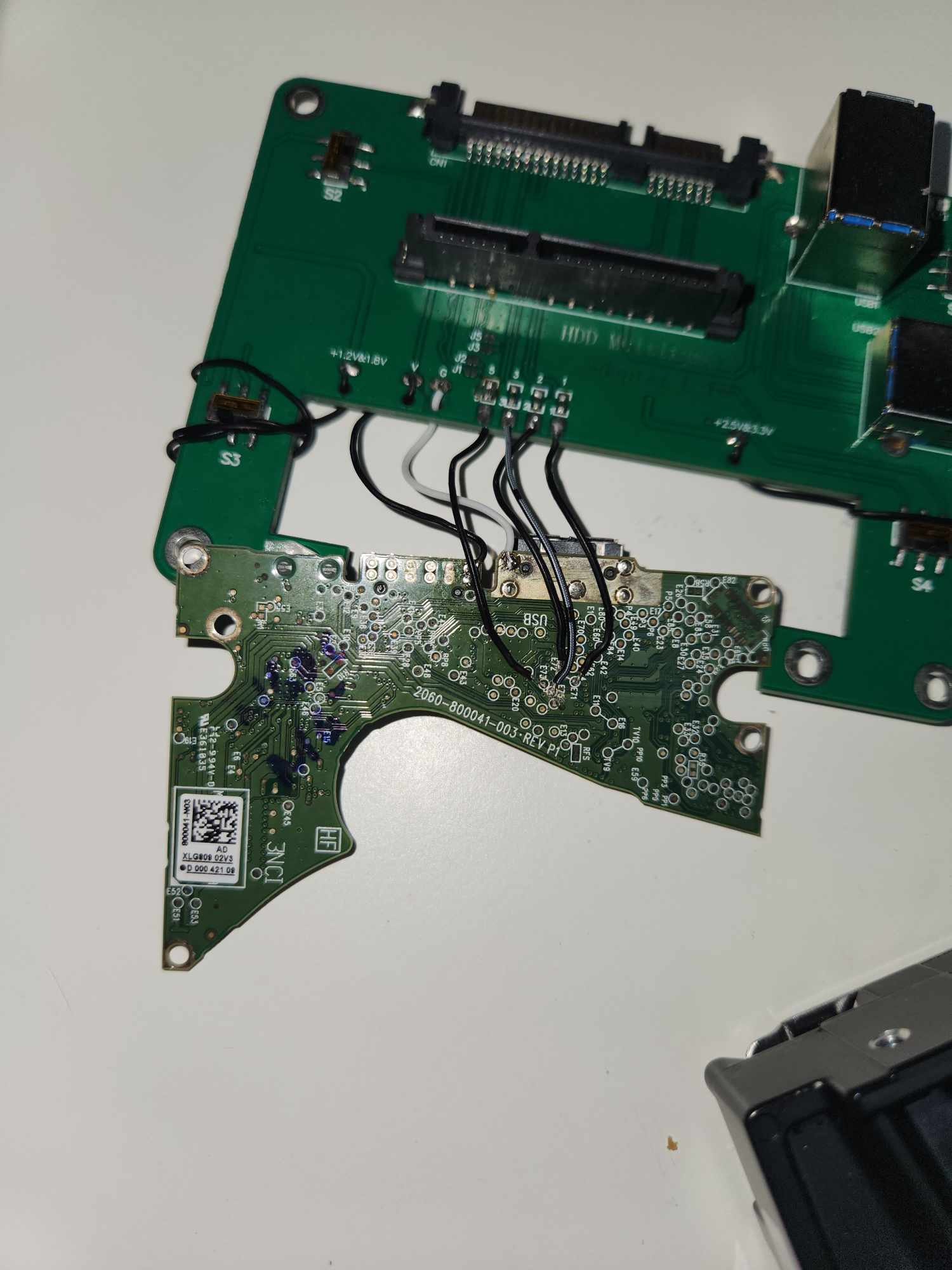

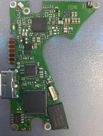

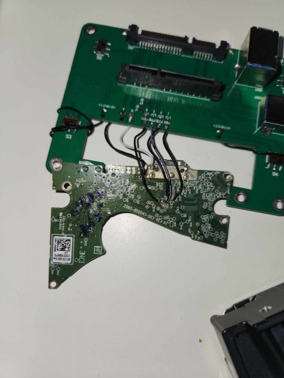

I got a 4TB My Passport Drive from WD. That doesn't show any sign of life on the PCB. The USB connector is fine. I soldered a Sata connection to test the PCB. There is 0 amps drawn on 5v rail
I wanted to know if someone could provide me with crucial measuring points, components and voltage rails of this PCB
Many Thanks!

measure the 000 ohm resistor in between the 2 connectors with a multimeter, diode/continuity check mode. it should beep.
 Post subject: Re: WD 4TB My Passport PCB doesn't have power? 2060-800041-0
PostPosted: March 5th, 2024, 6:57
Posts: 17228
It probably will beep. The usual fault is dry solder joints at each end of the resistor, not the resistor itself. Reflowing the solder should fix the problem.

Some of these PCBs have a key in the MCU, so that means you need to transfer the MCU as well as the ROM.
To answer your original question, here are the test points:
https://web.archive.org/web/20210614193827/http://www.users.on.net/~fzabkar/HDD/WD40NDZW_TVS_diode_fuse.jpg
https://web.archive.org/web/20230730202427/http://www.users.on.net/~fzabkar/HDD/WD40NDZW_bridge_Vcore.jpg
https://web.archive.org/web/20220113231223/http://www.users.on.net/~fzabkar/HDD/WD40NDZW_regs.jpg

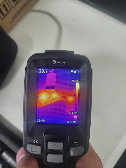

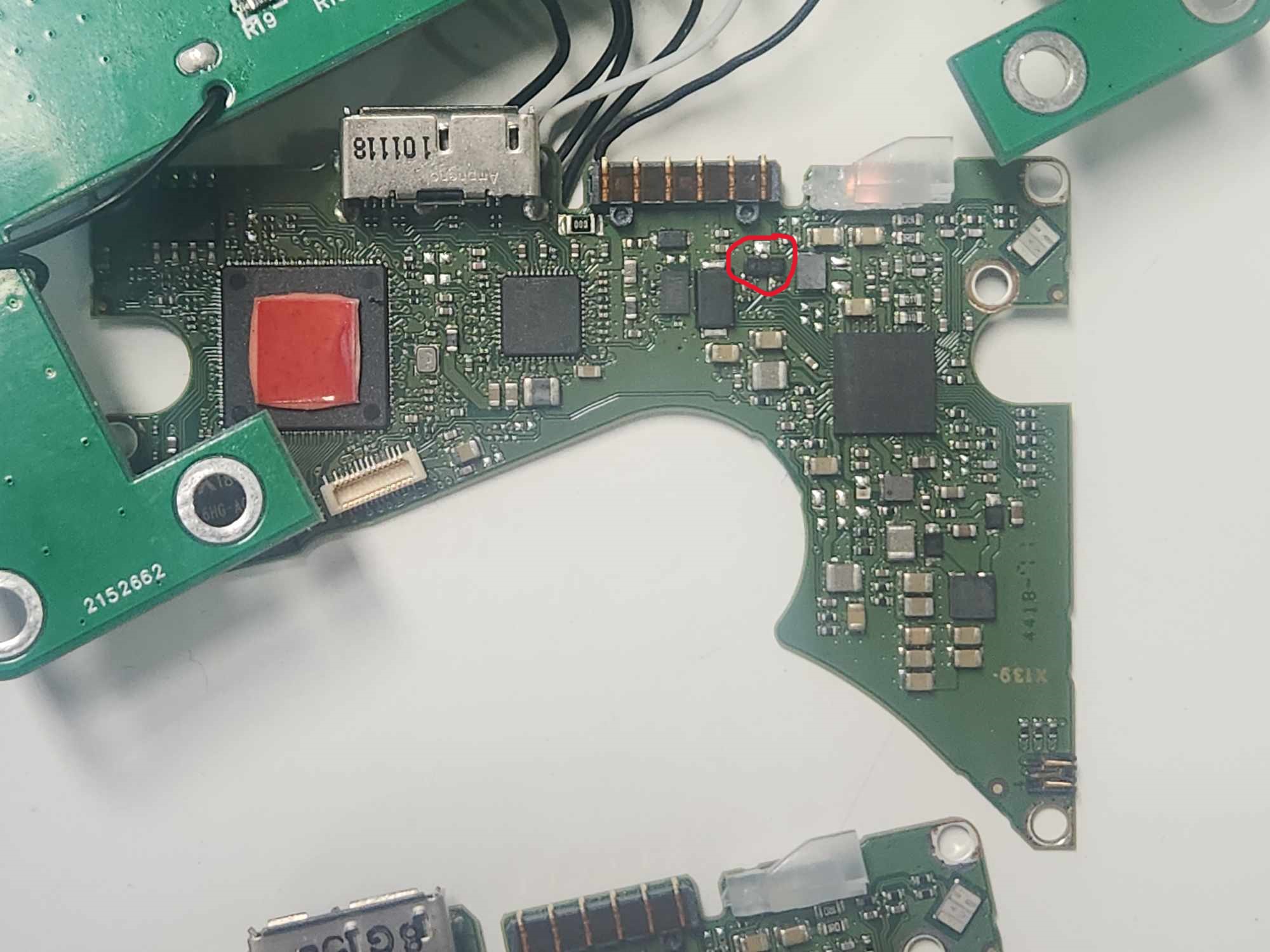

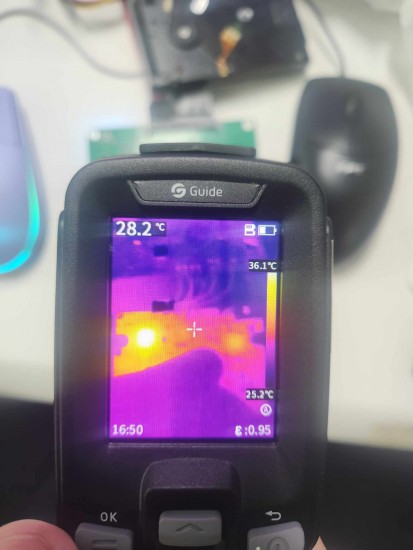

Okay. So i measured all the points in 3 pictures as well as the 0 Ohm resistor. all of them seems fine
I measured across 1 donner working board.
There are 3 things

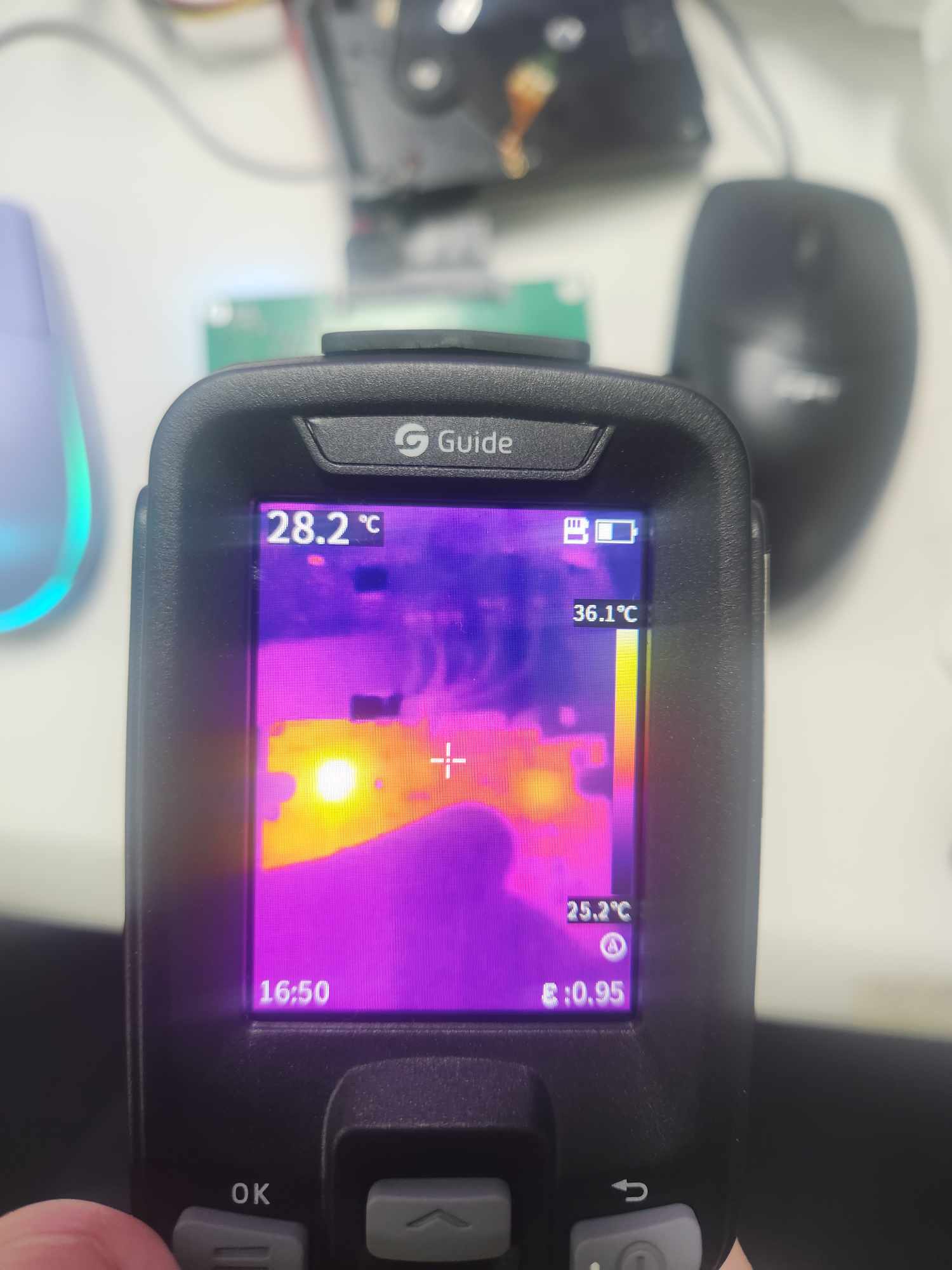

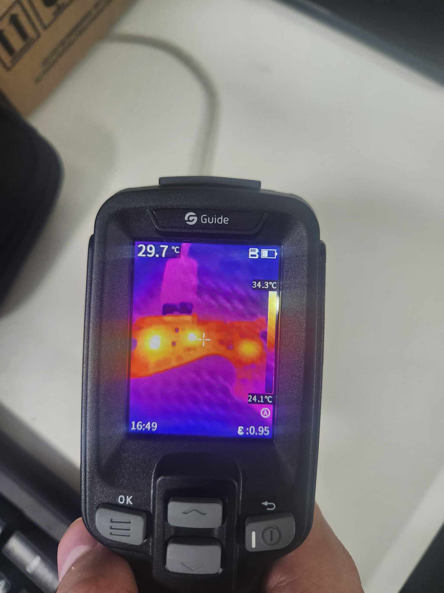

1st, i tested heat spot from the donor board vs the broken board. It seems missing the heat from the SATA controller. Means the voltage is not getting there

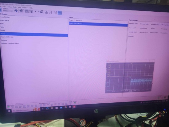

2nd, upon turning the broken PCB board on the LED light lights up but very DIM. Not bright as the working one. The PC3000 showing jumping amps between 16-20 on 5v and the PCB stayed BSY
3rd, i did found a W1P 87 transistor that shows different measurements i guess it might be the culprit or maybe the SATA controller itself. I will try swapping them over. Hope for the best
If anyone have any ideas please let me know
Many thanks!!!

File comment: Non working PCB heat spots
431076752_390038943875079_3364916298629566556_n.jpg [ 137.49 KiB | Viewed 8175 times ]
File comment: Working PCB Heat Spots
430433189_1521515428415491_275423114085729135_n.jpg [ 129.13 KiB | Viewed 8175 times ]

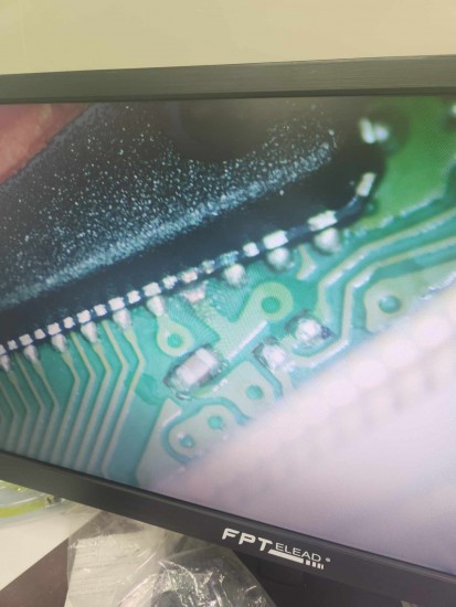

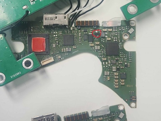

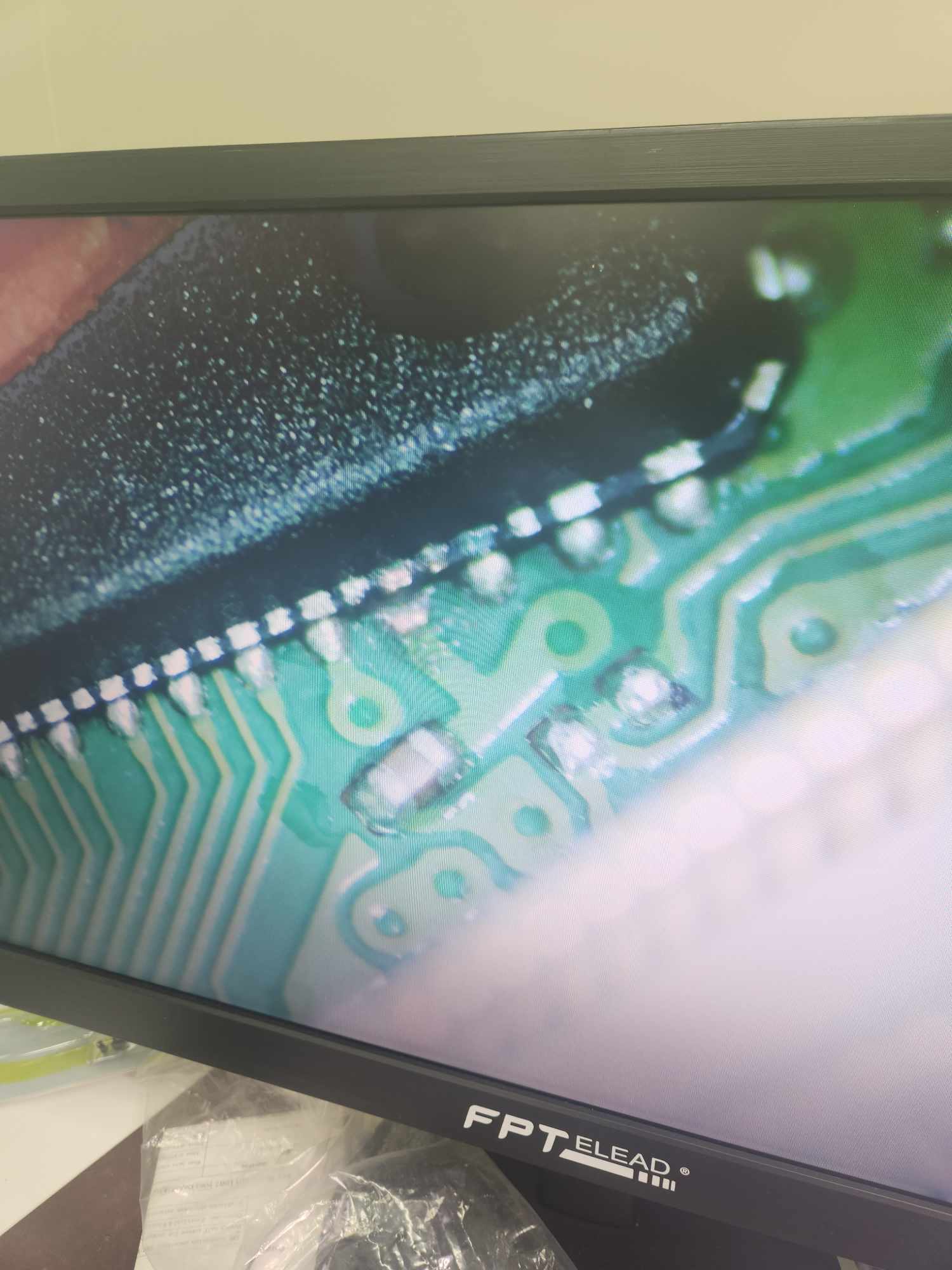

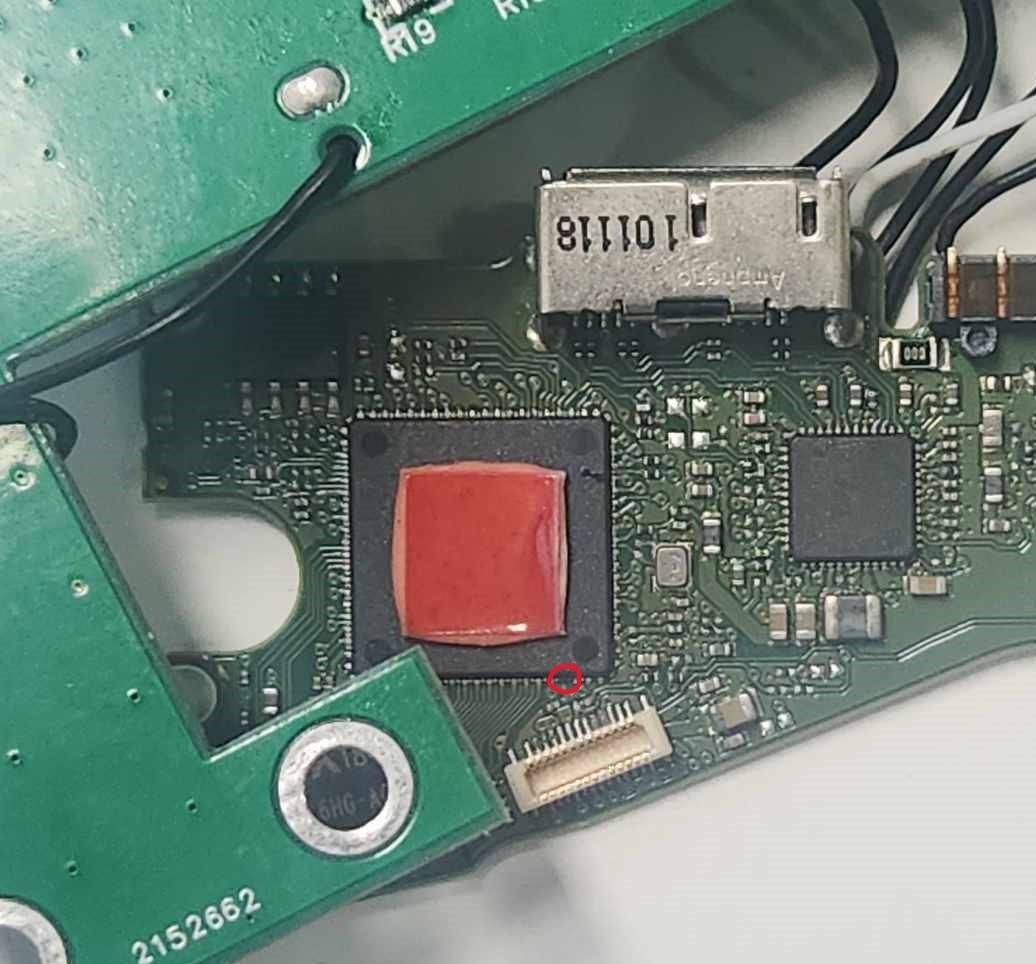

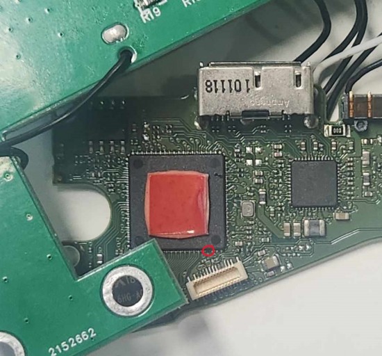

New findings. So apparently the LED is fried that's why the Transistor has different measurements. Swapped the LED now shines bright
I found a broken trace at the MCU that maybe the cause of this. Trying to solder those points but haven't got luck cause the points are small
427154482_1056682495419450_1770902453019812534_n.jpg [ 150.04 KiB | Viewed 8161 times ]
431145048_382015634563121_6467742487815195774_n.jpg [ 164.69 KiB | Viewed 8161 times ]

A broken solder joint wont be the source of a short - nice catch though.
If you're struggling with soldering and can't justify the JVC kit (who can) an Axium T115 station is cheap enough and will have no problems at that scale with decent optics.

- So I measured all components but found no short on the board. Does it mean that the only thing can go bad is the SATA Controller chip???
- I will find a way to solder that. Just not at the time when i was writing the comment :P just a little bit of struggling :P
A little off on the scale there. 150-200mA could be standard drawn on the board, check with a donor. Assuming you've reflowed that troublesome resistor that sort of pattern is usually an IC failing to start and whilst your thermal camera show "hot spot" these aren't hot enough not to be normal operation. Given all the major IC's appear to be getting power I'd start looking at enable signals but check your voltage rails anyway. Also look at the pcb on edge - is it flat ?

Just FYI, a transistor is often used to drive a device whose current requirements are greater than that which can supplied by the MCU or bridge.
    MCU I/O pin --> transistor --> LED
http://markingcodes.com/search/c/W1P
PMBT2222A, NXP, NPN switching transistor, 40V, 600mA, marking *1P, SOT23:
https://datasheet.lcsc.com/lcsc/1811141239_Nexperia-PMBT2222A-215_C23869.pdf
Have you dumped the MCU ROM? Perhaps it is corrupt? I have written a tool to check its consistency.
BTW, did you measure the voltage on that MCU pin to confirm that the trace is indeed open?
