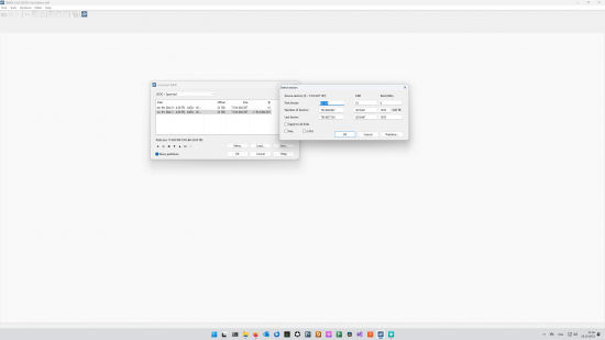

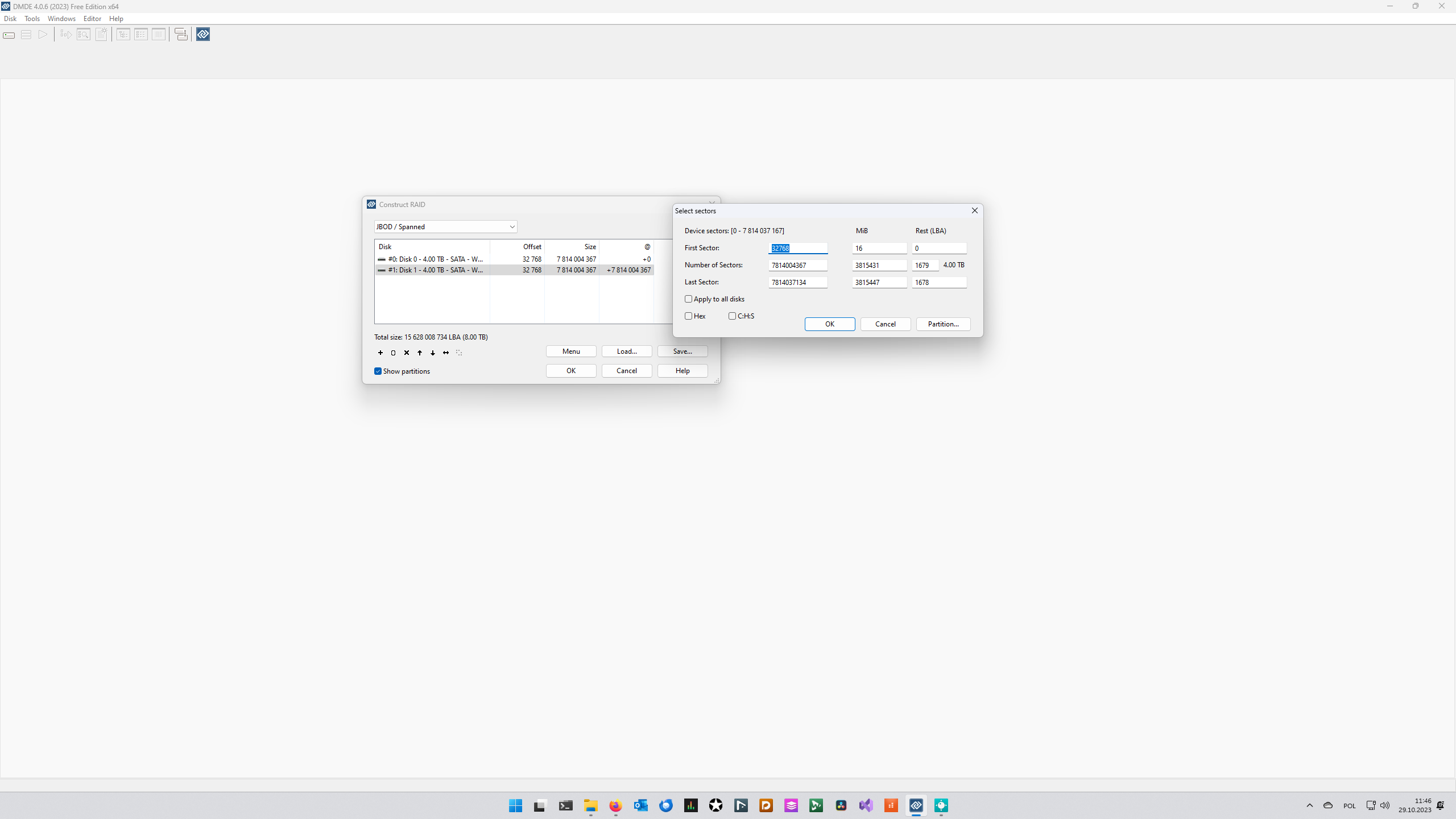

Hi all!

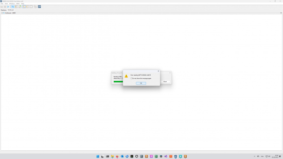

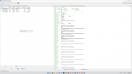

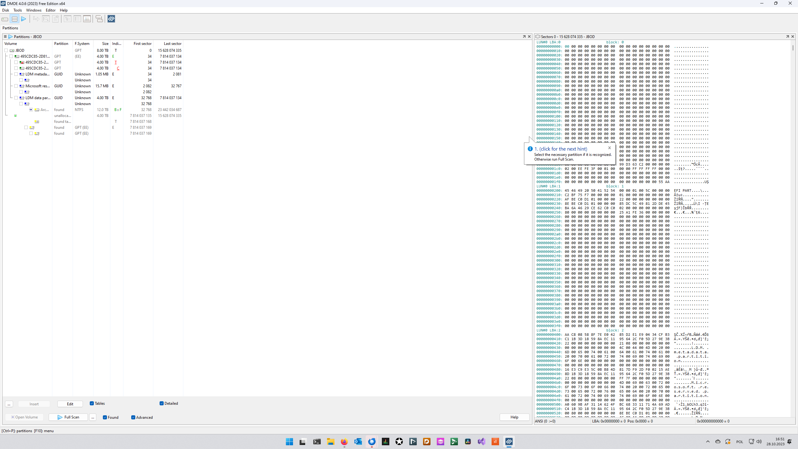

I have a Windows spanned volume on my 3 WD 4 TB hard drives. Unfortunately, when I connected them to make a backup of recent content, the last one (which should be empty/nearly empty) failed.
Now I'm trying to assemble this volume in DMDE to copy my data to a backup drive, but after trying to construct RAID > JBOD and adding my 2 drives, I have this result. I can open this volume ("Archiwum") and it shows the whole FS but only files from the first drive are visible. (adding a NULL disk as the 3rd disk make the same result)
Thank you for help! :) :oops:

If you used Windows to create the span I suppose you spanned partitions and so for example offset will not be zero.
Add partition TAB screenshots for both individual drives.
Yeah, it would even with only first drive attached.

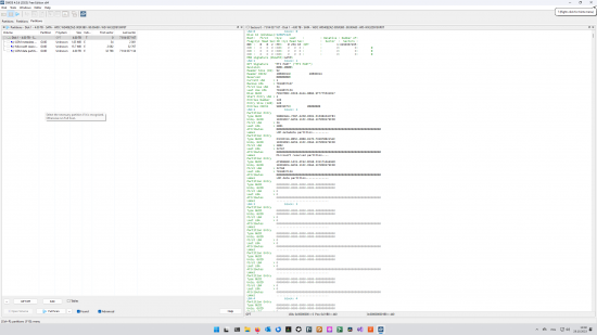

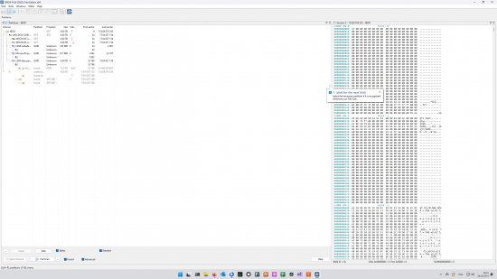

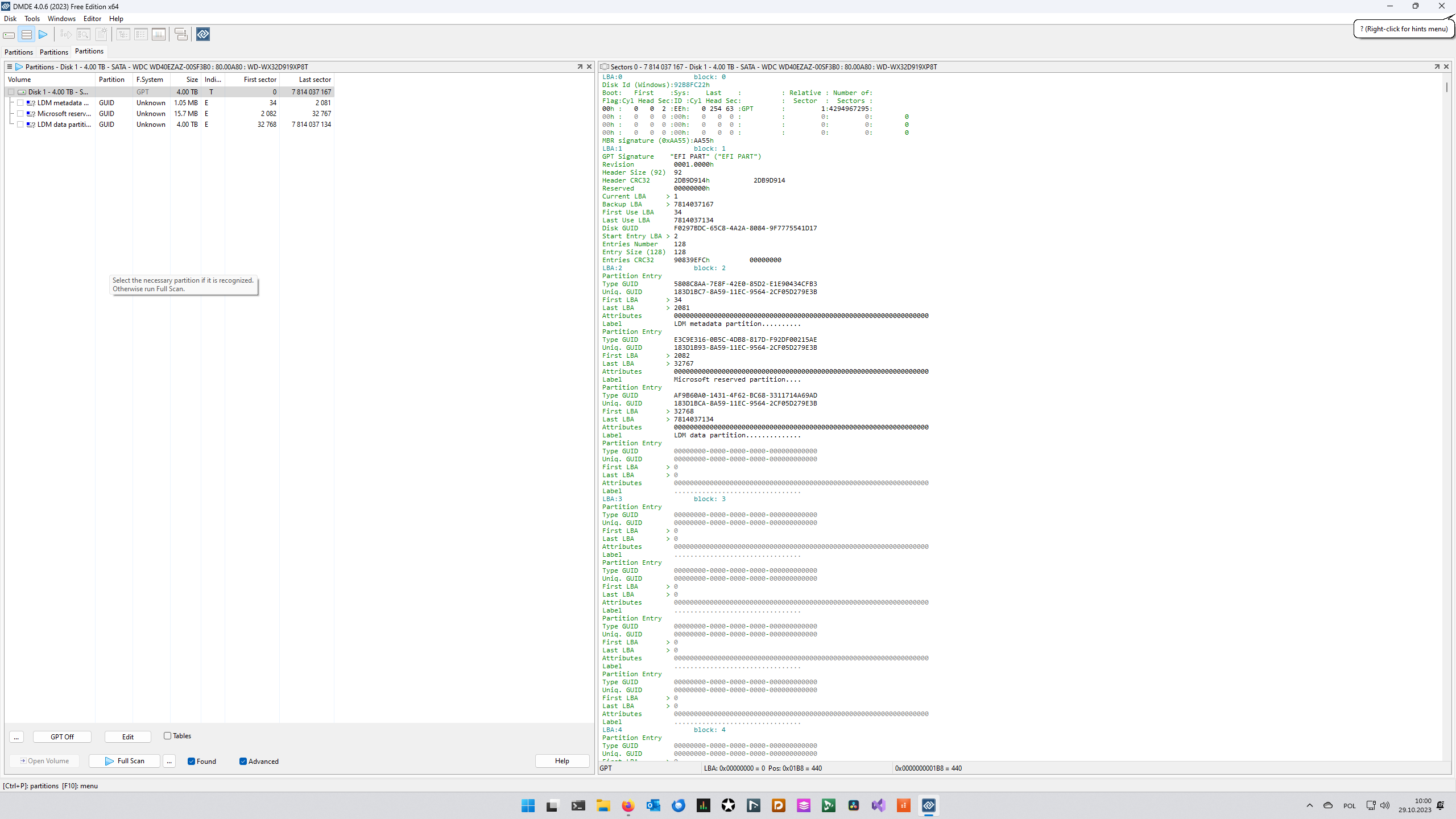

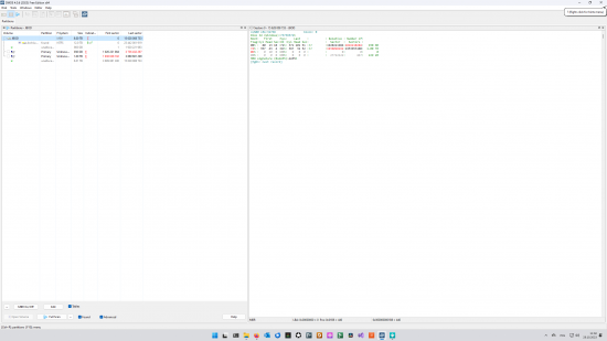

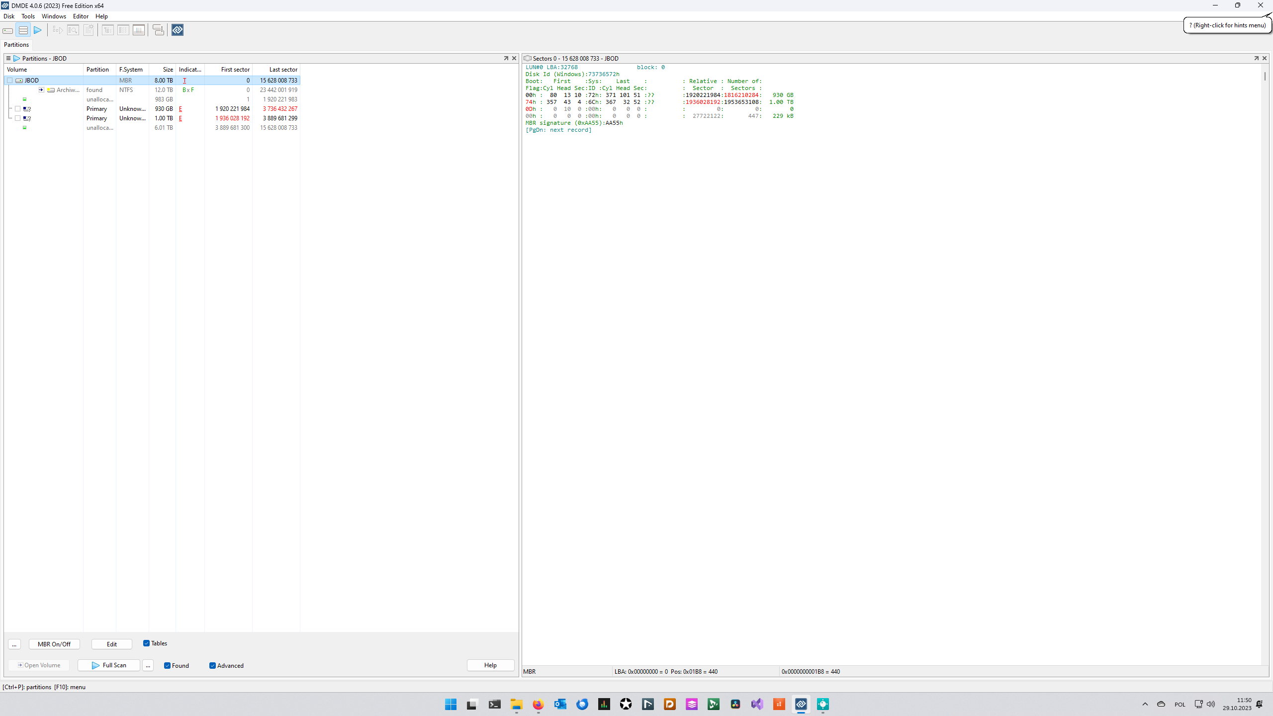

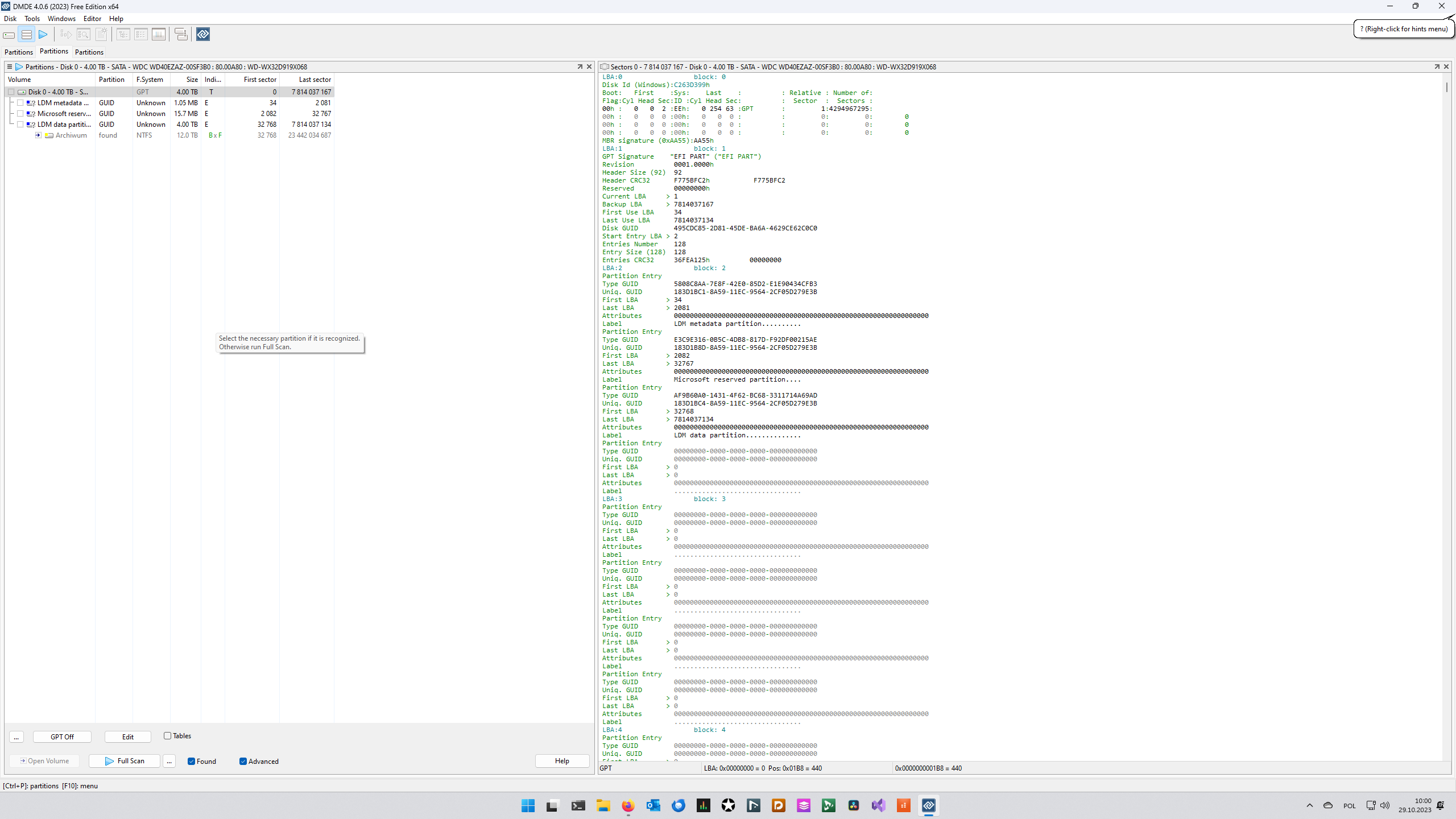

I don't exactly know what you mean by partition TAB?
But I assume that maybe it will be this:
File comment: First drive
File comment: Second one
Thank you for your help!
 Post subject: Re: Help me assembly JBOD/spanned in DMDE with missing drive
PostPosted: October 29th, 2023, 6:30
Joined: May 13th, 2019, 7:50
Posts: 1217
Location: Nederland

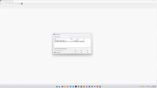

Try adding those two 4 TB LDM data partitions to a JBOD in DMDE instead (so offset 32768, size 7814037134). Adding null disk you could even not bother with, if DMDE complains about volume size just ignore that.
PostPosted: October 29th, 2023, 6:51
Joined: October 28th, 2023, 10:28
Posts: 23

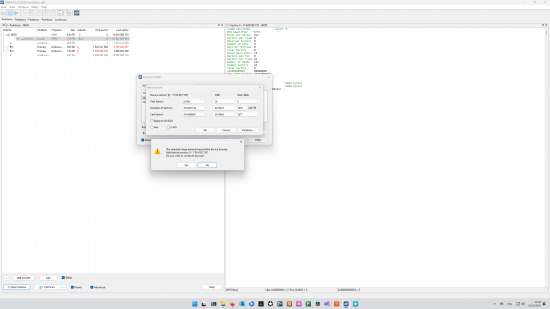

Okay so this (if I did it correctly) didn't seem to help

Pick archive NTFS > Open volume

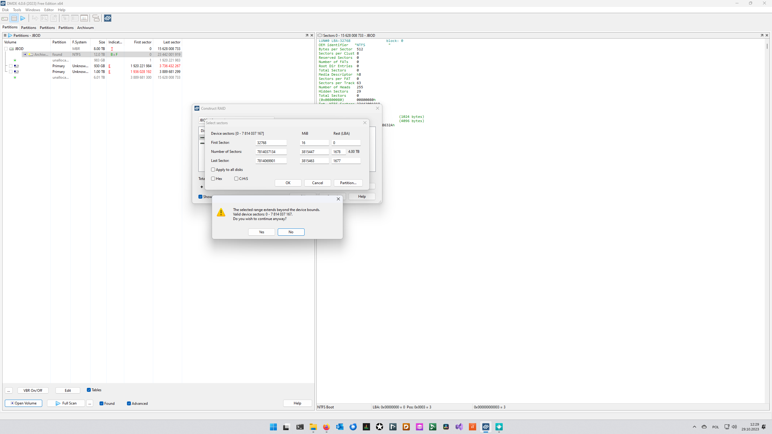

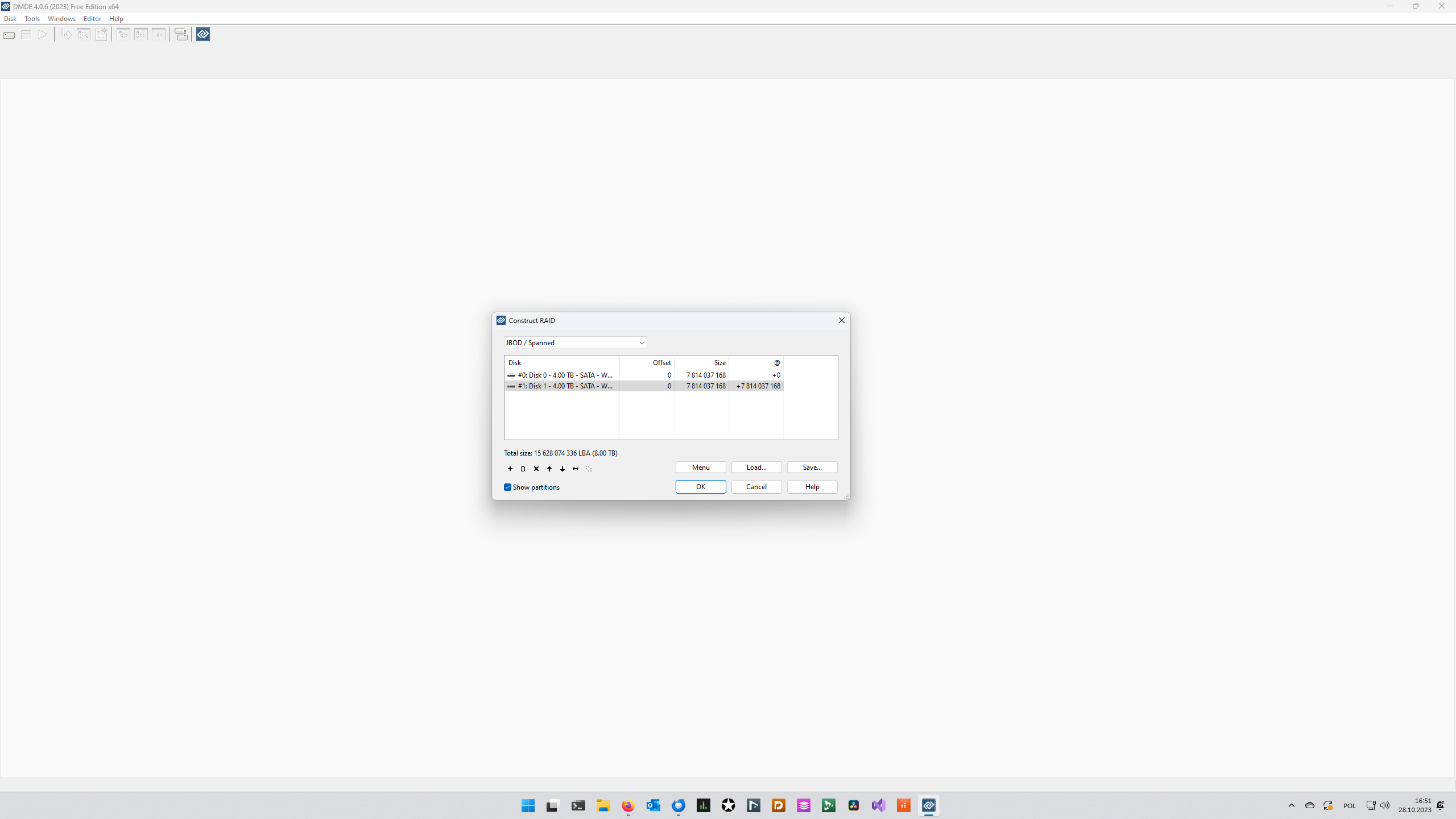

I can't paste a 7814037134 into the "number of sectors" because it says that selected range extends beyond the device bounds
PostPosted: October 29th, 2023, 7:47
Posts: 1217
Location: Nederland

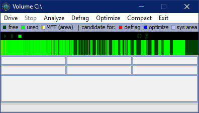

My bad, 7814037134 is last sector. So should be, so offset: 32768, end: 7814037134, number sectors: (7814037134 - 32768), you can also simply click 'partition' and select the partition.
I know that because I have sorted everything by years.
Since it is a spanned volume, the 1st drive is being written 1st,
While in general this is true, data is written towards start of volume as rule of thumb, it's not something you can take for granted. This volume has about 35% free space, see how data is actually spread out:

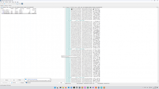

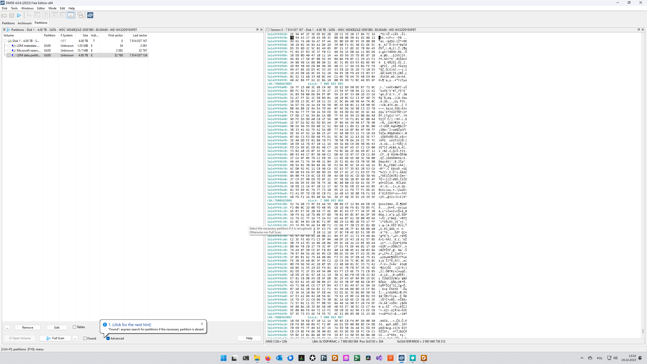

Okay, select the 2nd drive you're adding to the JBOD, so just that one disk, click advanced, it opens hex view. Scroll through it, does it show data? Enough to add up to 3.5 TB? Estimate it, 3 out of every 4 sectors should contain data in that case.
PostPosted: October 29th, 2023, 8:03
Posts: 23
Yes, it is nearly full of data

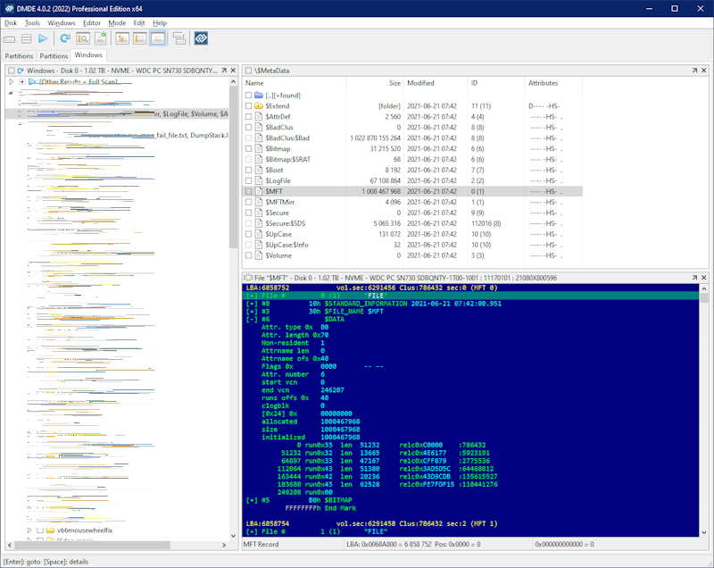

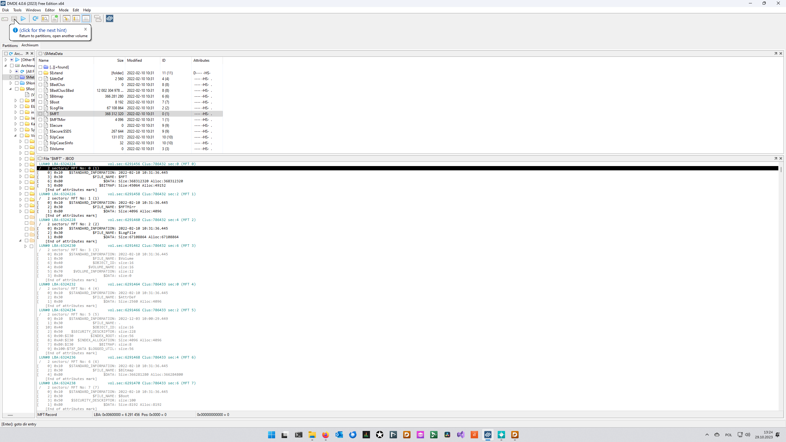

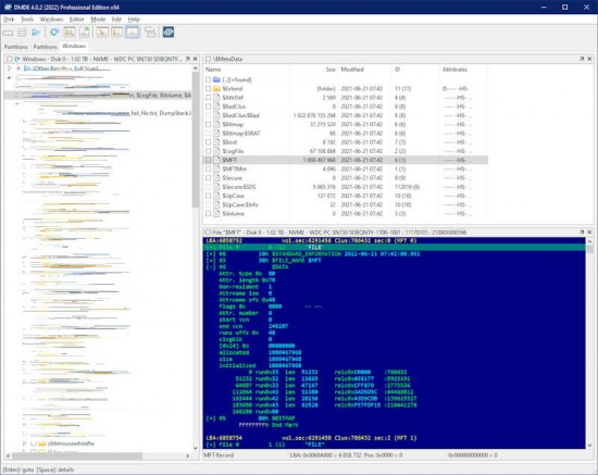

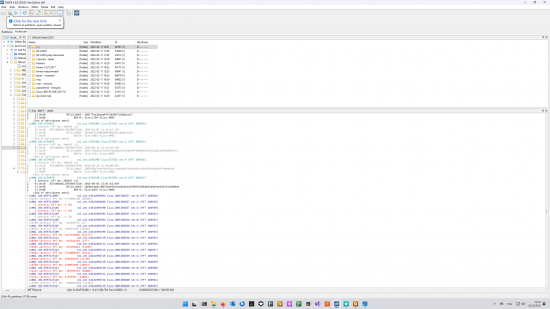

Okay, then try .. Make the JBOD like before (offset: 32768, end: 7814037134, number sectors: (7814037134 - 32768), you can also simply click 'partition' and select the 4 TB partition). Select the Archive partition like before. Click 'all found / virtual file system' > pure FS.
If you still don't see files then ..
Click meta data folder and select MFT > right click it > Open entry > expand Data attribute (see pic) and post screenshot please.
PostPosted: October 29th, 2023, 8:27
Posts: 23

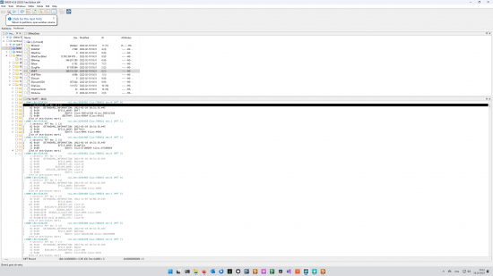

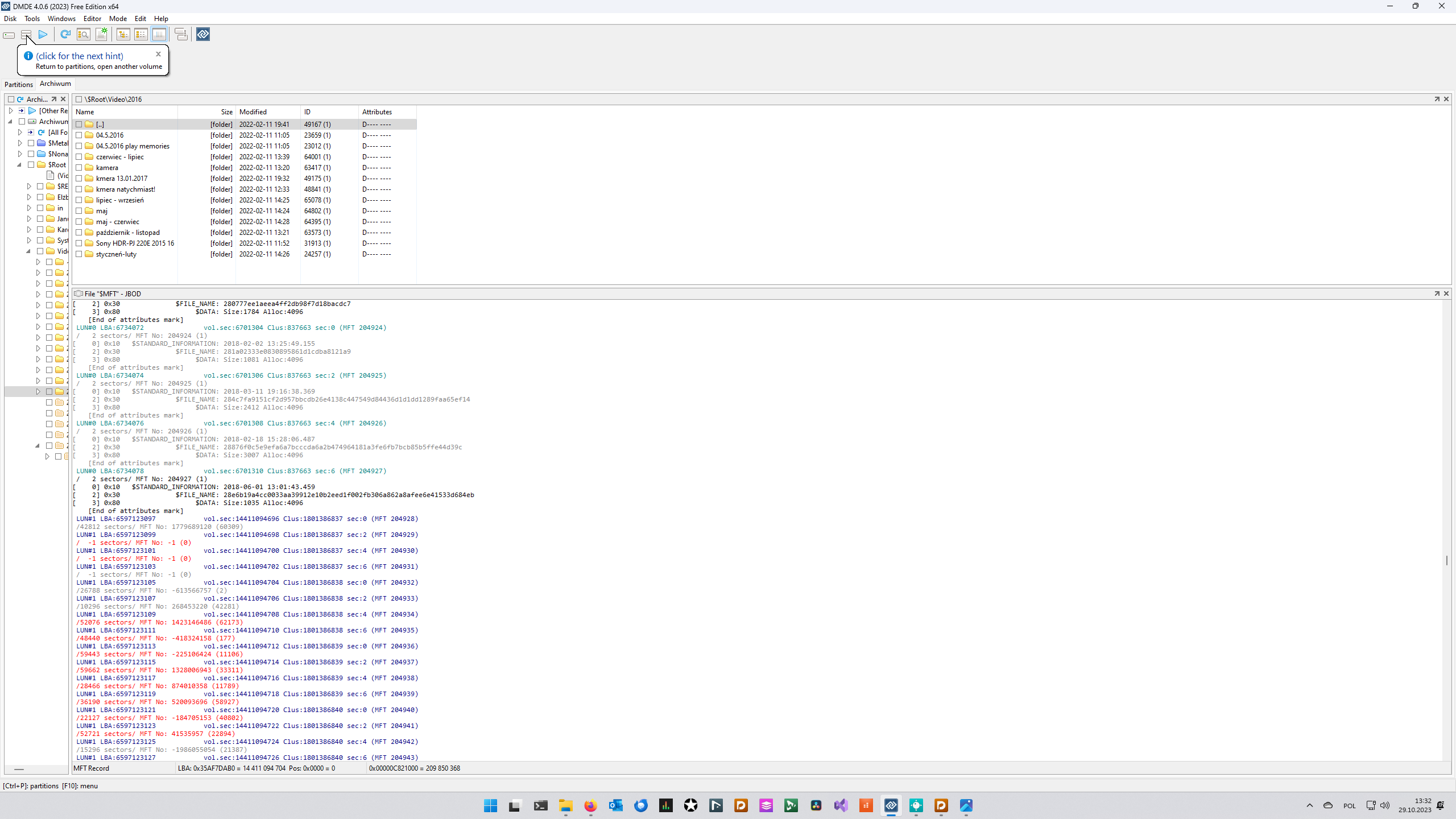

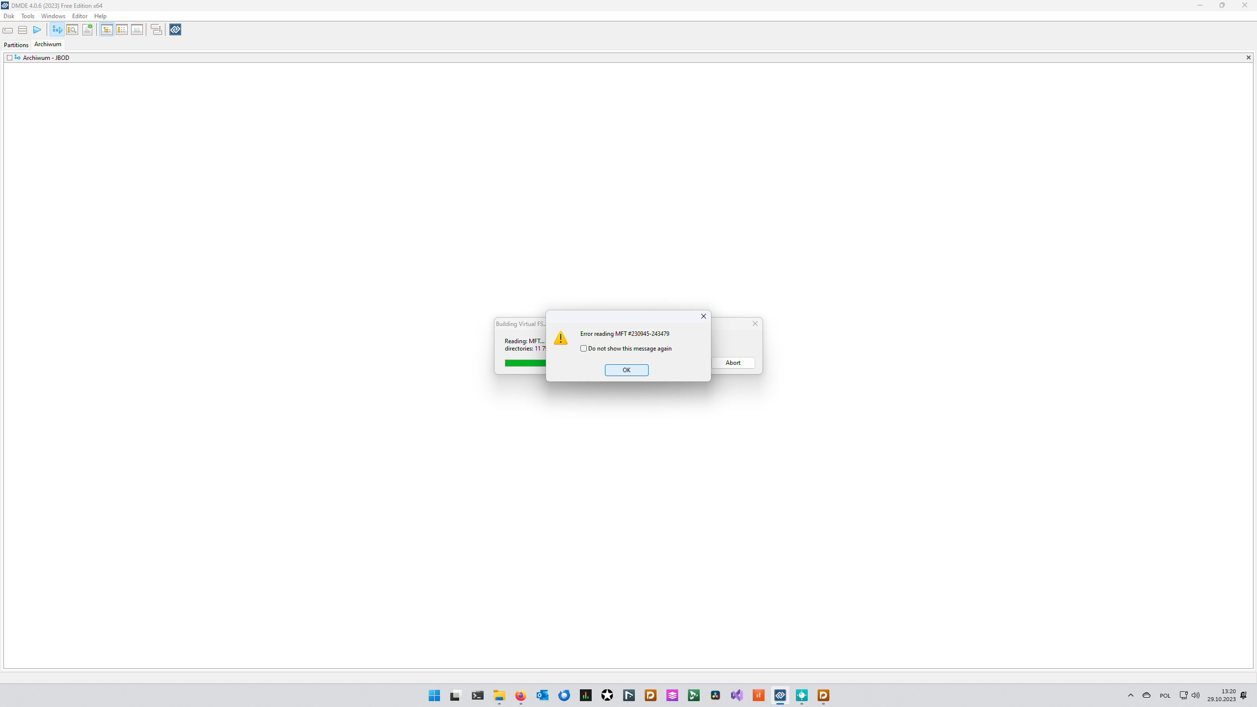

When it was doing it, it said multiple times "Error reading MFT # "
Files are still non-visible
I'm including this MFT entry

Also, when I look at MFT between LUN#0 and #1, on LUN#0 it shows file names etc.
However, on the LUN#1, it's not
