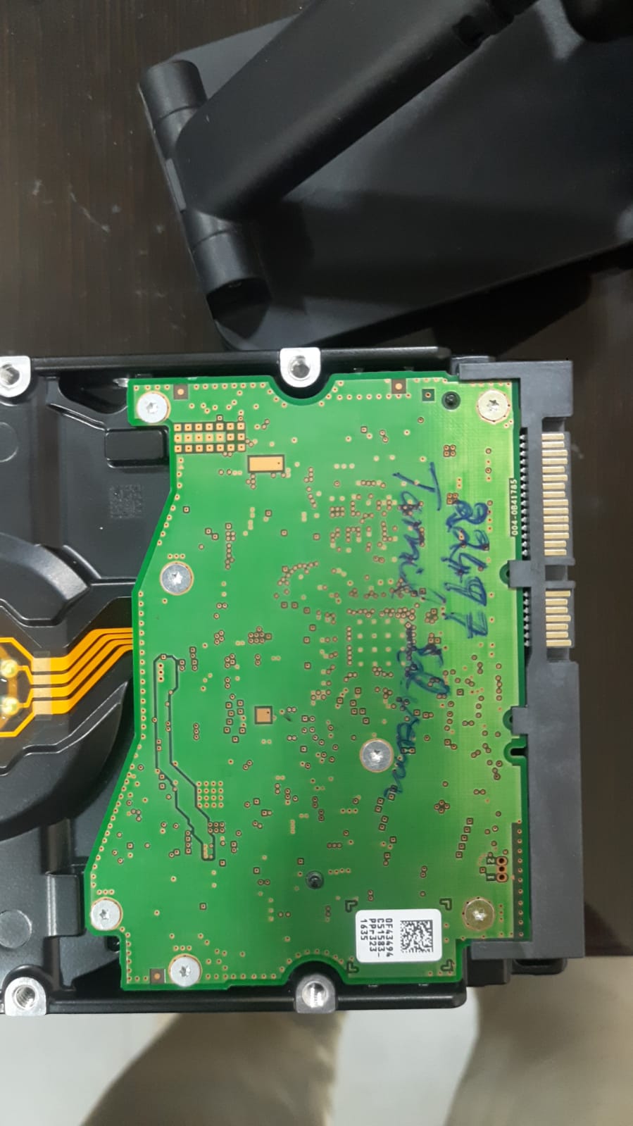

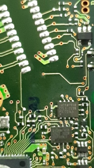

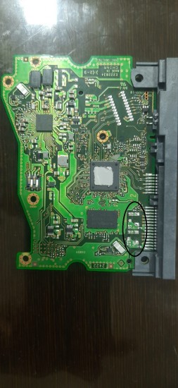

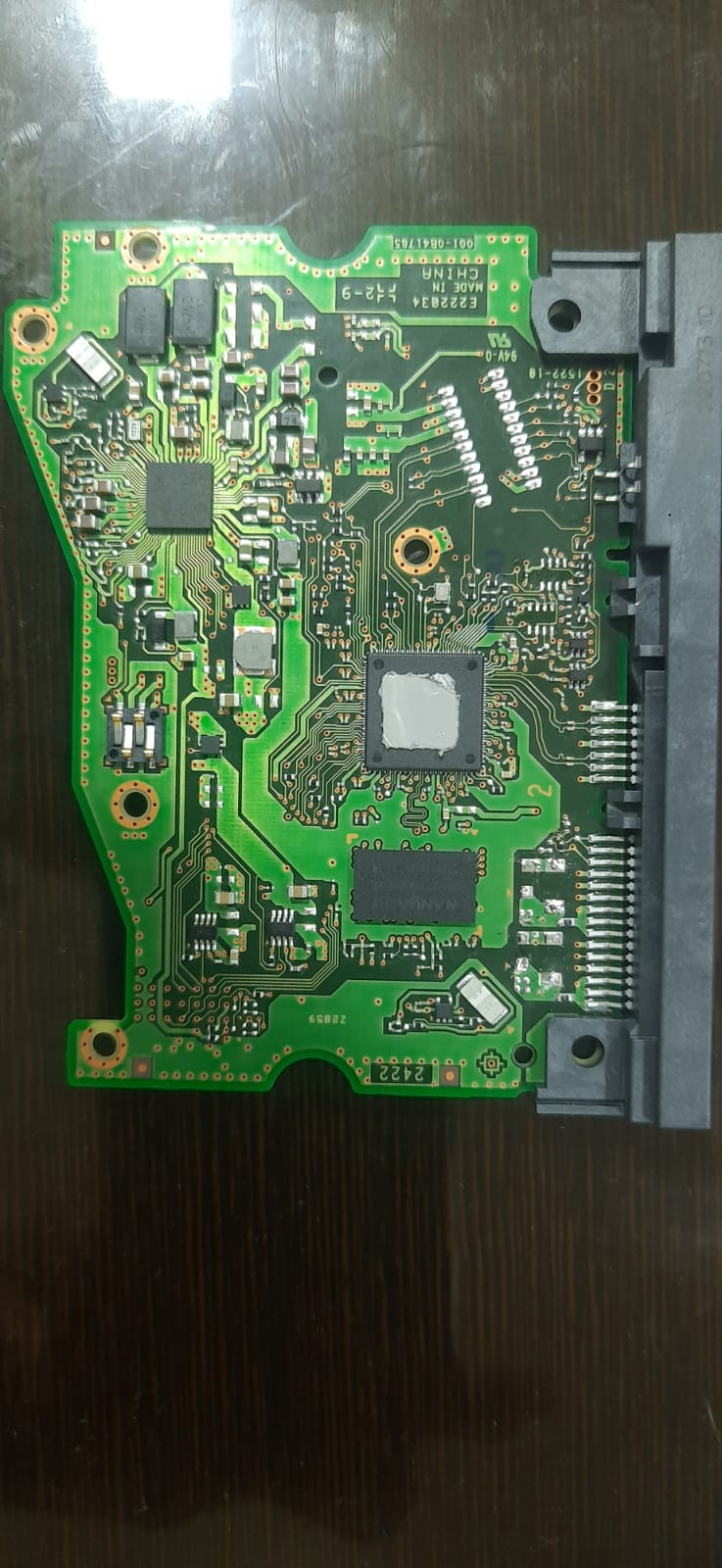

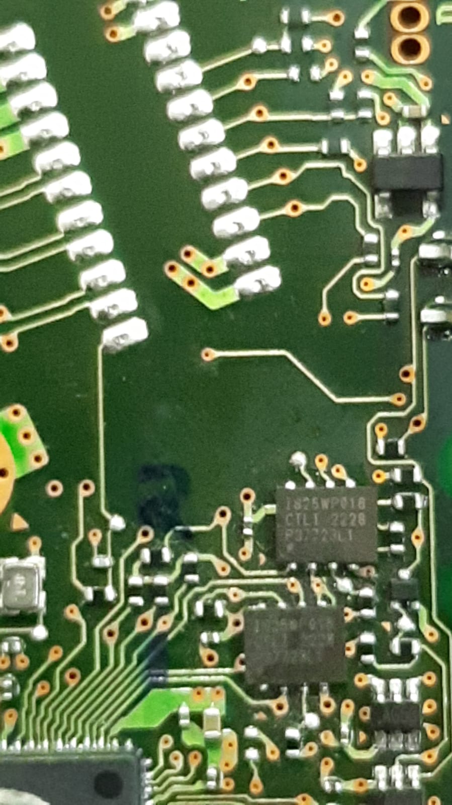

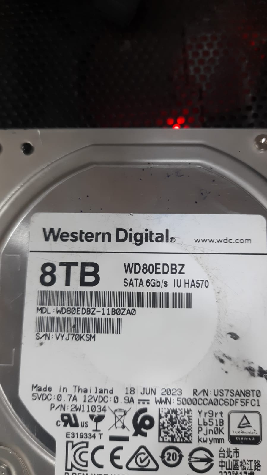

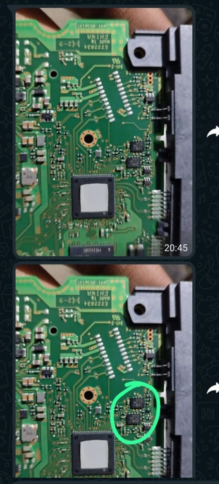

Its a WD 8TB Hitachi Architect drive , initial problem was patient pcb is dead and doesn't spin, tried fixing pcb dint help, its micro rom and has 2 roms , drive was already returned by another data recovery lab, as they are not able to read the rom and dint have rom reader as its T2 uson rom, they have removed both the rom but i have a doubt whether they placed the rom in same position(rom 1 and 2) , i tried swapping the rom in donor pcb drive comes ready in pc3k with full id but no sector access we cant backup resources as its not supported model, then i returned the donor rom in donor pcb again its same problem drives come ready with full id but no sector access initially the donor was fine i interswapped the donor rom i.e, rom 1 and rom 2 still same problem, so i have bought a t2 rom uson reader read roms of both donor and patient drive and have the backup, in order to find solution i have got another donor removed both roms and took backup and fixed the same rom same position in donor 1 pcb to check whether the pcb has encryption now donor 2 drive has sector access with donor 2 rom and donor 1 pcb, all i have found is that when the rom is inter changed that is rom 1 and rom 2 of patient or donor 1 the rom value gets modified,i got this conclusion with donor 2 roms as i dint interswap the donor 2 rom and have the initial rom back now i have attached patient roms i dint know which 1 is left and right and donor rom left and right and also unmodified (was not interswapped) donor 2 rom left and right kindly help me fix the patient rom i am also attaching the pcb number and pcb as well
What am trying to say finally is that interswapped roms of both patient and donor 1 value gets modified whereas donor 2 both which is not interswapped does not gets modified and works fine i wanted some 1 who can help me fix patient rom using donor 2 rom as reference
File comment: bot rom of donor 2

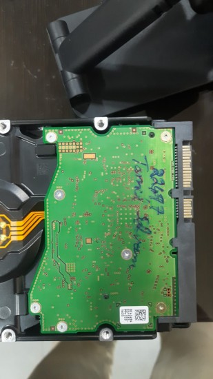

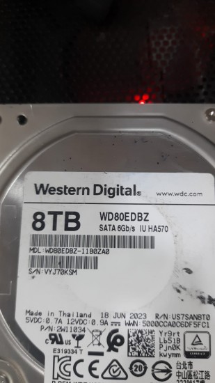

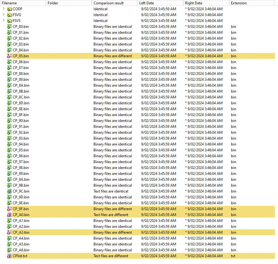

ROMs 1 and 2 differ in 4 modules.

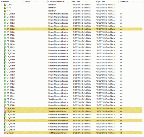

This is a comparison of the patient and donor #2 ROMs.

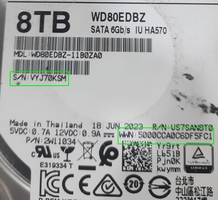

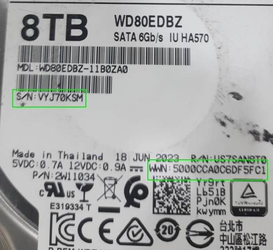

Your patient PCB is native:
Parsing information in MINQ CP 0x83 and HIN1 / HIN2 CPs 0x99 / 0x9A ...
HDD serial number              = VYJ70KSM          <---
Date of manufacture            = week 25 of 2023
HDD part number                = 2W11034
PCB part number (sticker)      = 0F43494          <---
Media Disk Definition          = MediaDiskDefinit
Motor Serial Number            = R0218L
Flex Assembly Serial Number    = A4A1RE12
Actuator Serial Number         = A4A1RE12
Device Enclosure Serial Number = DESerialNumber00
Card Serial Number (sticker)   = 3231635          <---
Card Assembly Part Number      = 0F43494
World Wide Name                = 5000CCA0C6DF5FC1     <---
Microcode version (HIN1)  = X9E0
Firmware version (HIN1)   = 85_00A85
PUIS flag (HIN1)          = disabled (0x00)
Microcode version (HIN2)  = X9E0
Firmware version (HIN2)   = 85_00A85
PUIS flag (HIN2)          = disabled (0x00)
Supported Inquiry VPD pages = 0x0  0x3  0x80  0x83  0x86  0x87  0x88  0x8A  0x8D  0x90  0x91  0xB0  0xB1  0xB2  0xD1  0xD2  0xE1  0xE2  0xE3

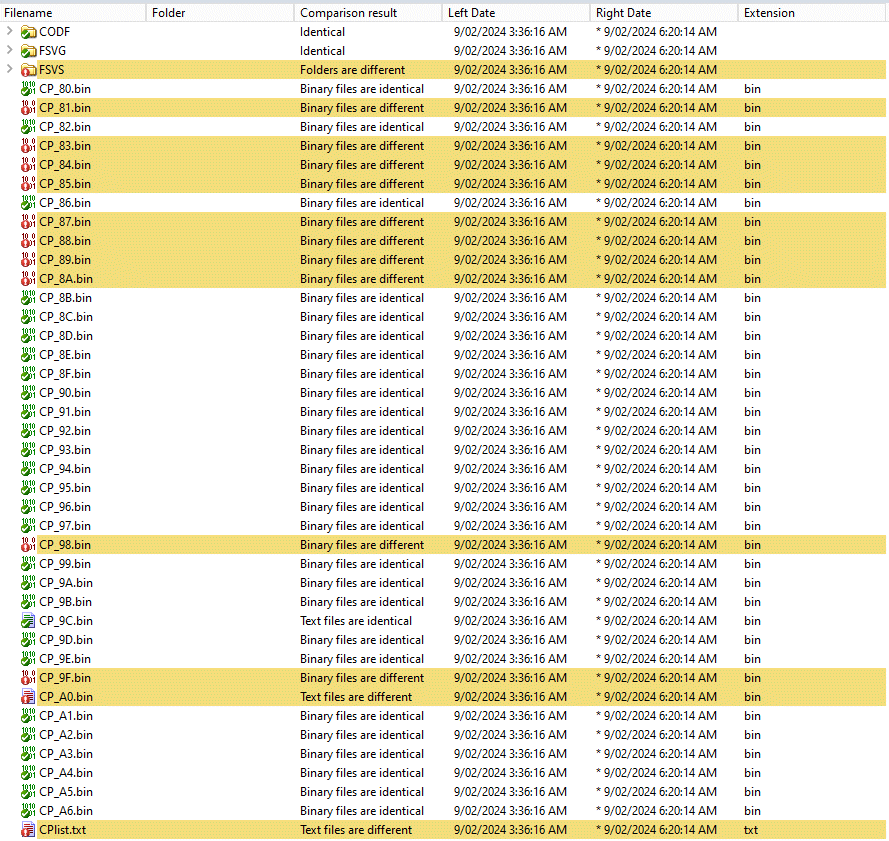

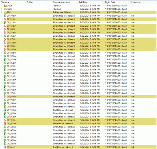

Compare PATIENT\CPs_01 and DONOR 2\ROM 1 RIGHT\CPs_00
Filename     Comparison result
FSVS         Folders are different
CP_81.bin    Binary files are different    table of modules with 96-bit hashes
CP_83.bin    Binary files are different    MINQ - Inquiry info
CP_84.bin    Binary files are different    FCHN - Read/Write CHaNnel parameters (https://www.hddoracle.com/viewtopic.php?p=23986#p23986)
CP_85.bin    Binary files are different    ?
CP_87.bin    Binary files are different    FSVS - adaptives
CP_88.bin    Binary files are different    FAEP - head related adaptives (https://www.hddoracle.com/viewtopic.php?p=23987#p23987)
CP_89.bin    Binary files are different    FIMG - head related adaptives (https://www.hddoracle.com/viewtopic.php?p=23991#p23991)
CP_8A.bin    Binary files are different    FCRD - PCB (card) related info
CP_98.bin    Binary files are different    FSEC - 64-byte key/hash/signature
CP_9F.bin    Binary files are different    ?
CP_A0.bin    Text files are different      ?
CP_A3.bin    Binary files are different    ?

I think you may have two problems.
That other thread would suggest that the MCU has a key that is matched to the firmware, plus your experience with donor #1 suggests that interchanging the ROM positions causes some kind of corruption.
I could help you to repair the patient PCB if you could provide a detailed photo.

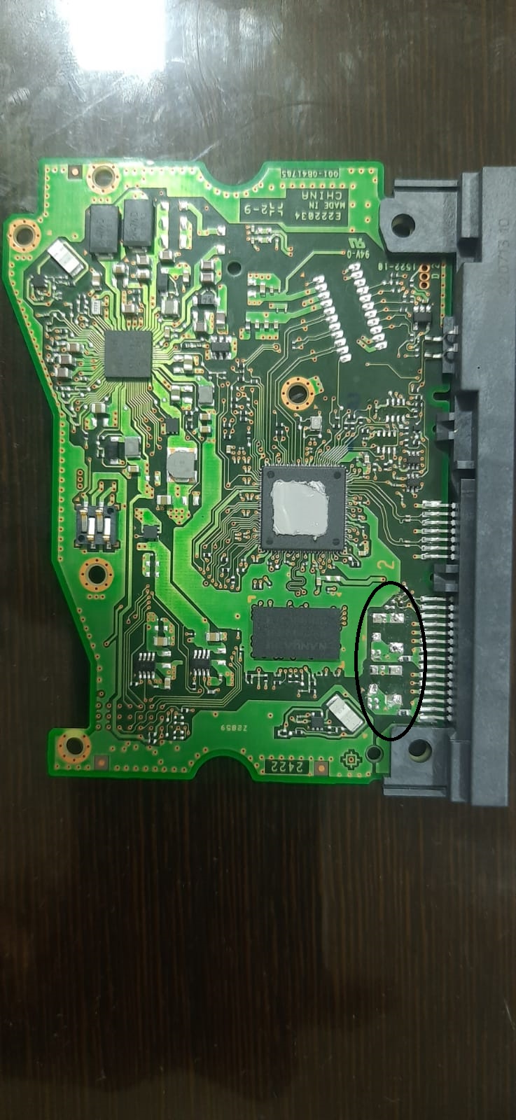

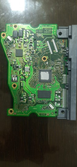

pls find the pcb am sure fixing the patient pcb wont help bcoz the rom value is modified only way is to fix the modified rom to get the sector access ( donor 1 rom was also interswapped thats y am not able to get access of donor 1 sectors due to modified rom even if i install donor 1 rom in donor 1 pcb) but donor 2 works fine in donor 1 pcb as it was not interswapped and rom was not modified that shows the mcu is not encrypted

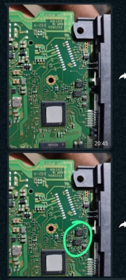

File comment: i have tried fixing diodes from donor pcb but dint help so removed back

 Post subject: Re: Can somebody help me fix this rom its WD80EDBZ-11B0ZA0 D
PostPosted: February 11th, 2024, 17:22
Posts: 17314
What voltages do you measure at Vx and Vy?

Here is another HGST model that has a single ROM with two mostly identical halves. Essentially it combines your ROMs 1 and 2 into a single ROM. You can compare the differences between each half against the differences between your ROMs 1 and 2.
https://www.hddoracle.com/viewtopic.php?p=20172#p20172
PostPosted: February 15th, 2024, 2:27
Joined: July 11th, 2018, 10:55
Posts: 43
Vx measures 5v and Vy measures 12v
