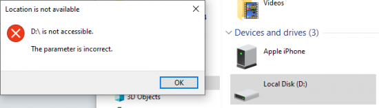

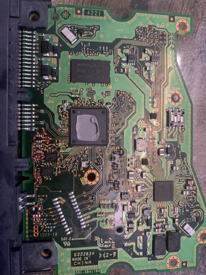

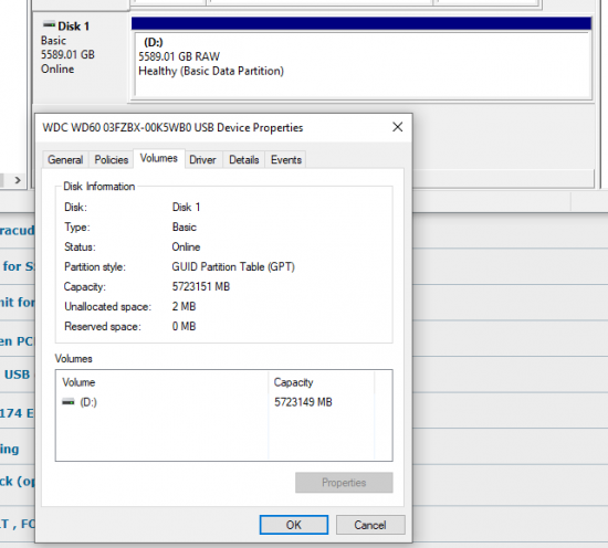

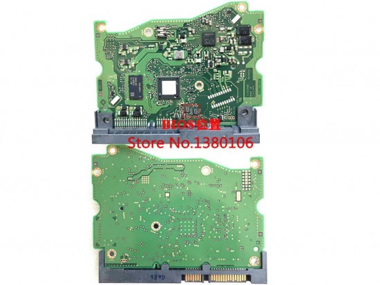

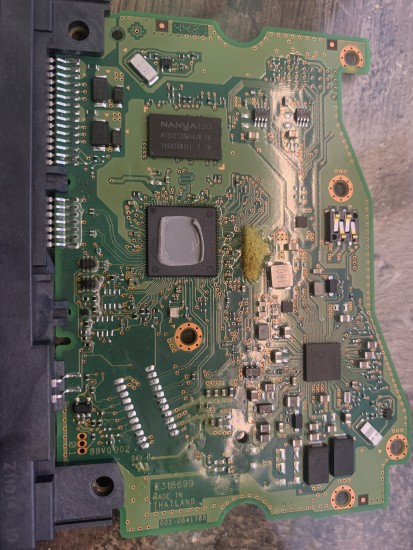

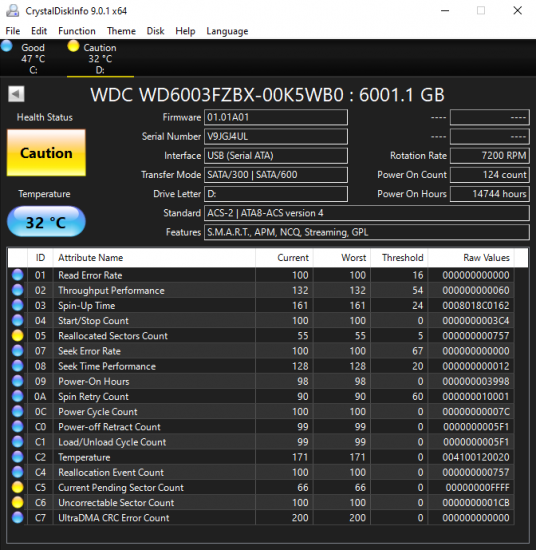

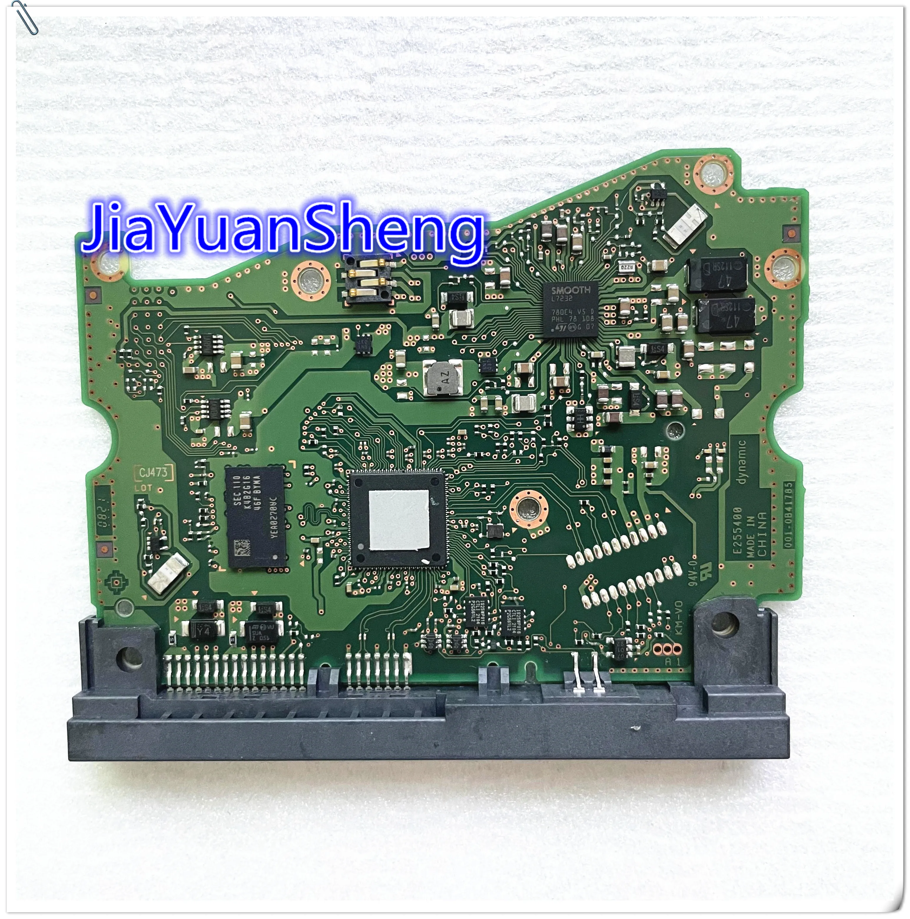

 Post subject: WD missing components? WD6003FZBX 001-0B41785
PostPosted: June 14th, 2023, 13:44
Joined: March 13th, 2023, 20:34
Posts: 13
Location: Chicago
Had a HDD go bad again due to power shortage. Purchased a new one via Amazon just as they came back into stock. I replaced BOTH the bios chips, the drive spins up and disk is detected but can gain no access and says 0 bytes out of 6tb. Taking a look at the motherboards of the drives, there seem to be quite a few components missing. You can also see the the original (original board which has previously been replaced) and the new replacement board have different manufacturer origins.
Original board (Thailand):
File comment: Original board, bios chips removed.
Thailand
IMG_3940.jpg [ 1.58 MiB | Viewed 5679 times ]
NEW replacement board (China):
File comment: NEW Replacement board, with bios chips.
China
IMG_3939.jpg [ 1.92 MiB | Viewed 5679 times ]
STOCK photo for BIOS CHIP Loaction:
File comment: BIOS chip location. STOCK photo.
AU62D2111130KTKGKF9.jpg [ 112.04 KiB | Viewed 5679 times ]
Are the components near the bios chips and others around the board necessary? Can this be the reason my drive is not loading any of the data?
error.PNG [ 13.8 KiB | Viewed 5679 times ]
 Post subject: Re: WD missing components? WD6003FZBX 001-0B41785
PostPosted: June 14th, 2023, 13:53
Joined: March 13th, 2023, 20:34
Posts: 13
Location: Chicago
Here are the missing or switched components in red:
IMG_3939-circled.jpg [ 2.94 MiB | Viewed 5672 times ]
 Post subject: Re: WD missing components? WD6003FZBX 001-0B41785
PostPosted: June 14th, 2023, 14:02
Posts: 17314
That's interesting. Can you tell us the markings on the missing IC?
Did you check the fuses and TVS diodes on the original PCB?
Here is a similar layout:
http://users.on.net/~fzabkar/HDD/0B40385/TVS_diodes_fuses.jpg
Does the "repaired" HDD report SMART data to CrystalDiskInfo or some other SMART tool?
 Post subject: Re: WD missing components? WD6003FZBX 001-0B41785
PostPosted: June 14th, 2023, 14:19
Joined: March 13th, 2023, 20:34
Posts: 13
Location: Chicago
That's interesting. Can you tell us the markings on the missing IC?
Did you check the fuses and TVS diodes on the original PCB?
Here is a similar layout:
http://users.on.net/~fzabkar/HDD/0B40385/TVS_diodes_fuses.jpg
Does the "repaired" HDD report SMART data to CrystalDiskInfo or some other SMART tool?
This is the "repaired" with the china mobo:
error1.PNG [ 13.8 KiB | Viewed 5669 times ]
Capture2.PNG [ 26.9 KiB | Viewed 5669 times ]
Capture3.PNG [ 61.1 KiB | Viewed 5669 times ]
Will check the fuses now once i locate my multimeter
 Post subject: Re: WD missing components? WD6003FZBX 001-0B41785
PostPosted: June 14th, 2023, 14:28
Posts: 17314
The drive is sick. However, I'm wondering whether you are seeing the result of a unique encryption key in the MCU. IMO it would be best to repair the original PCB and return the ROMs.
Can you show us the hexadecimal contents of sector 0 with DMDE? That should tell us whether you are now facing an encryption issue.
https://dmde.com/
 Post subject: Re: WD missing components? WD6003FZBX 001-0B41785
PostPosted: June 14th, 2023, 14:52
Joined: March 13th, 2023, 20:34
Posts: 13
Location: Chicago
The drive is sick. However, I'm wondering whether you are seeing the result of a unique encryption key in the MCU. IMO it would be best to repair the original PCB and return the ROMs.
Can you show us the hexadecimal contents of sector 0 with DMDE? That should tell us whether you are now facing an encryption issue.
https://dmde.com/
Am unable to find another multimeter, loaned it to father. Ordering one with delivery tomorrow.
 Post subject: Re: WD missing components? WD6003FZBX 001-0B41785
PostPosted: June 14th, 2023, 15:07
Posts: 17314
The missing components appear to constitute a UART interface. One IC is a 3.3V LDO regulator, while the other two are level shifters. Therefore, these components would have no bearing on the functionality of the replacement PCB.
https://ae01.alicdn.com/kf/H5ced1cae1ee5481a9621501c49615281y/Western-digital-circuit-board-0B41785-004-0B41785-001-0B41785.jpg
BU33TD3WG, Rohm, 3.3V, 200mA, LDO regulator, marking G7+xx+xx, SSOP5:
https://wwwmouser.com/datasheet/2/348/buxxtd3wg_e-1874160.pdf
TXS0101DCKR, Texas Instruments, 1-Bit Bidirectional Voltage-Level Shifter for Open-Drain and Push-Pull Application, marking 2GO, SC70-6:
http://www.ti.com/lit/gpn/txs0101
 Post subject: Re: WD missing components? WD6003FZBX 001-0B41785
PostPosted: June 14th, 2023, 15:10
Posts: 17314
Your data look OK, so it's not an encryption issue.
I would use HDDSuperClone to clone your drive, and then use DMDE to recover your data from the clone.
 Post subject: Re: WD missing components? WD6003FZBX 001-0B41785
PostPosted: June 15th, 2023, 13:19
Joined: March 13th, 2023, 20:34
Posts: 13
Location: Chicago
Your data look OK, so it's not an encryption issue.
I would use HDDSuperClone to clone your drive, and then use DMDE to recover your data from the clone.
Thanks Fzabkar for your help, a new larger drive is on the way for the procedure. Will update with results.
Users browsing this forum: Google [Bot], kotel and 116 guests
