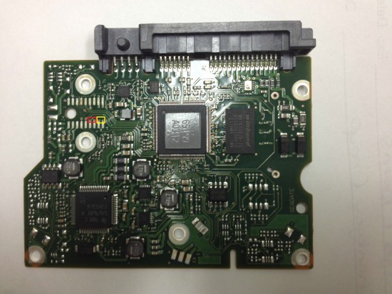

No, I can't do nothing because it stays busy. Also can't access terminal, anyone knows shorting points for this pcb 100664987 REV A?

Have you tried shorting reading channel to get access to terminal?

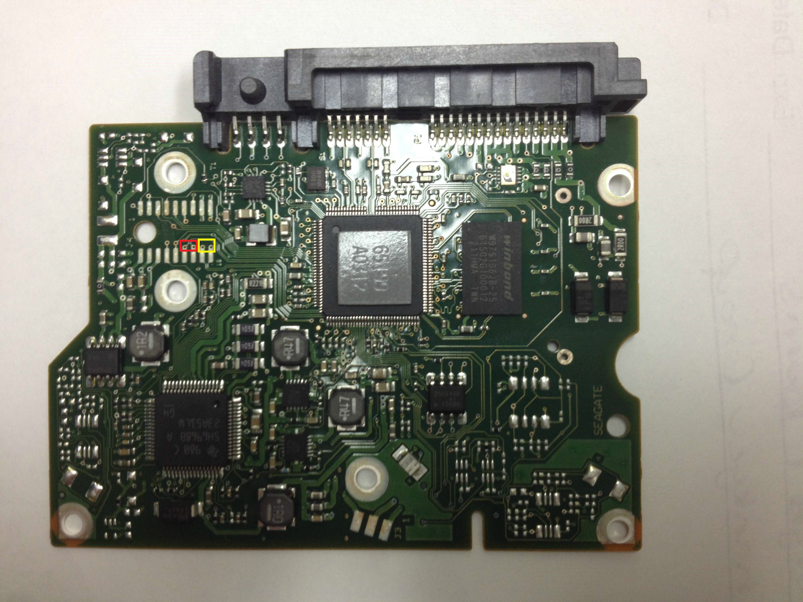

i will try method of xeonium..
try red pins first, and if they not work, try yellow pair.
from entec
