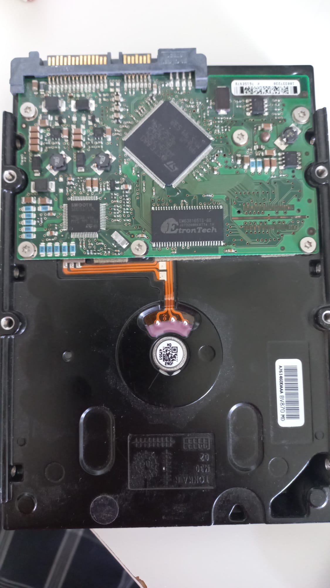

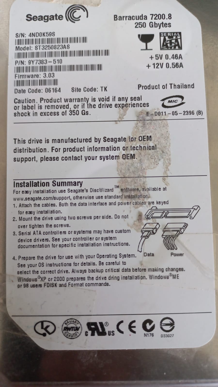

Hello everyone,
can anyone assist me with this HDD Seagate Barracuda 7299.8, 250 Gig.
Using SATA-to-USB, the computer doesn't detect it. When I join the USB it appear for seconds and disappear again quickly.
Is the issue here related to the Firmware or something else? if yes, where is the BIOS firmware that needs to be replaced?
Thanx in advance.

Does the motor spin ? You need to connect terminal to see what's going on.

Have you tried with another USB enclosure or directly on motherboard with SATA?
This model is not exist, its 7200. I know, I'm nitpicking.
Why you using converter?
What exactly do you want to do with the ROM while the drive boots normally?
Recover-IT wrote:
yeah like I mentioned, it spins. Even it appear for a second and disappear again.
Your name and signature refer to a data recovery company, why are you asking such basic questions?
Did you connect the disk to the terminal and analyze the logs?

 Post subject: Re: Seagate Barracuda problem
PostPosted: June 26th, 2024, 5:48
Posts: 1312
He's not nittpicking .
You're advertising and selling a service it's obvious you can't deliver then asking professionals here to solve cases for you. Stuff like this makes us all look bad and why social media is full of complaints about data recovery services.
Put the drive on whatever pro tool you have and post the log from the terminal. If you don't have pro tools and you don't know how to do things manually you shouldn't have taken the clients case.
