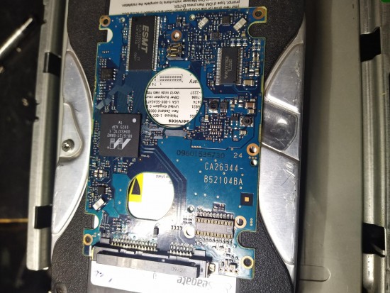

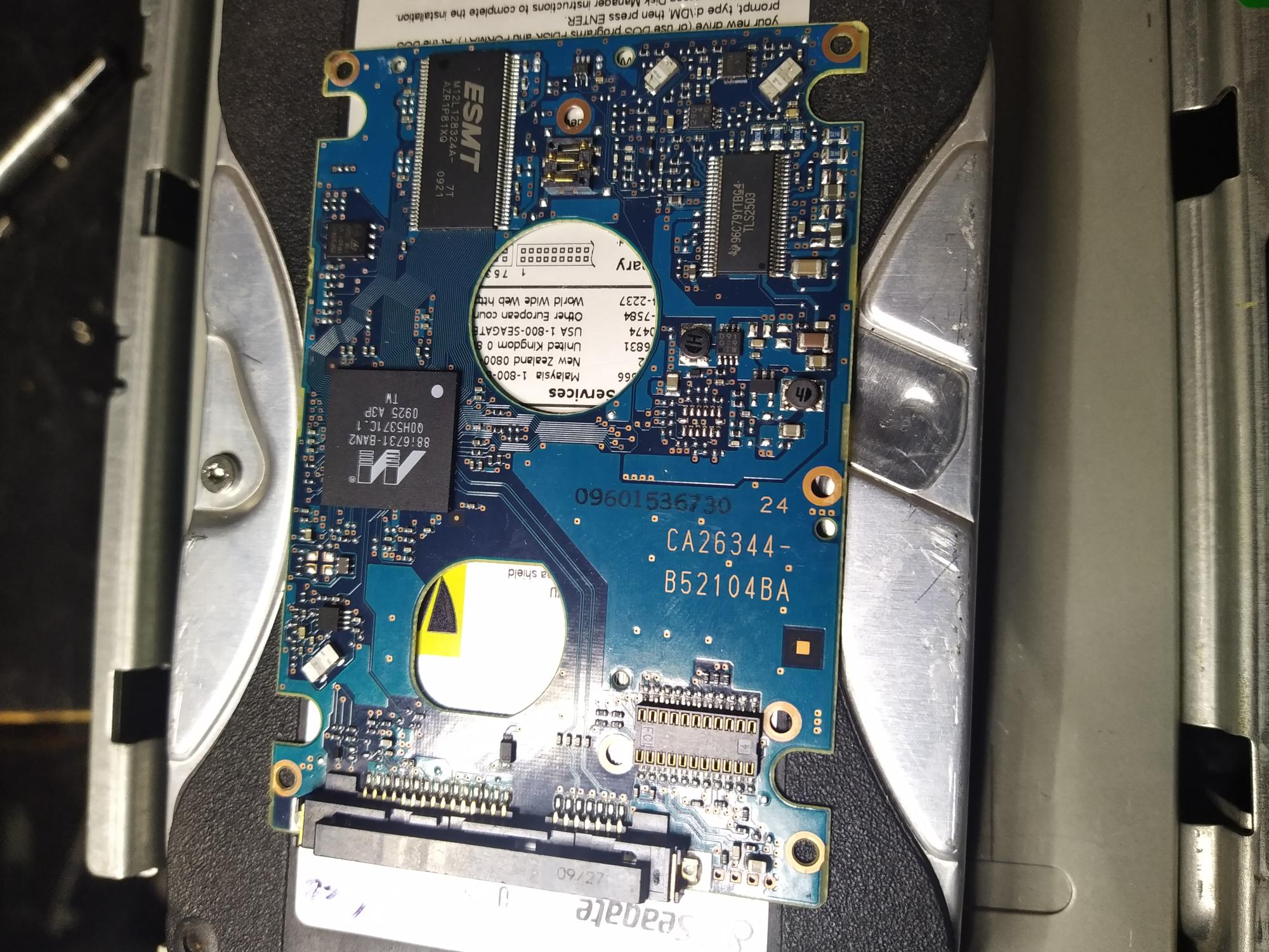

 Post subject: Re: FUJITSU MHZ2160BK G2 (DELL OEM) - no life
PostPosted: October 17th, 2024, 1:40
Joined: April 2nd, 2024, 3:40
Posts: 167
Location: on lifes edge
Full picture of the PCB. Those white fuses should be the thermal/thermic fuses, correct? Theres also a broken resistor, but it looks like its only connecting GND
PostPosted: October 17th, 2024, 2:26
Posts: 17341
If you are referring to those 3 white shock sensors, then you would be best advised to outsource this job.
https://hddscan.com/doc/HDD_from_inside.html
PostPosted: October 17th, 2024, 2:43
Posts: 17341
This is what you should be looking for (different model):
https://web.archive.org/web/20230730234912/http://www.users.on.net/~fzabkar/HDD/MHW2080BH_fuse.jpg
PostPosted: October 17th, 2024, 3:40
Posts: 167
Thanks for correcting me. It looks like the fuse on mine is blown. Wierd how it looked like an resistor, although it had bulged. Any ideas what type it might be? Cause the worst case scenario if I bypass it the whole board is gonna be fried, right?
PostPosted: October 17th, 2024, 5:15
Posts: 17341
These fuses often fail due to age-related fatigue. Check that there is no short circuit to ground. You can replace the fuse with a 2A fast type.
PostPosted: October 17th, 2024, 9:39
Posts: 167
Replaced it with an 0 ohm resistor and it works! Sort of... It isn't detected and is clicking (even only the PCB isn't). Opened it up cause whats here to lose and no damage to top platter. I do wonder if its the head or SA damage.
