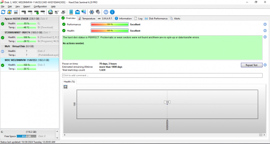

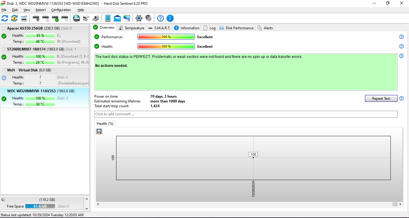

i have a External HDD WD Elements 2TB and Working Perfectly , Today i connected to old PC by USB2 and i hear USB plug in sound after 20 second opened This PC and won,t see external drive in list , i think driver is not mounted by windows , i without safety remove eject unplug my hard disk and plug again and won,t see again drive in drives list !!!!!
connect hard disk to my laptop by usb3 hear plug in USB sound and again not mount my external drive !
The information on the hard disk is not important, I just want to fix the problem of the hard disk and be able to use it
after open disk management in windows show hard disk Initialize Disk MBR OR GPT After Selected any choice After about 20 seconds return error : the request could not be performed beacause of an I/O device error :(
check this hard disk by Hard Disk Sentinel Health & performance is 100% see attached screenshot :

i,m attach smart log text to post

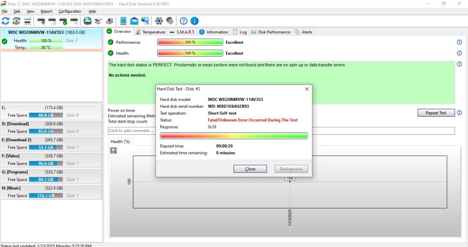

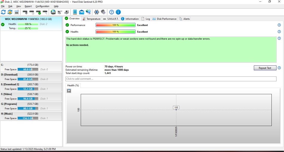

i attached smart report and i do short self test with Hard Disk Sentinel Pro but do nothing and problem have and i can,t initialized !
self test
smart report attached by wd.txt to this post
please help me fix that
