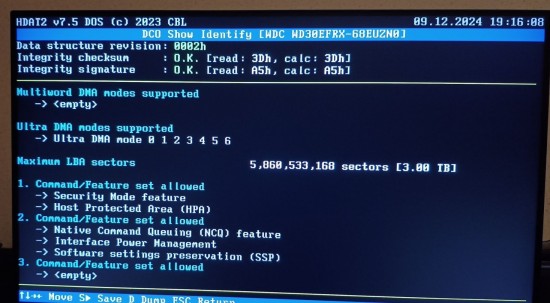

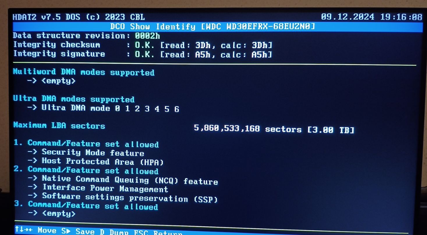

HDAT2 shows:
settings
DCO status: frozen
CMD7 DEV6 HIGH5 MID4 LOW3 CNT2 FEA1
00B1h 0040h 0000h 0000h 0000h 0000h 00C2h
0051h 0040h 0000h 0000h 0000h 0000h 0004h
on raw "modify" (same results)
nothing happens

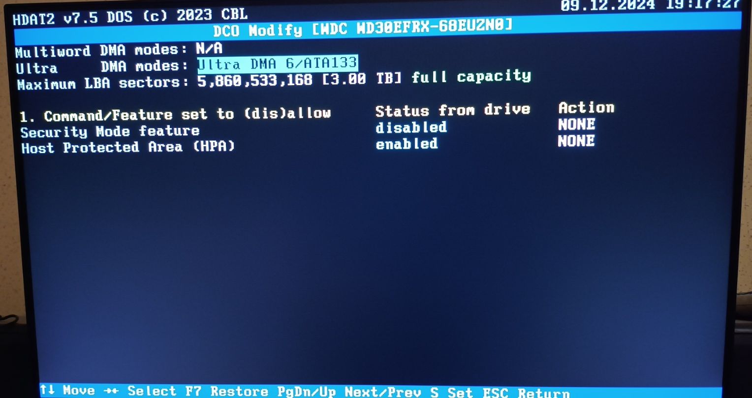

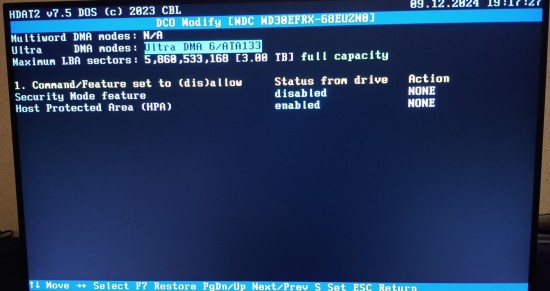

in the meantime i did it but it has no function for change trasfer except UDMA
 Post subject: Re: HDD WD30EFRX shows sata gen2 transfer instead sata gen3
PostPosted: December 9th, 2024, 14:57
Posts: 17228
I suspect that firmware module 0x02 or 0x0C would have this setting, but I don't know which byte(s).
The demo version of WDMarvel can read these modules.
I'm assuming that the OPT1 jumper is not installed.
