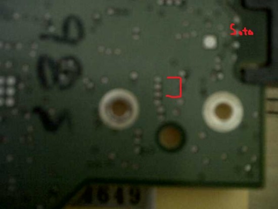

 Post subject: ST3000DM001 NO ID BSY and Spins.
PostPosted: May 9th, 2013, 15:09
Joined: April 1st, 2011, 16:12
Location: Denver, CO USA
The drive spins up and makes the normal init sounds but stays BSY. No access to terminal prompt. I understand this series of drives are exhibiting a lot of problems.The drive does not ID and shows a small LBA . I am not on the PC-3000 console currently to give exact LBA.
Thanks for any information regarding this series of drives.
PCB 100664987.
Any one have an image of the short points for this pcb?

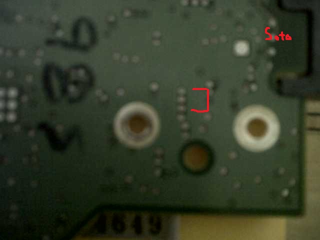

SOLVED:
Found short points on PCB 10664987
Pins 16 and 18 on HSA. flipped board over and the four test point over the PCB - HSA contacts. it is the 1st and 3rd TPs. from pin 18 PCB-HSA Contacts.
Checked heads all good.
Cleared SMART.
Powered off/on, Exited utility, Selected Seagate F3, DRIVE ID'd
Drive is alive!!
Data Xfer in Progress.

Tip: How to identify the Read Channel test points:
http://malthus.zapto.org/viewtopic.php? ... annel#p149
Thanks for the awesome post. Just so I'm clear, is it the "Read Channel" that you short to put it into kernel mode?

At any rate by "unlocking" the terminal access on this thread the OP is refering to short some points on the pcb to prevent reading from the platters in orther to bypass the firmware problem locking the drive in bsy and with that gaining terminal access as if the drive didn't have any firmware issue.
This will NOT HELP if terminal access is DISABLED from factory as in newer drives. The procedure is just to prevent reading of damaged firmware in drives where terminal access would be possible if the drive were to be working properly.
Regards.
I have the same drive as the OP, same PCB (100664987 REV B), FW CC4B so it seems that I should be able to get into it some way seeing as he eventually got in.
I've never done any sort of fixing of a drive which is why I'm trying to understand when to short the read/write pins (I found them on my PCB as well thanks to OPs picture) so I don't cause any further damage.
Do you short the TPs prior to entering terminal after the drive is powered on (before or during or after spin up?) or do I short after the drive has spun down and is connected to the terminal?
Am I also correct in understanding that you basically short the read TP to the write TP?
