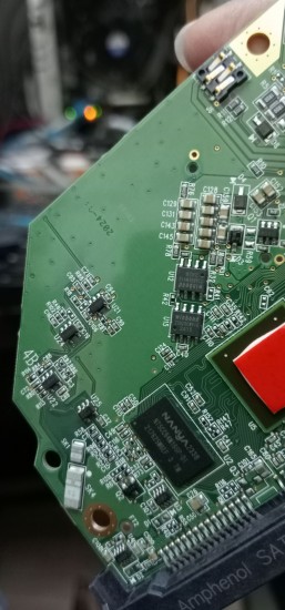

I have died 2tb hdd wd, but i don't know which rom location of the pcb. Can u help me!!
 Post subject: Re: Need help rom Wd2003fzex
PostPosted: December 26th, 2024, 20:04
Posts: 17335
If you can dump U12 and U15, I'll analyse them for you.

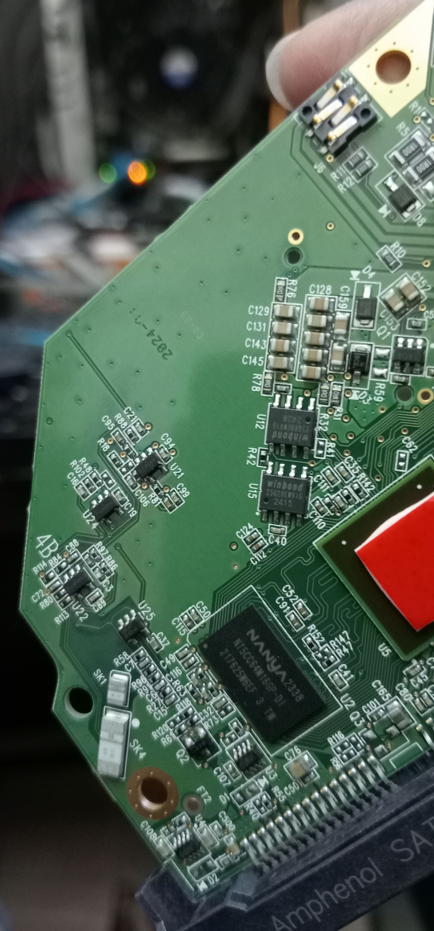

PostPosted: December 26th, 2024, 21:33
Posts: 17335
Your PCB has two e-fuses. If you can upload a detailed, clear photo, I can show you the test points.

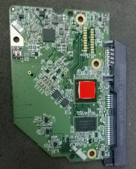

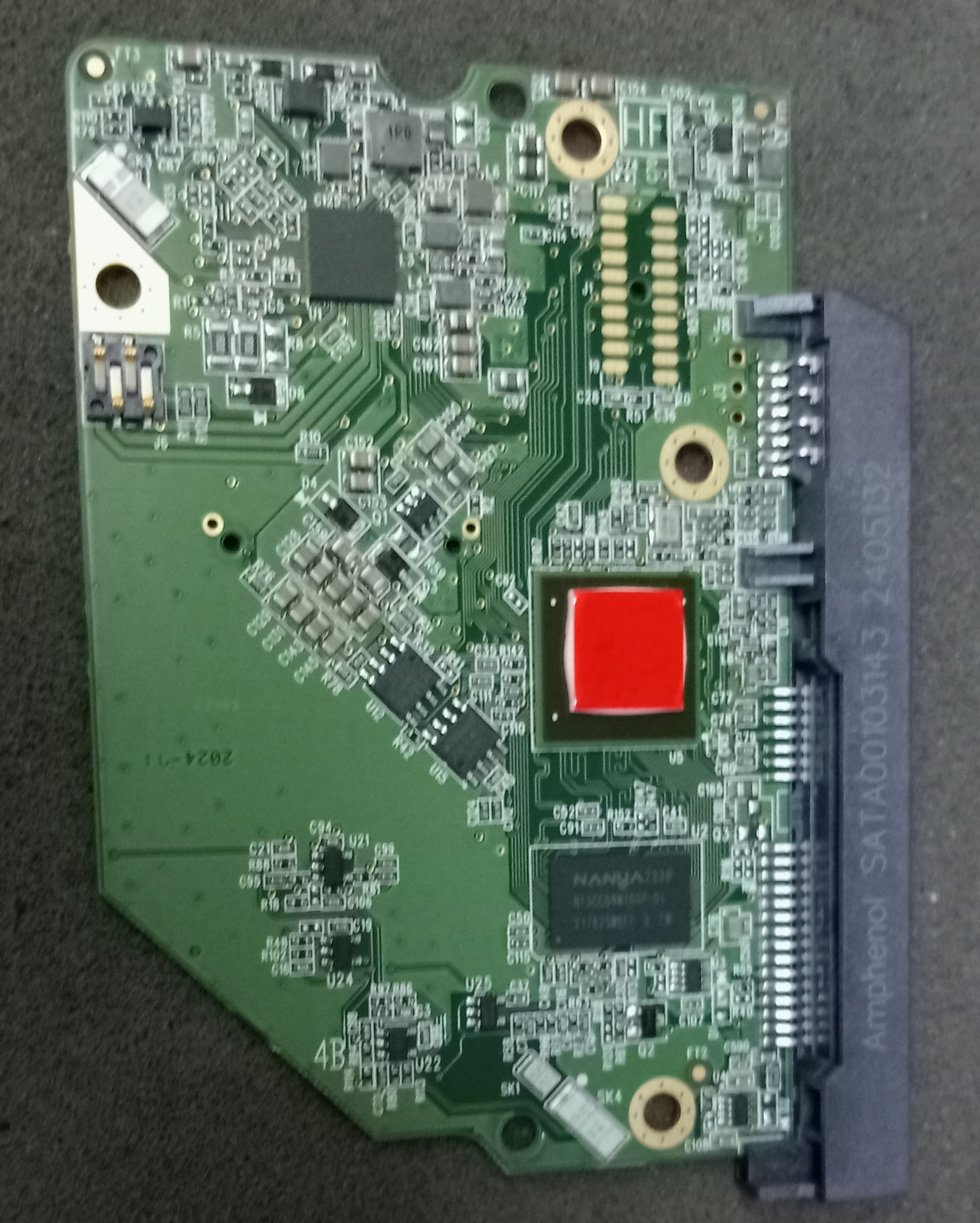

PostPosted: December 26th, 2024, 22:01
Joined: July 29th, 2005, 3:29
Posts: 32
Location: Indonesia
PostPosted: December 26th, 2024, 22:26
Posts: 17335
Measure the input and output voltages of U3 and U4.
U3 = MP5013EGJ
MP5013EGJ, Monolithic Power, Programmable Current-Limit Switch with Over-Voltage Clamp and Slew Rate Control, 3V - 5.5Vin, 2A, 22V max, marking AWBy, TSOT23-8:
https://www.monolithicpower.com/en/documentview/productdocument/index/version/2/document_type/Datasheet/lang/en/sku/MP5013E/
U4 is equivalent to MP5014A ?
Monolithic Power, 12V, 5A, Programmable Current Limit Switch with Over-Voltage Clamp and Slew Rate Control, marking ARPy (MP5014A = AMJy), TSOT23-8:
https://www.monolithicpower.com/en/documentview/productdocument/index/version/2/document_type/Datasheet/lang/en/sku/MP5014A/document_id/1694/
