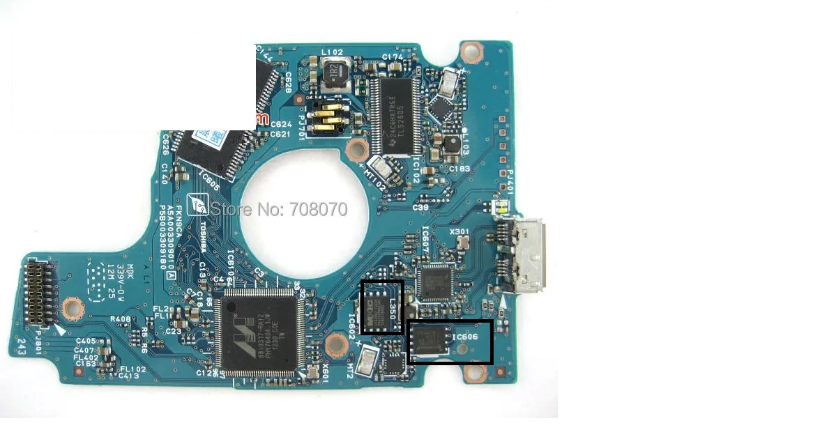

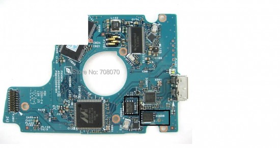

Doubt - There are 2 rom chips on USB board ( G003309A) IC 606 (WINBOND ) & IC602 ( 25 NO.)
Tried ic 606 on Donar sata board but no bsy , no spin
Tried ic 602 on Donar sata board but bsy signal , no spin
Which rom is correct & why no spin ? No problem in Soldering rom .

One ROM is connected to the MCU, the other to the bridge. Obviously, when you switch to a SATA PCB, you would use the ROM that is connected to the MCU. That's because the SATA PCB has no bridge ...
Show us photos of your patient and donor PCBs.
Can you upload a ROM dump? Perhaps it is corrupt.

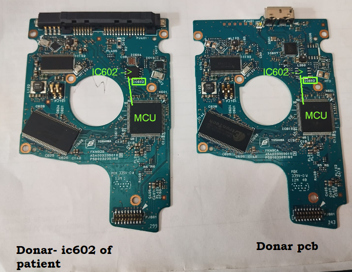

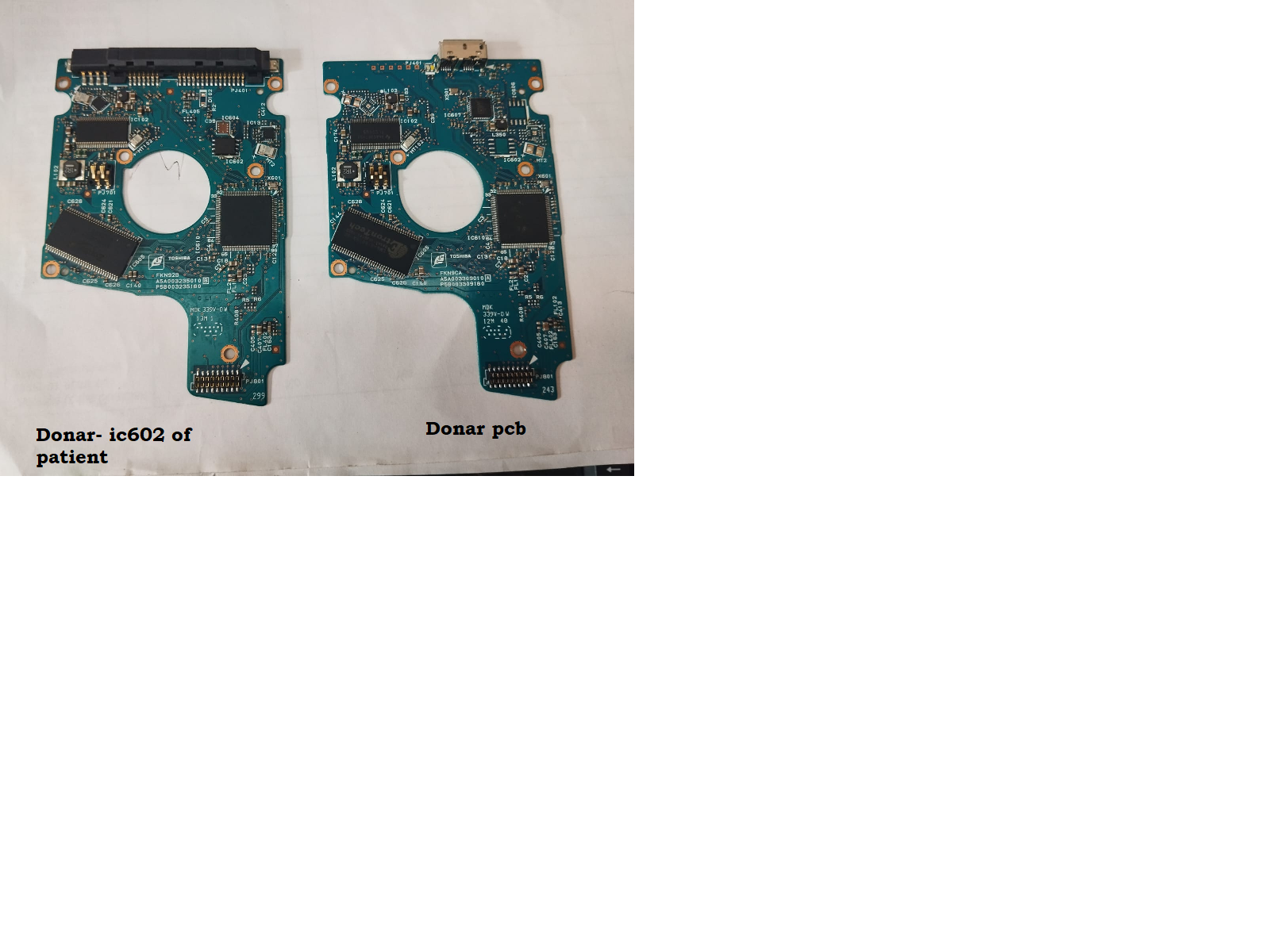

Please see pic
IC602 OR IC606 ROM IC ?
when I placed IC 602 ON Donar pcb , I get BSY ERROR ON PC3K , no spin
when I placed IC 606 ON Donar pcb , NO signal ON PC3K , no spin
Warm Regards,
ALex

IC602.
Donor board must have same MCU and motor controller.

alexpeter wrote:
Please see pic
On your SATA PCB, do you see IC602 or IC606?
Please use some common sense.

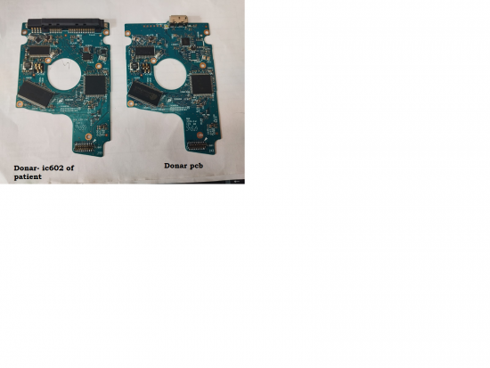

Tried Donar PCB with patient ROM on another Toshiba drive , still no Spin
only BSY error . Rom content might be ok but patient MCU & controller not matching
as per PEPE
 Post subject: Re: Toshiba MQ01UBB200 USB TO SATA
PostPosted: January 29th, 2025, 8:50
Posts: 4854
we can't see nothing on that image, neither the part numbers on the MCU nor PN of the motor controller. please post high res pic where IC markings are visible.

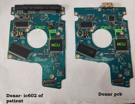

alexpeter wrote:
Sorry
"On your SATA PCB, do you see IC602 or IC606?
Please use some common sense."
It is patient board USB . not Donar Sata pcb.
Regards,
Alex
Mate, have you heard of cropping?
