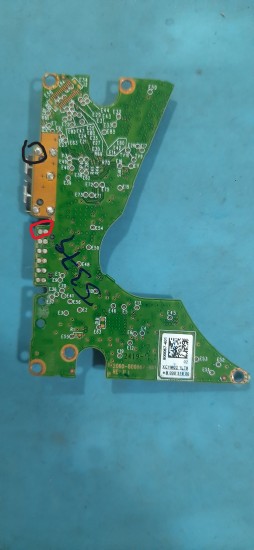

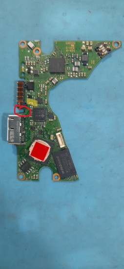

Hi every one and hello fzabkar sir kindly help me fix the pcb its 800067 2TB WD Charger problem is no power at all i have posted the pcb pic pls help

check the component marked with 'S', it should be shorted (fuse) and the diodes near it, they should not be shorted.

Component marked with S is short and near diodes are not

as a next step, measure voltages on 'S' and the inductors near the motor controller while supplying power through the usb connector and post results

I assume you've checked TVS diode and the fuse?
Looks like the power trace is cracked. Circled on the top down view.
Try to solder power to the point I circled in red on the back side view, ground to the black circled spot.
If the board is not cracked, the fuse marked S I've highlighted, sometimes those have cold solder joints, I've managed to fix a few of these boards by just putting some flux and hitting that fuse with hot air to reflow it.
