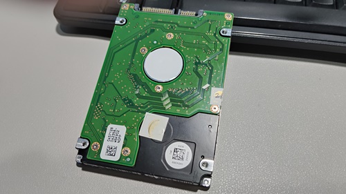

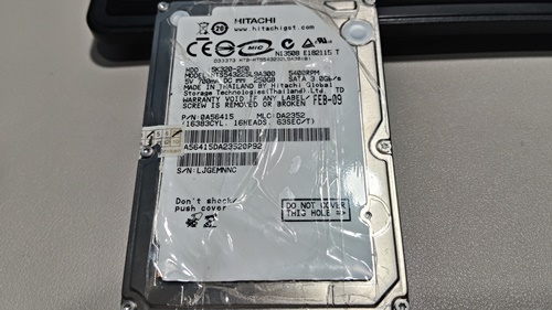

I got HTS545032B9A300 2.5" SATA HDD Hitachi, spin down. It spin in the first time and spindle down.
I can't access to SA. Anyway to short pins? Any short pins information?
Or it may other way.
Thank you.

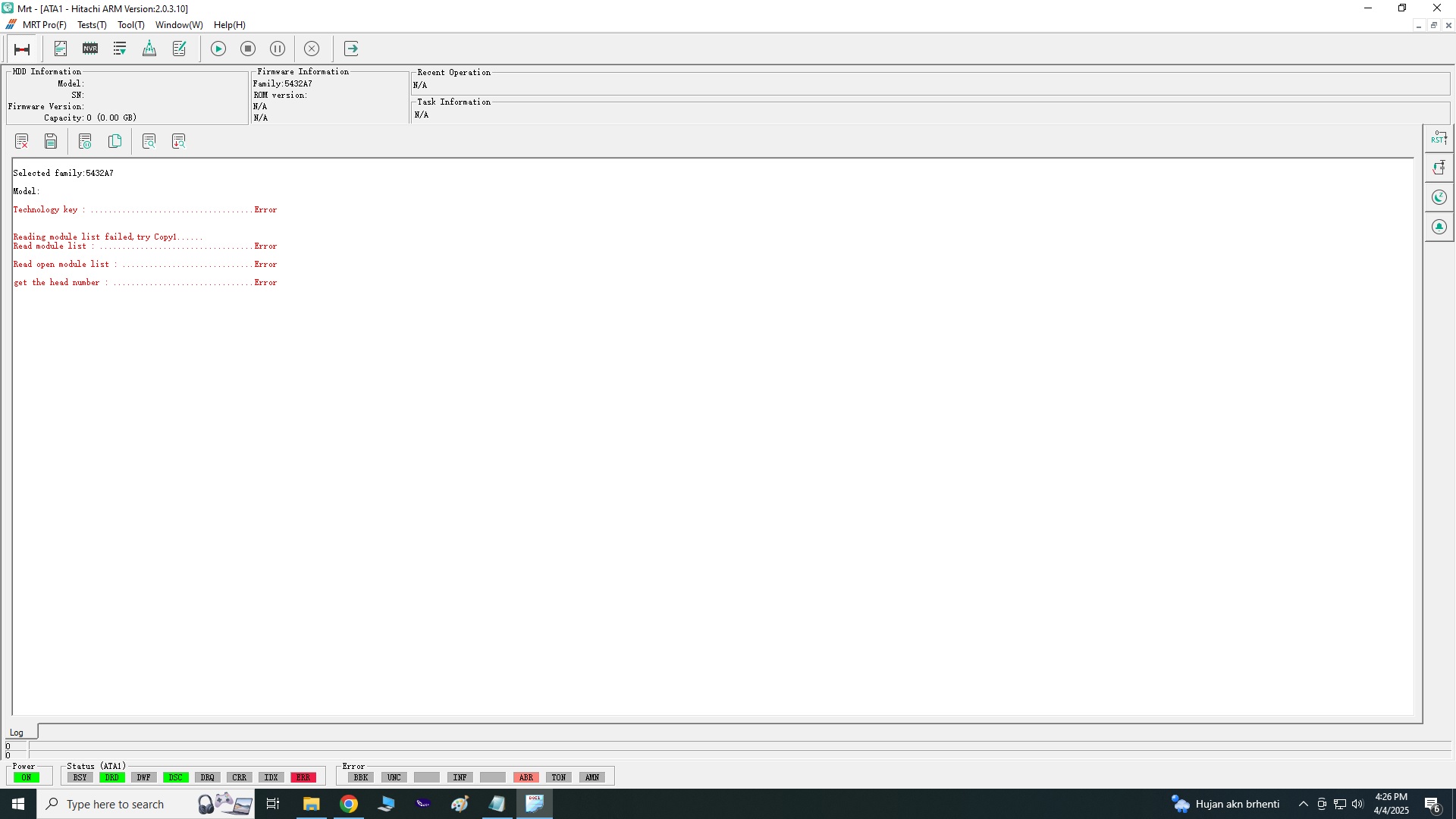

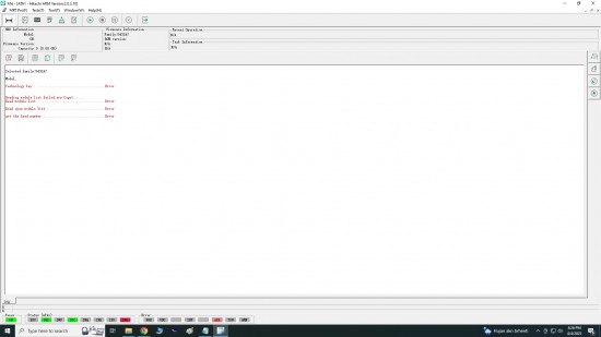

Currently no more spin down, it is READY, but having error when access to SA.
No ID detection yet.
As you wrote above, I thought the spindle motor does not spinning. So does it rotating or not?
If heads are changed, spindle motor continues to spinning, and no clicking sound, then I would check the NV-RAM version first. It may be an alien PCB & ROM. Check the NV-RAM version in the ROM and version at the HDA label.
 Post subject: Re: HTS545032B9A300 2.5" SATA HDD Hitachi, spin down
PostPosted: April 4th, 2025, 6:33
Joined: January 20th, 2021, 0:27
Posts: 110
Location: Indonesia
Hi aekhv,
Spindle is spinning and keep spinning after head replacement.
Head is moving, I heard one click, no clicking.
When selecting ID, drive READY with ERROR and ABR.
Let me check the NV-RAM version in the ROM... compare to the label.
Who knows wrong PCB.
Thank you.

According to shield warranty stickers on HDD and PCB, it is originally unopened.
Anyway I will check ROM.
