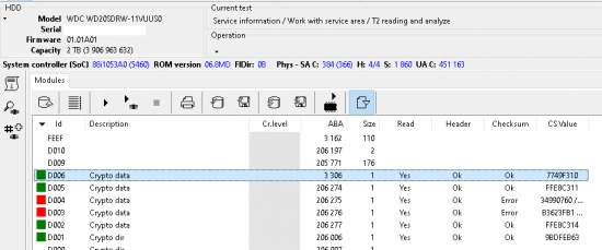

Charger drive came in, MOD190 was not readable. Noted issues with H1.
- Read ROM, did unlock.
- Using the native USB PCB, I removed the caps and crystal. PC3000 now talking to the drive using SATA.
- Replaced the heads, drive now reads.
- Block UA and started FW backup.
( there is no UA access via ATA at this point). Reading UA by Utility shows encrypted data.
- SEDv2 enabled in 02.

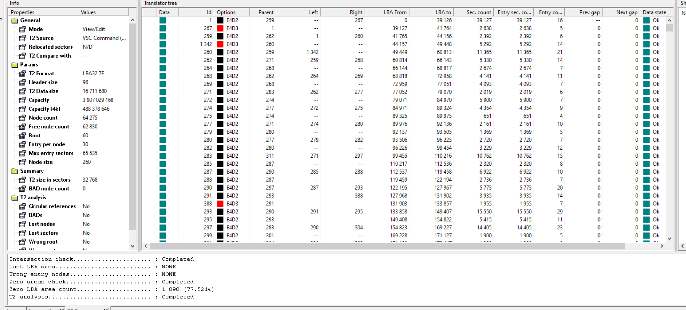

- PC3000 shows no issues with T2.
- Reviewed what FW modules were read and the following were read, but have CRC errors.
24
123
124
126
D003 <- "Crypto Data"
D004 <- "Crypto Data"

Those CRC errors are normal:
https://groups.google.com/g/datarecoverycertification/c/jcma8ZYbnVs/m/RRnVvSwtBAAJ
In future you could avoid removing the crystal. Instead, you could ground the reset pin.

i can't see why would it be normal for D00x mods to have bad CS. check content . Also, what error is posted uppon UA access?

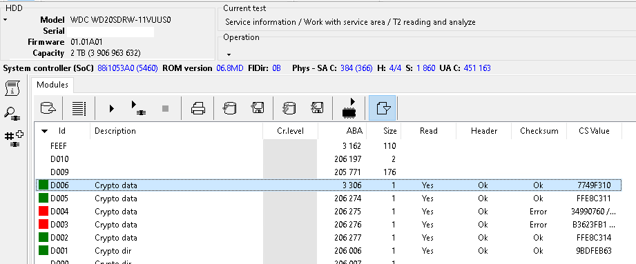

Thank you both for your posts. I've read the ground pin documentation you provided and will use that going forward.
Pepe, I get ABR when reading via ATA and if I use terminal (HDD translates) I get encrypted data.

sorry, i meant the extended error code.

Can u upload your full SAbackup?
