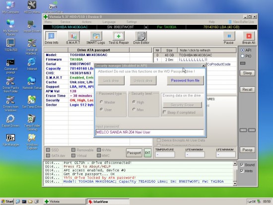

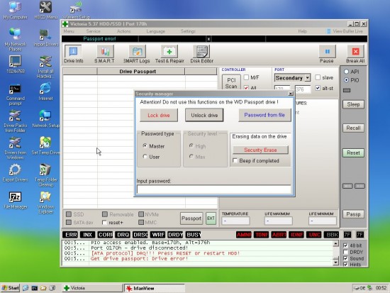

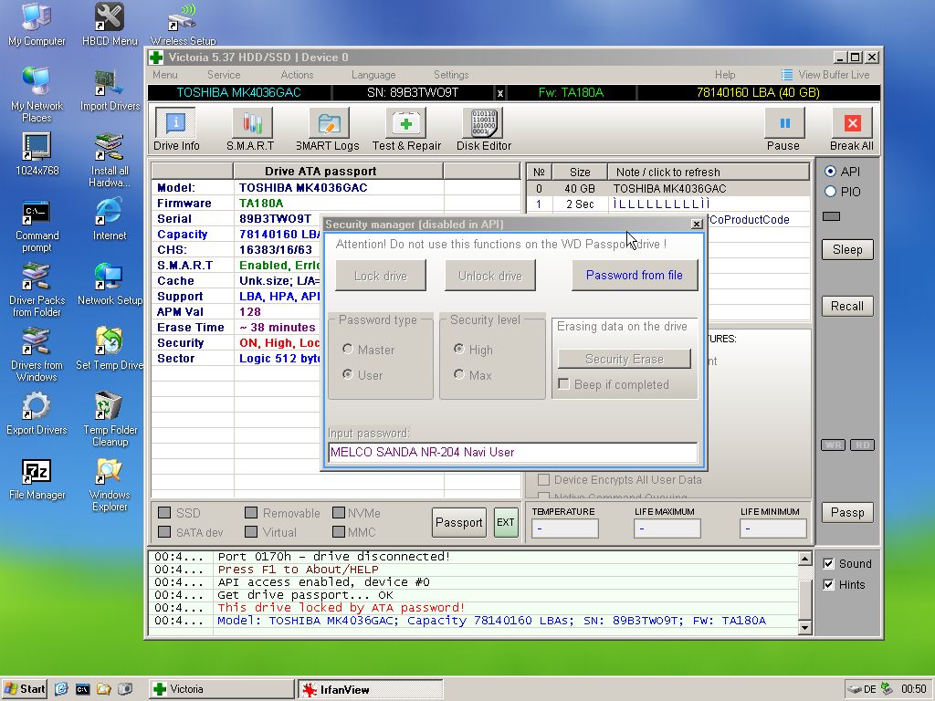

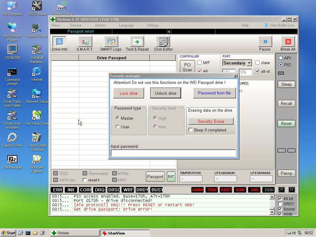

I'm trying to unlock a Toshiba drive which is password locked with several tools..
one is victoria which i've tried but no success ..
There are Messages i can't identify !..
Can someone help me to unlock this hdd ?
it is a PATA 2,5" HDD...
it is recognized in Victoria but if i try to unlock it with the known password zhe "security" option is disabled in API-Mode
how could i enable this or when will this be enabled in Api Mode ???
if i try to unlock in PIO Mode i got an error Message "[ATA Protocol] DRQ!!! press RESET or restart HDD"
Don't know what means "DRQ!!!" ????
can someone help me and give me hints ... Thank you

You could simply try ZU It can clear the password and keep the data intact. This utility is zu.betta.050911.rar located on this forum in the downloads section. There will be many posts on how to use it.

 Post subject: Re: Regarding the scan menu in Victoria
PostPosted: November 26th, 2025, 15:04
Posts: 17342
You can get ZU here:
https://www.hddoracle.com/viewtopic.php?f=95&t=166&p=334#p334
You need Firefox to access the site (because of ongoing DDOS attack mitigation).
