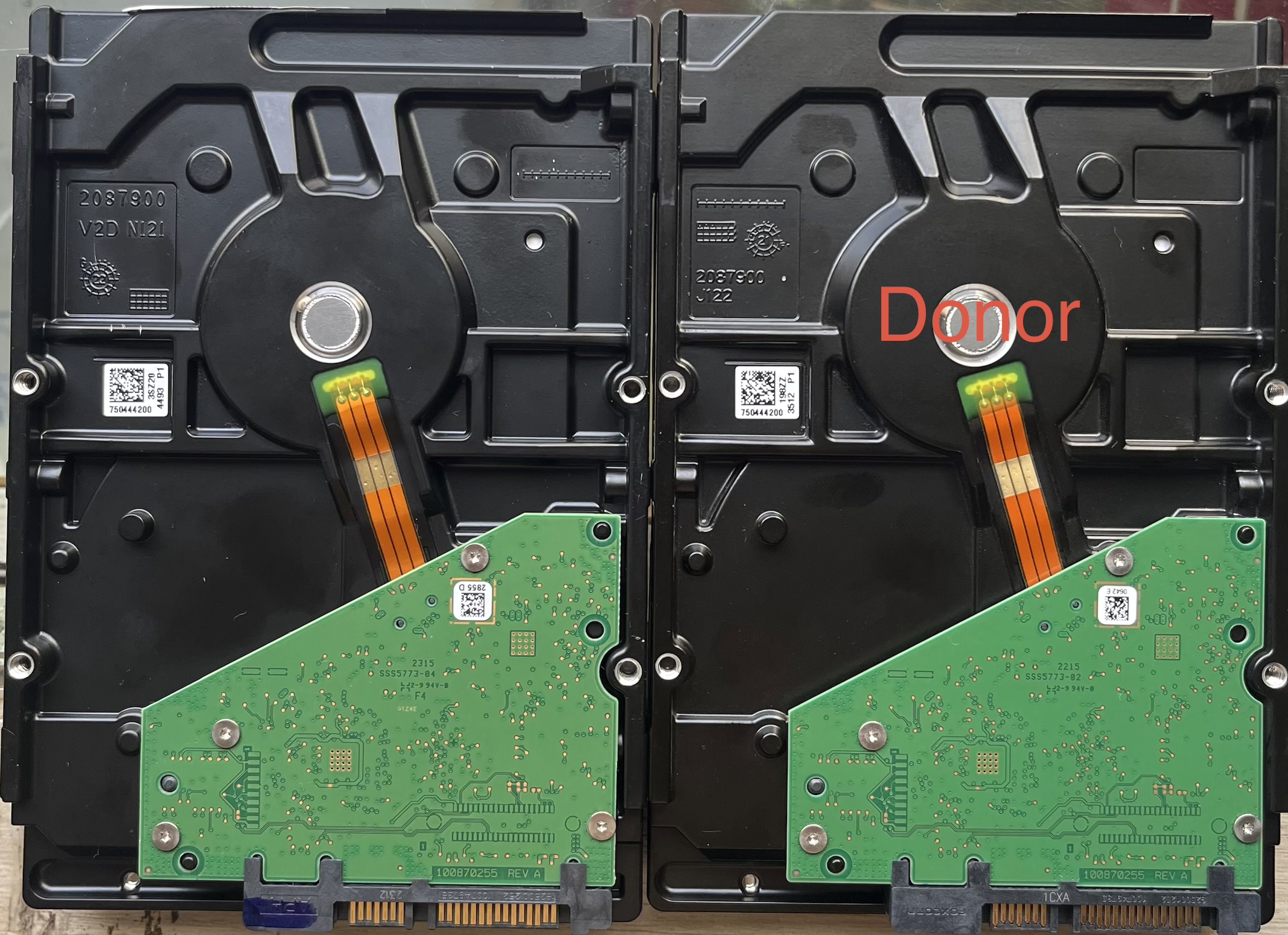

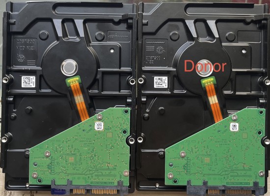

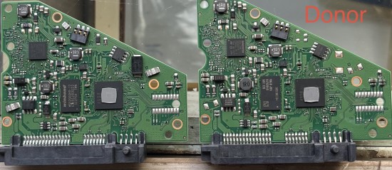

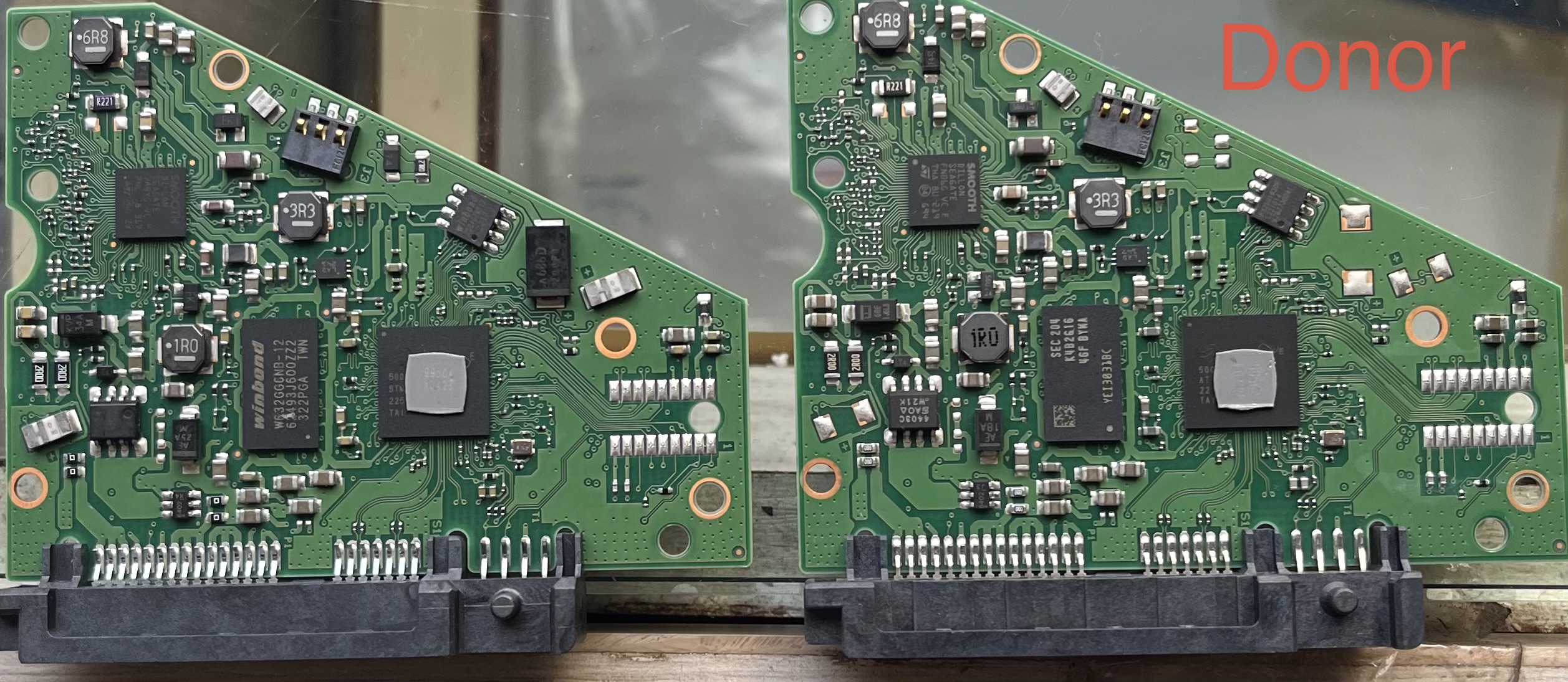

Hi to all !
These are different models that use the same PCB numbering system, with some physical differences.
Please look. Is pcb photos compatibles? Is it possible to change the ROM? rom and mcu?
Нет ничего невозможного
ICBW, but I think you could just transfer the patient's adaptives to the donor ROM, provided that the firmware versions are matched.

They are from different fws.
Thanks reply!
Sorry
Patiente fw SC60 (IronWolf) 4 TB
Donor fw 0001 (BarraCuda) 4 TB

sempre wrote:
Thanks reply!
Sorry
MCU = Patiente

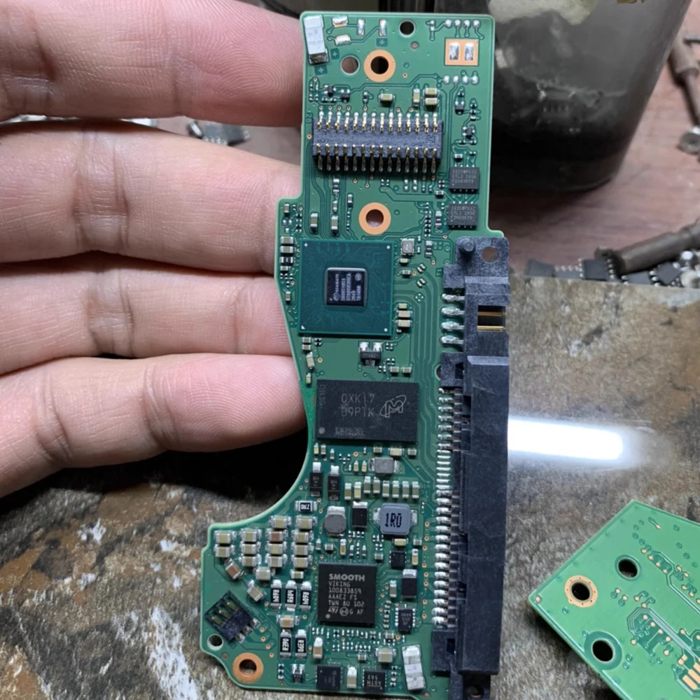

 Post subject: Re: Seagate IronWolf Pro 18TB ST18000NT001 Water Damage
PostPosted: January 23rd, 2026, 8:58
Posts: 347
Location: Eastern Europe
SMOOTH different... It's hard to see.
The Si4403CDY looks tired or uncleaned.

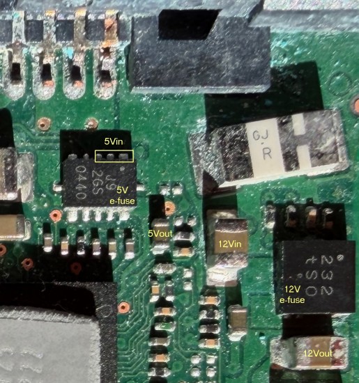

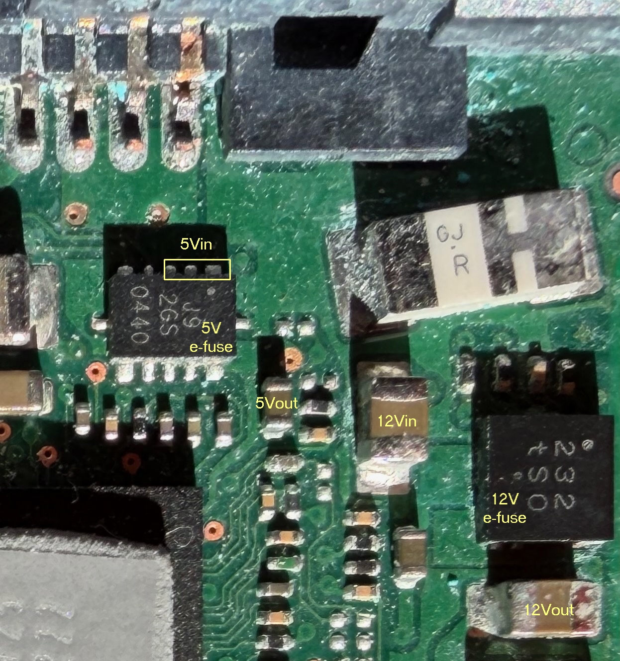

Measure the resistances between ground (any screw hole) and each of 5Vin, 5Vout, 12Vin, 12Vout. These are the inputs and outputs of each e-fuse.
If there are no shorts, power up the PCB on its own and measure 5Vout and 12Vout.
NIS5232, ON Semiconductor, electronic fuse, 12V, 4.2A, marking 232, DFN10:
https://www.onsemi.com/pdf/datasheet/nis5232-d.pdf
I think I have identified the test points correctly, but I could be wrong.
5V e-fuse or current limited load switch, Seagate Exos, marking J9, QFN-12, equivalent to MP5018:
https://www.monolithicpower.com/en/documentview/productdocument/index/version/2/document_type/Datasheet/lang/en/sku/MP5018/
https://preview.redd.it/sq8hsfgzf3ye1.png?width=1080&format=png&auto=webp&s=67fd1383781388af42ea3d2157497ae8083c8d40

Thank you for the suggestion! I tried measuring them all against a good board and as far as I can tell, I'm getting the same output on all of those locations.

Do you mean that you are measuring 5V and 12V at the outputs of the respective e-fuses in all of your drives?
Is there any possibility that the drives have been configured to Power Up In Standby (PUIS)? Did all of your drives originally power up at the same time in your NAS?

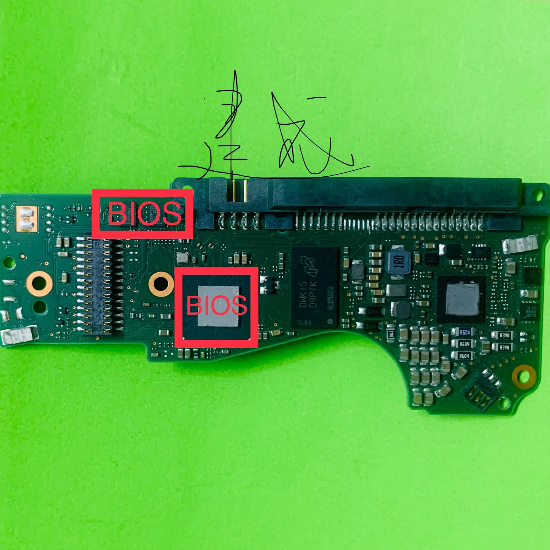

Water damaged laptops v hard disks. The logic board on hard disks is smaller but who documents them at all. Laptops are poorly documented but chip markings are usually helpful. Hard disks I own tend to be more arcane.
High resolution images of the logic board are useful for identifying parts. Parts catalogs are helpful as some common laptop faults are the same MOSFET all over the place. MOSFET chips are 8-pin and checking then can help trace power faults. These typically are 8-pin with inputs and outputs but one pin is the switch control line. Hard disks usually have one while laptops may have a dozen.
A multimeter can find shorts and open circuits. A voltage injector can hep find shorts. Check for cracked caps and resistors that seem damaged. A lot of checking is needed to fix anything.
An infrared camera can help spot shorts but these are more expensive. The idea is that shorted logic will be hot making it easier to spot. Alcohol swabs can help as hot parts evaporate dry faster than cold parts.
Sorry, if I didn't explain that well. I didn't mean same reading at all times. I meant, when I measured resistances from a known good board and measured a bad board, I got the same reading. Same thing when I measured voltages when powered up, bad board had the same reading as the good board voltages.

Check resistance both ways as diodes etc may be damaged.
Capacitors that are cracked usually are low to very low resistance.
Resistors are usually obviously damaged.
The BIOS chip is usually serial based but there are chip readers that can read them but trying a different ROM may not work due to the self encrypting feature.
